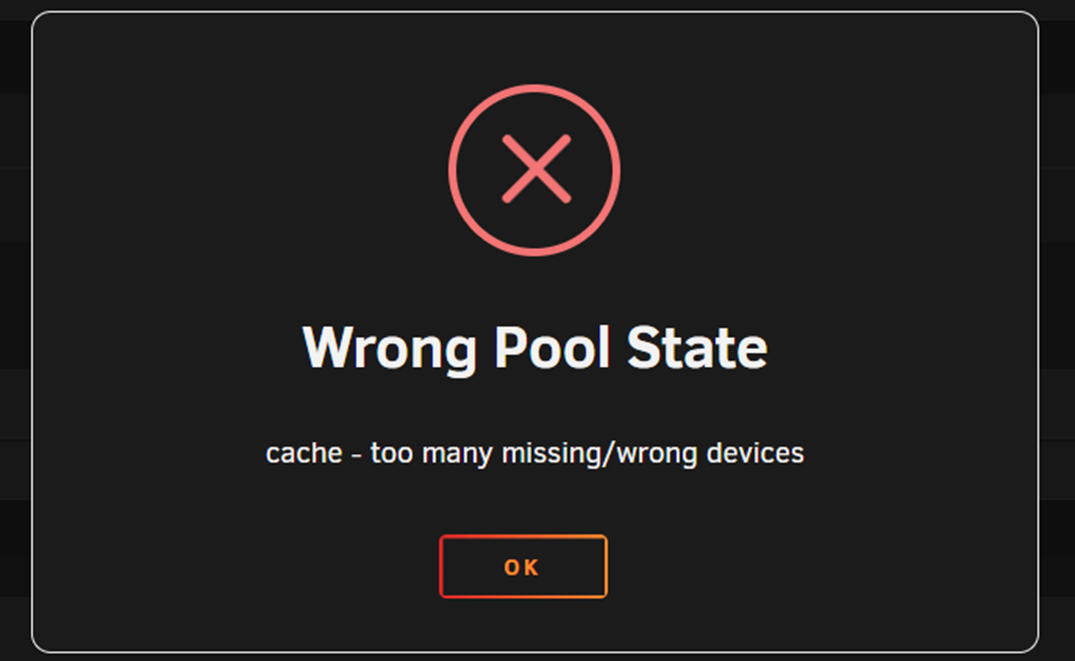

Cannot Start Array - "Wrong Pool State - Cache - Too many missing/wrong disks"
Hey all -
Came home, and server was offline. Seemed hung, rebooted. Attempted to start the array and it seems disk 7 maybe failed? Getting the error above when attempting to start the array.
Read elsewhere that I should potentally erase the bad disk, then reassing into the array? I've added the diagnostics. Appreciate any pointers.!

The error is about the cache pool, not the array, was there supposed to be another cache device? Post the output of:

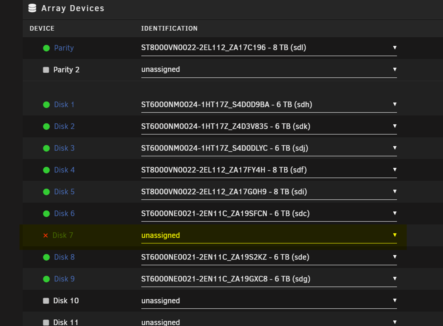

Should there be a disk7?    Currently the array is unprotected as you have single parity and a missing disk7.
Yes! I believe disk 7 failed recently - Is it ok to 'erase' it, then readd it to the array, and start? Should that be my first move, or should i work on rebuilding the cache/parity drive next?

FYI when I set disk 7 to unassigned, and attempted to start the pool I ended up with the same initial error.
That wasn't what you were told to do, but now that you have unassigned disk7, leave it unassigned.

Emulated disk7 mounted so you can rebuild, you removed one of the pool devices making it a single device pool, was that your intention?

I'm running through that process, however at step 3 "Start the array" I have no ability to  do it as i get the error  "wrong pool state".  I just want to be sure i'm making the correct changes before moving forward as I dont want to cause any more issues. If anyone is open to helping me today via discord, I'd happy reimburse you for your time. PM me here if you want to connect.
Unassign all pool devices and you should be able to start the array, may need to check the "I'm sure" box, rebuild the disk first then we will deal with the pool.
