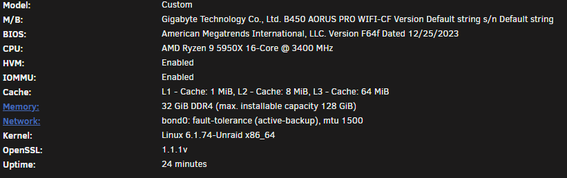

My system specs are:
R9 5950x,
RX 6800XT (pcie slot 1)
GTX 1050ti (pcie slot 2)
Gigabyte B450 AORUS PRO WIFI,
I am able to spin up a VM when using noVNC, no problem; I can get into windows. HMV and IOMMU is enabled.

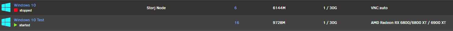

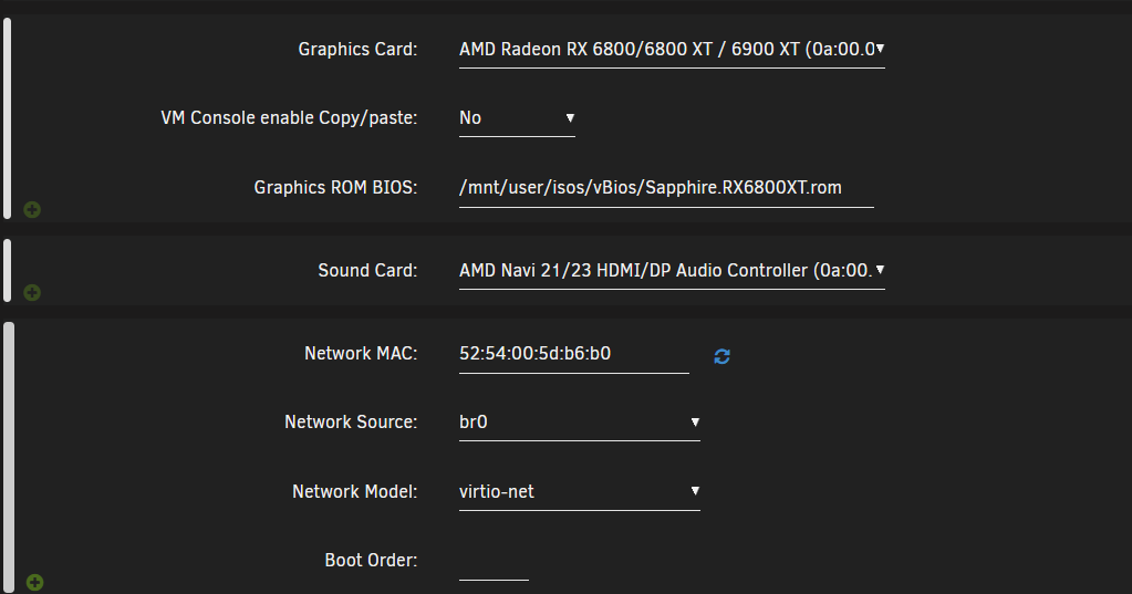

What baffles me is Im able to boot into the Windows VM when I passthrough the card, I can see on the unraid dashboard that the card is though put is enabled.

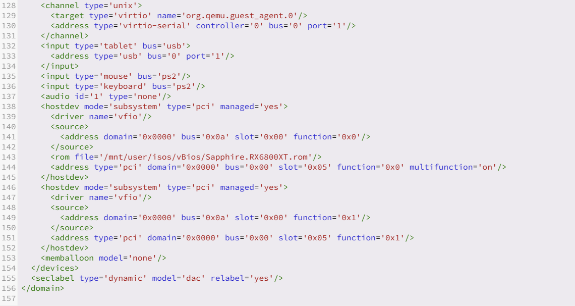

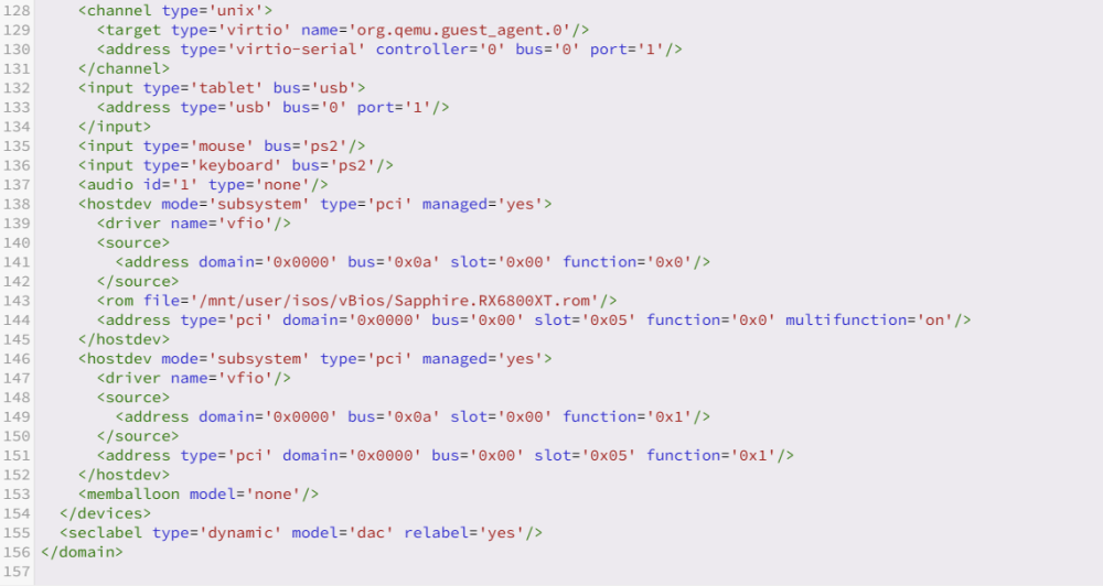

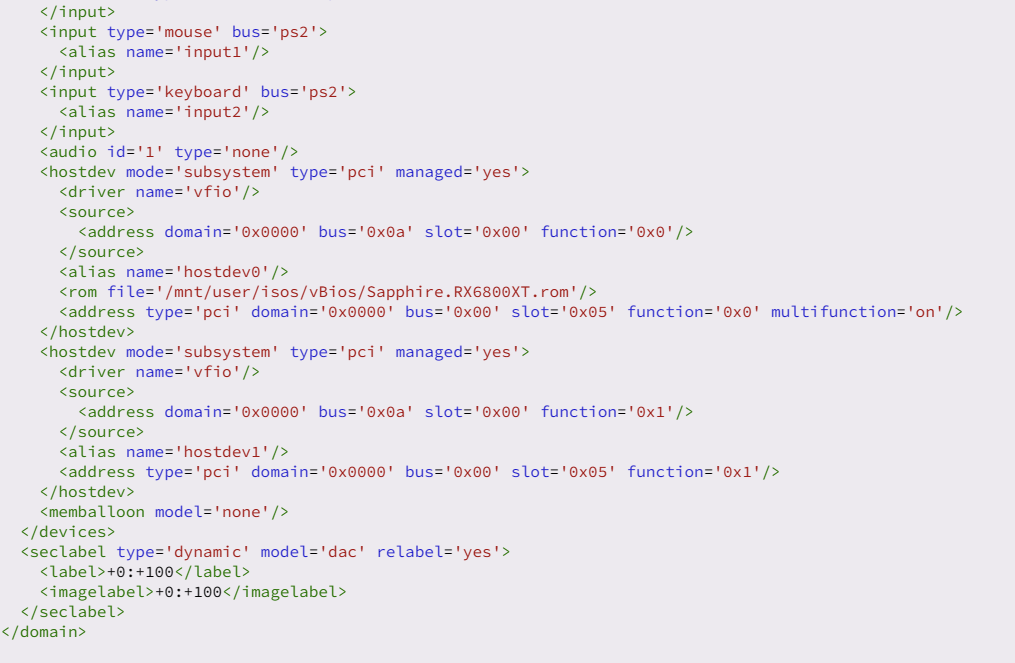

In the XPM config file, same thing, I configured the GPU with its auto and video device on the same bus and enabled multifunction on the card.
      <driver name='vfio'/>
      <source>
        <address domain='0x0000' bus='0x0a' slot='0x00' function='0x0'/>
      </source>
      <alias name='hostdev0'/>
      <address type='pci' domain='0x0000' bus='0x04' slot='0x00' function='0x0' multifunction='on'/>
    </hostdev>
      <source>
        <address domain='0x0000' bus='0x0a' slot='0x00' function='0x1'/>
      </source>
      <alias name='hostdev1'/>
      <address type='pci' domain='0x0000' bus='0x04' slot='0x00' function='0x1'/>
    </hostdev>
    <memballoon model='none'/>
  </devices>
  <seclabel type='dynamic' model='dac' relabel='yes'>

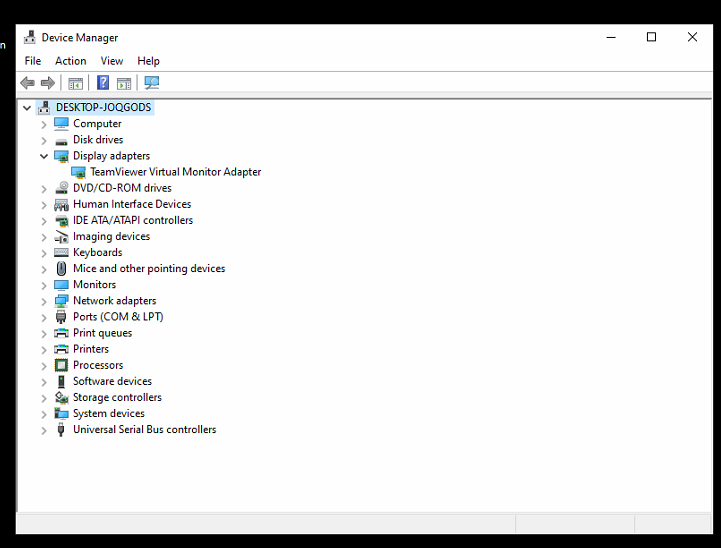

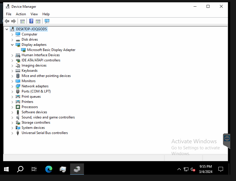

And to put the cherry on the top of this confusion cake, I'm able to boot into the windows VM, no errors are being thrown at me when I start the VM and remote into it with TeamViewer. But, when I open the VM device manger, the GPU is suspectedly missing.

I attempted to pass though my GTX 1050TI and the issue is the same as the 6800xt. I can set the passthrough in the unraid VM configurator template, boot up the VM, and see in the VM that no GPU is being passed through. I suspect I have a general configuration error, rather then a GPU issue.

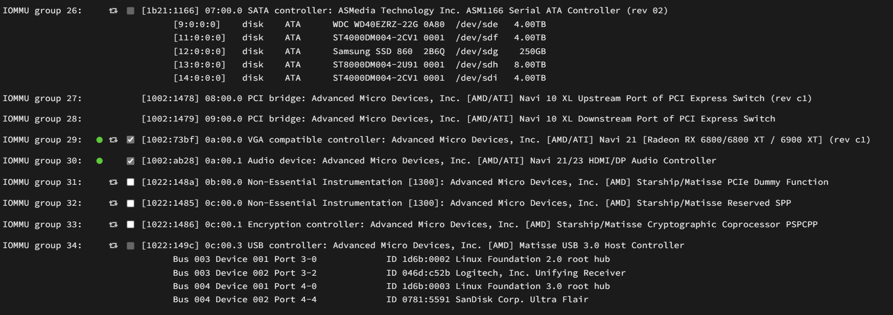

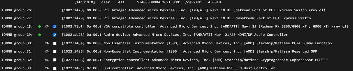

I setup the Card to be used in the VM, its bound at boot, all VM and PCIE passthrough settings are enabled and still no dice. Please let me know if you have any thoughts; I am out of ideas.

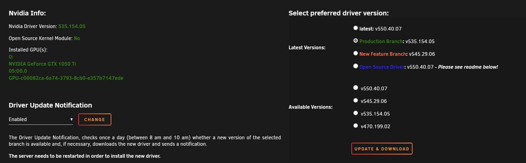

Okay, we're making progress. I found part of the solution by trail by fire.
I found that because I have an Nvidia and AMD GPU in the same system, I was getting a strange driver error.  Before I had "Latest" pre-selected as my branch. After changing it to production, the card shows up in Unraid, but with the error 43. Can you recommend how to fix this issue? Thanks.
