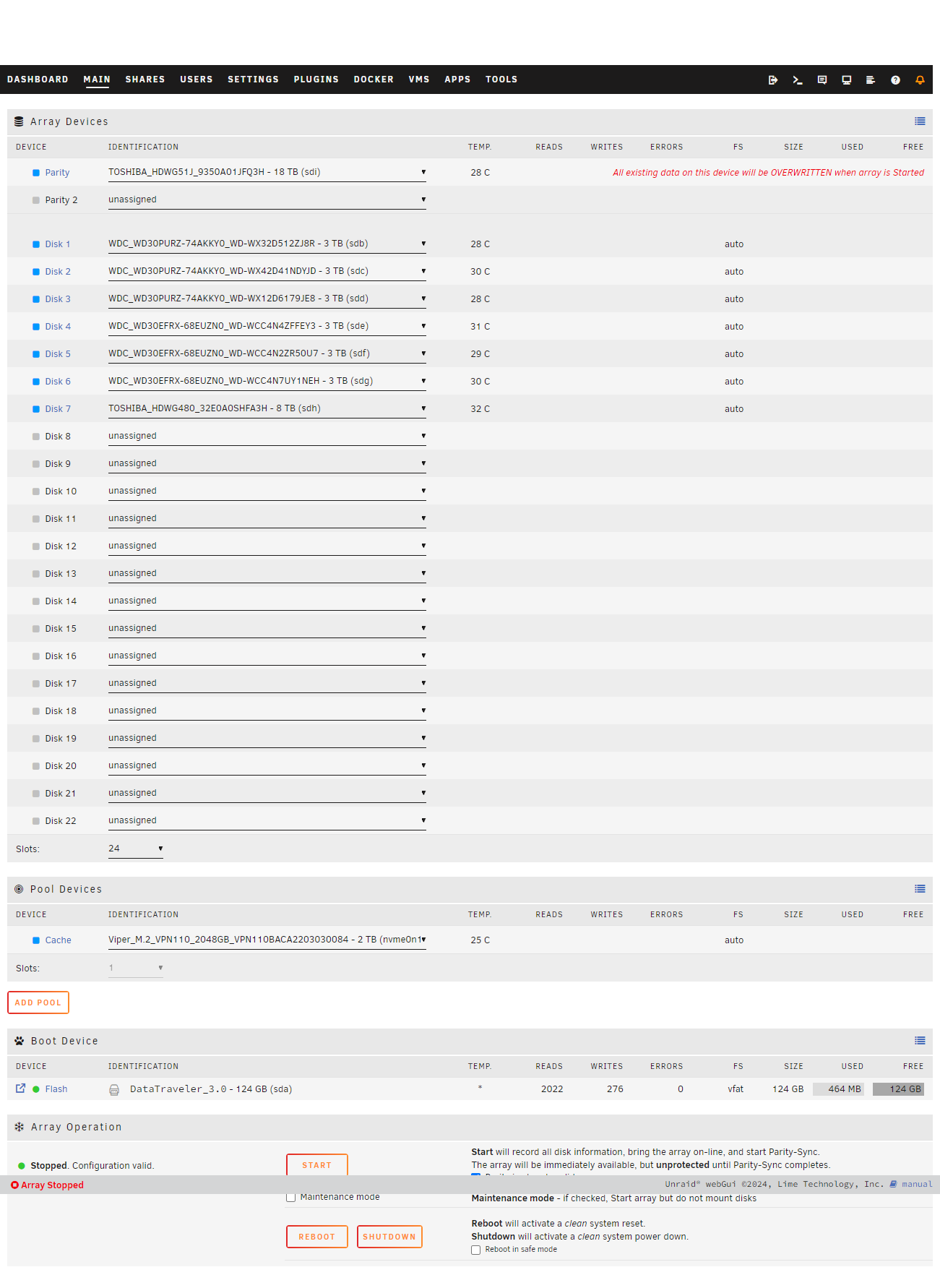

Hello, i am actually here, and the message :
All existing data on this device will be OVERWRITTEN when array is Started
DO i have to be afraid ? because i have error with some disks too at the boot

I post the photo before touch anything (do i have to say the parity is already valid ?)
I believe you can proceed.  Here is how I understand that image.  With the parity sorted out and the array disks assigned even in a different order, what will be overwritten is the parity drive only.  The data on Disks 1-7 will remain intact.
I understand your angst so in your shoes, I would wait for one of the pros to swing by and give a final look at it.
edited cause it read funny.
Edited by Veah
You might want to play safe and initially start the array without assigning a parity drive.   That way you definitely cannot have an accident.
