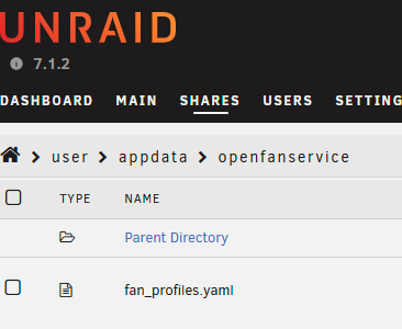

For your containers you aren't using the usual appdata subfolder?

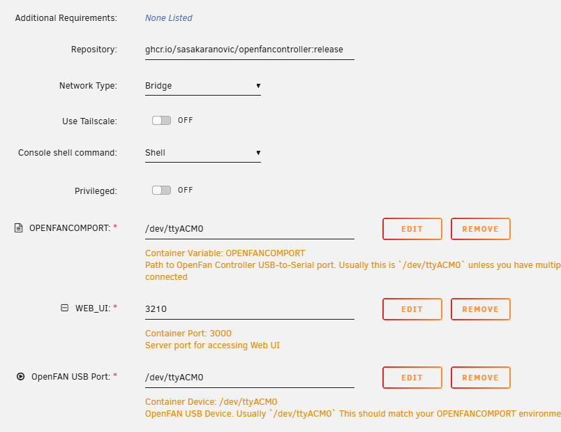

  • JayBee_Unraid
    JayBee_Unraid
    That was it! I just needed to switch it to host. Thanks for figuring that out. No, that address is the one used my unRaid server, you can see it in the screenshot. No problem with the port either. It

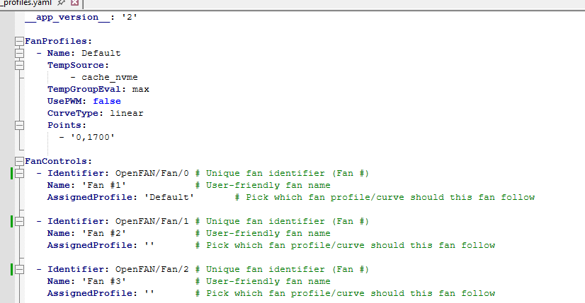

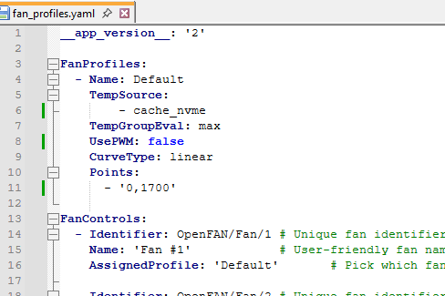

On 1/18/2025 at 7:24 PM, Gingersnap155 said:

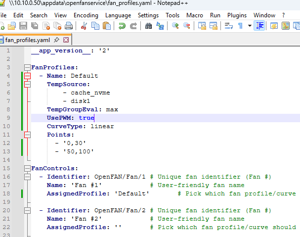

Ok so I switch to using a JSON and adjusted the docker run command accordingly. Now it works fine.  It’s possible I messed up something with my docker run command with a typo and that was the problem. Either way it works perfectly fine now. And I can even edit it in notepad++ and save and it will adjust on the fly.
What exactly did you change? I am having the same 'error parsing json file/error: expecting value' issues as other. I have swapped some stuff .json  and .yaml stuff around, but I have no experiance with anything beyond very basic stuff with dockers, so I really have almost no idea what to do. Very frustrating. The controller seems to be working fine, but i cant figuure out the service.
The latest image version for the docker isn't up to date at all, I guess the dev forgot to update it from his own source code. It means yaml support isn't present at all in the docker, so no matter what it won't work.
To make a json it's simple, just create an yaml file then use a yaml to json converter, then change the docker installation to replace every reference of the yaml file by the json file.
Alternatively you can get a sample json file from here and modify it the way you want.
Also both documentation and samples are incorrect, as fans are counted from 0 not 1, you need to change that if you want it to control the proper fan.
Edited by JayBee_Unraid
That worked, thankyou very much.

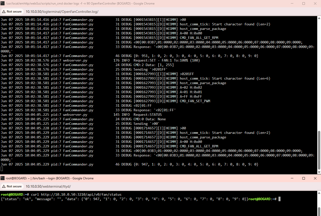

Now, when no profile is assigned to a fan, it starts. when I add a profile to any fan, I get this error:

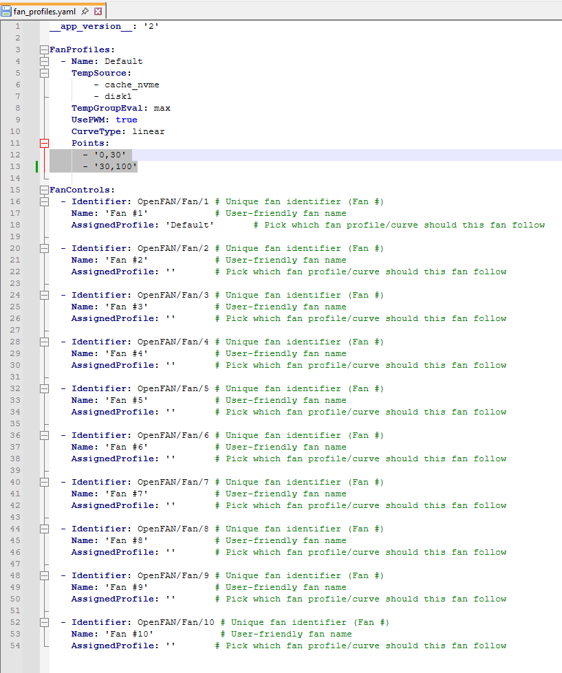

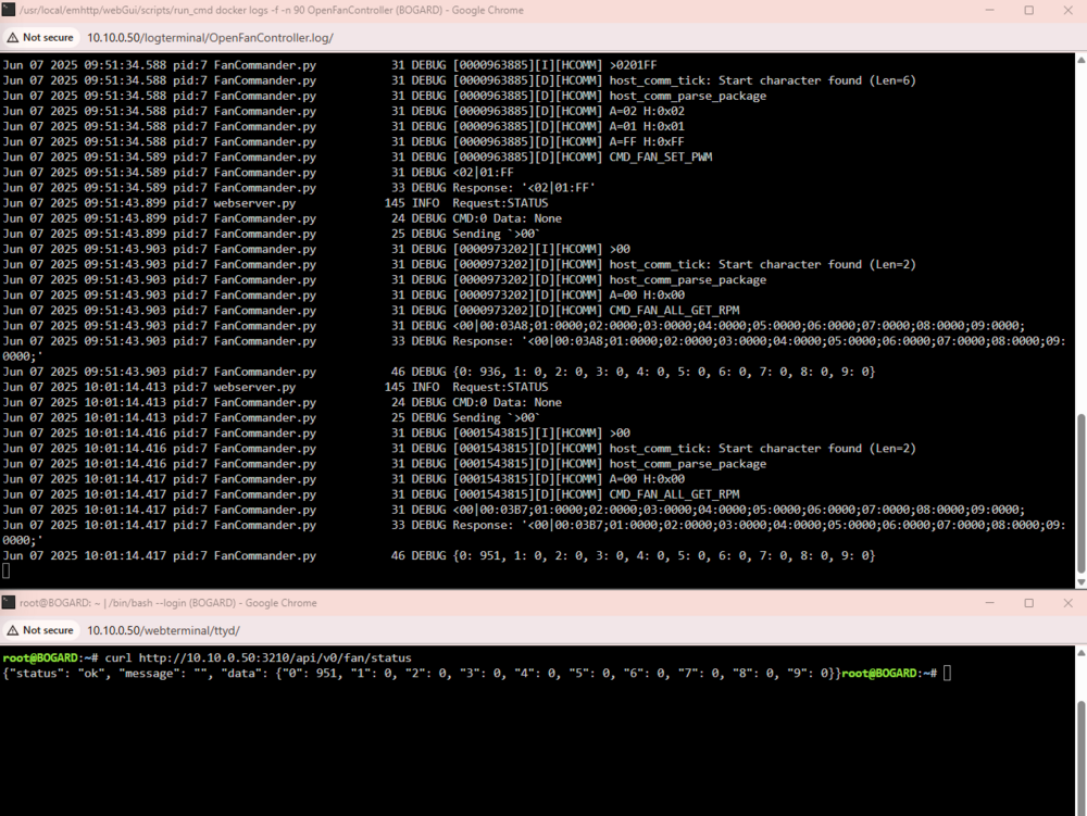

please share the content of your json, add it to your comment as a code snippet.

And yeah the YAML file does work now.

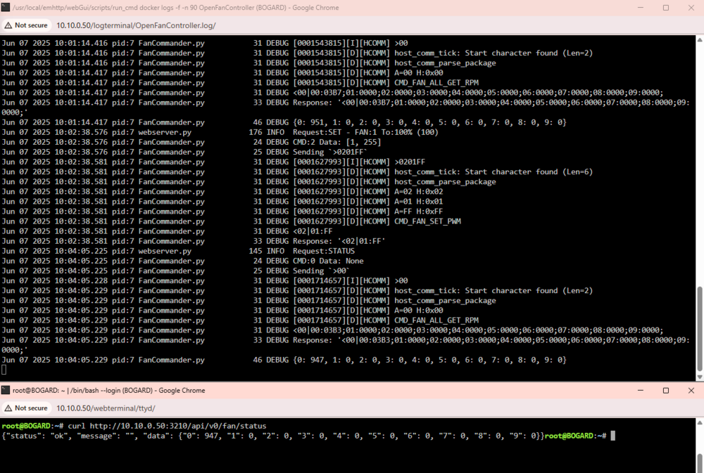

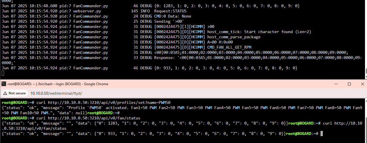

UPDATE: This was solved here: https://forums.unraid.net/topic/155377-support-sasakaranovic-openfan-controller/page/3/#findComment-1559891

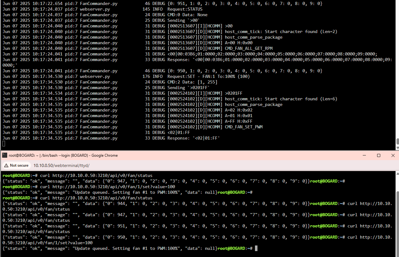

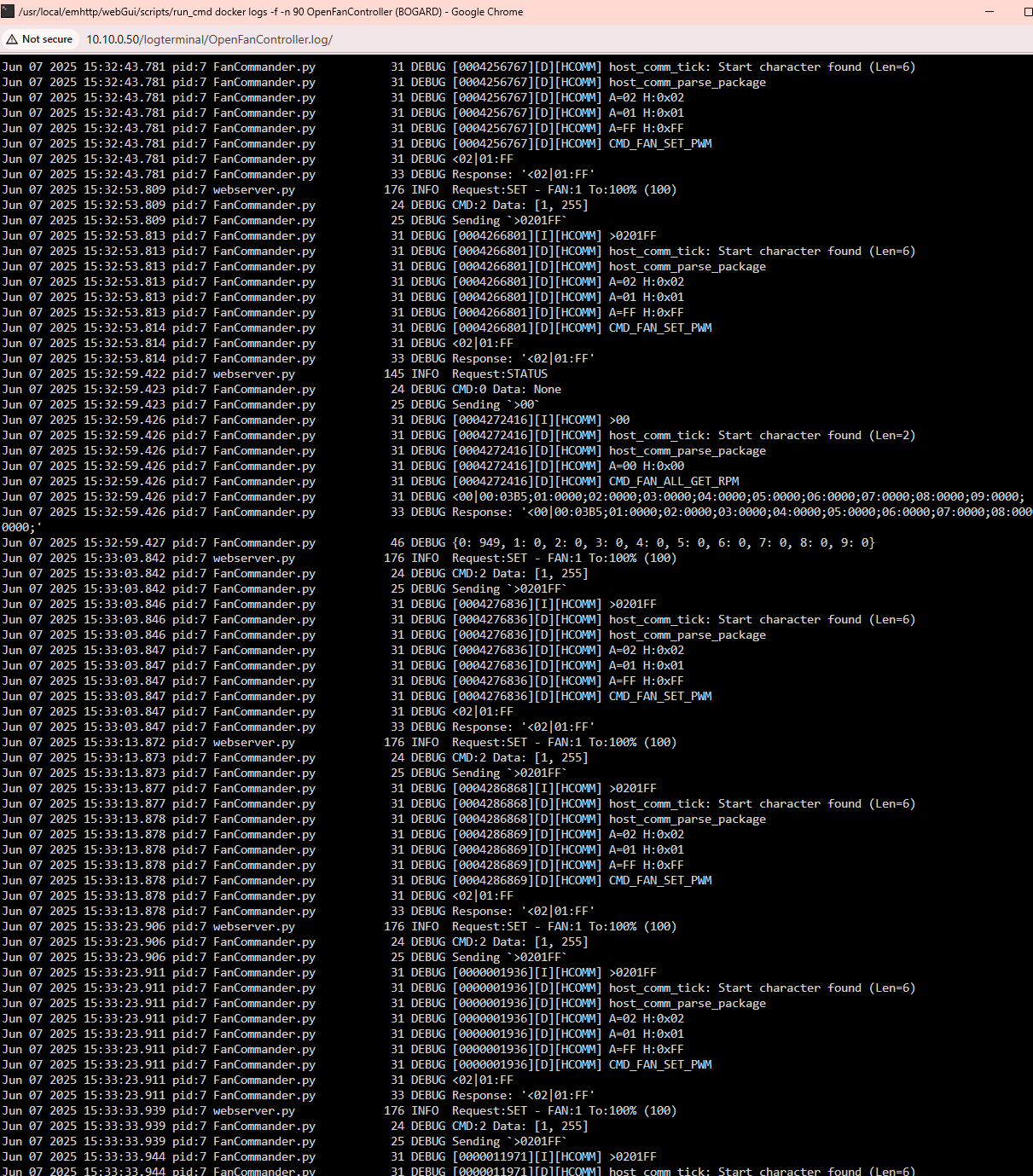

After some errors on my part getting the OpenFanUnraidService to communicate with the OpenFanController, as I was using port 3000 instead of 3210, I got the communication between them working.
However, I noticed that not matter the FanProfiles Points or whether I used RPM or PWM (yes, I set UsePWM to true) the fan speed did not change.

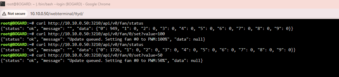

I decided to shutdown the OpenFanUnraidService and test the API, so I just used curl and first got the status, which show Fan 1 (only fan connected since I'm testing) at 951.
So I set the fan speed to 100% PWM
The fan physically didn't do anything, so I got the status again, and the fan is shown still running around ~950 RPM

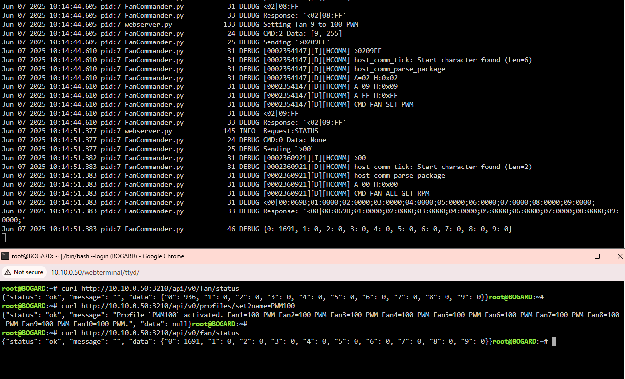

Odd... so I decided to test with profiles. First I created two new profiles PWM50 and PWM100.
Then ran status, set PWM100 and ran status again, that worked!
Reverted back to PWM50
Now tried again to set the fan 1 PWM and it again failed! It is receiving and setting the PWM but no change.
@SasaKaranovic any ideas?
Edited by PeterDB

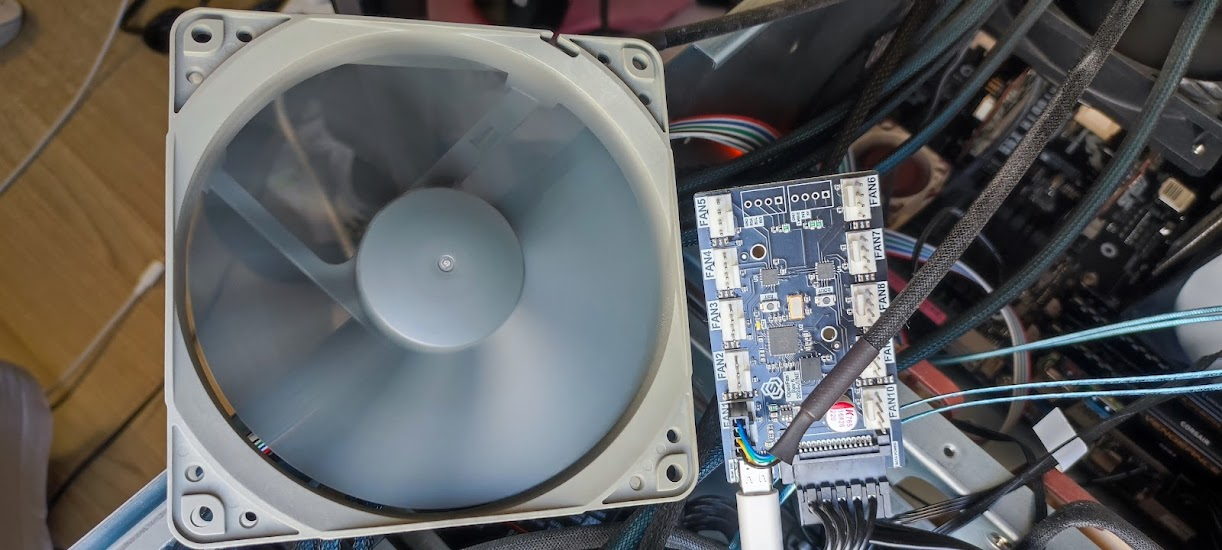

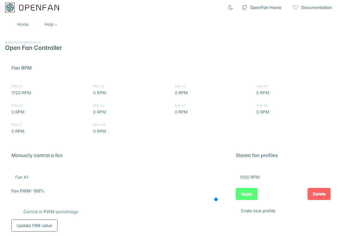

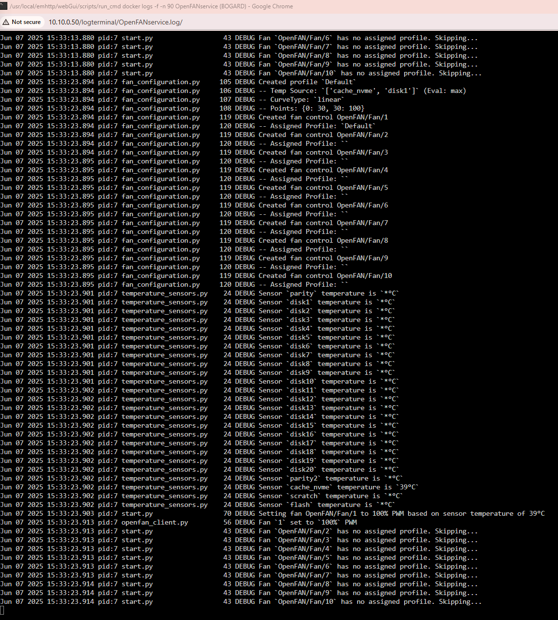

Hi @SasaKaranovic
I do have a 4pin PWM Noctua NF-P12 connected to FAN1

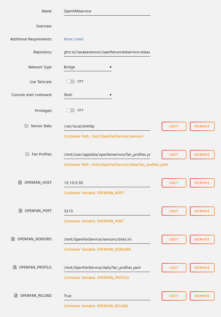

and I also have the Unraid Community OpenFanController docker and OpenFanUnraidService installed and running
For OpenFanController I left the port at default 3210 and changed nothing:

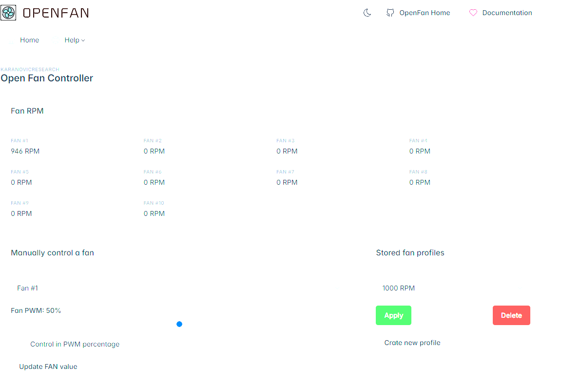

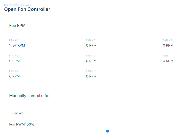

I am able to access OpenFanController docker and it is able to able to manually control FAN1, here it is spun up to 100% PWM with around ~1700 RPM
Here is FAN1 at 50% PWM with around ~940 RPM

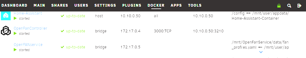

The OpenFanUnraidService is also set up and running with this docker configuration
And the fan_profiles.yaml is in /mnt/user/appdata/openfanservice/
With this simple configuration looking only as the cache_nvme and disk1 temps , set with a linear curve and top temperature set to 30 and 100% PWM. The fan_profiles.yaml was built over the included https://github.com/SasaKaranovic/OpenFanUnraidService/blob/master/src/sample_profile.yaml
Right now that cache_nvme drive is hitting 39C, and according to the fan_profiles.yaml FAN1 should be at 100% PWM
As seen earlier in the earlier screenshot, 100% PWN is ~1700 RPM, but it's only at ~940 RPM

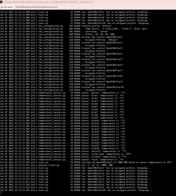

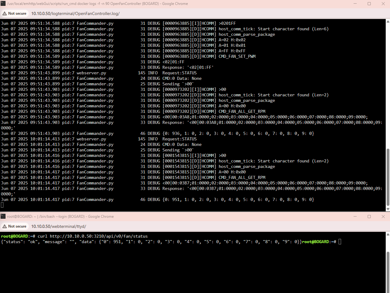

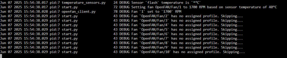

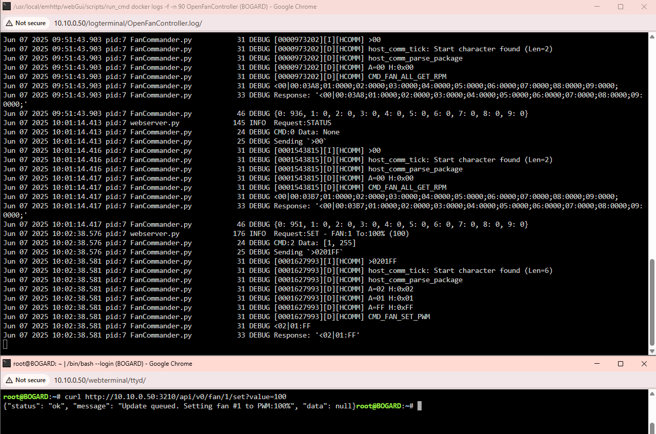

This is why I started to check the logs and API calls. I can see from the OpenFanUnraidService that the profile is being created and FAN1 is being set to 100% PWM and also that the cache_nvme drive temperature is seen at 40C.
From the OpenFanController logs, I can also see that it is receiving the API call and setting FAN1 to 100%. However, the fan is not adjusting the RPM.

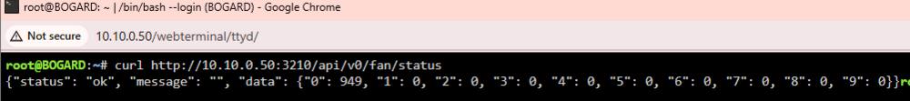

Now, you are right, my earlier API calls, had 1 instead of 0 as the selected FAN (I blame that I being up to 3am and emailing you, plus my wife's alarming then going off at 7am again).
and when I do use 0 instead of 1, it does spin up to 100% PWM
However, how come the fan_profiles.yaml doesn't do this, when it sees that the cache_nvme drive is 40C and the highest point is set to 30,100 (30C 100% PWM)?
I tried make the fan_profiles.yaml even more simple and just set 0,100 and only lookg at cache_nvme...
but that still didn't make any change

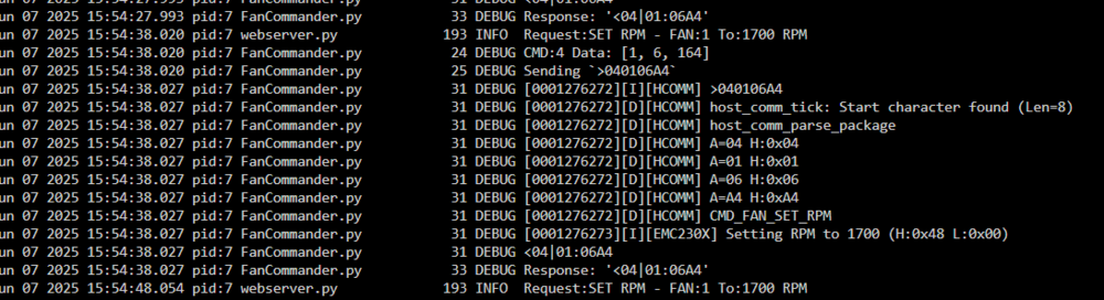

I changed again to using RPM..
The OpenFanUnraidService is sending it
And OpenFanController is receiving it
But that also didn't make any change to the RPM
So back again to the quesiton, if the dockers are set up and the API calls are received, how come there is no change?
Updating with the logs:
logs.zip
Edited by PeterDB

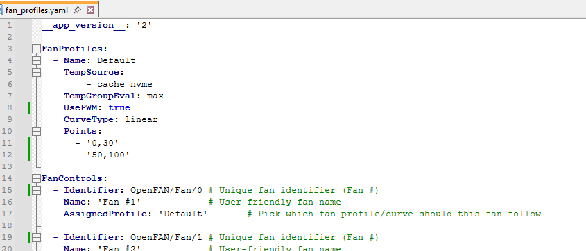

@SasaKaranovic I found the error! It's the sample_profile.yaml!
I went through the logs and saw that OpenFanUnraidService is making the API call to the wrong fan; fan 1 instead of fan 0! The reason being is that the sample_profile.yaml that I copied from https://github.com/SasaKaranovic/OpenFanUnraidService/blob/master/src/sample_profile.yaml it has FAN1 with the identifier OpenFAN/Fan/1 not OpenFAN/Fan/0.
Once I made the change, it is now working!
Edited by PeterDB

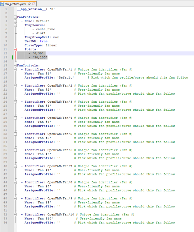

I have an odd issue. I have three drive cages. Each cage has the same fan in it. These PWM fans are capable of 4500rpm. When I am running the openfan docker I can manually adjust the PWM percentage of each fan and watch the RPM increase. When running the openfan unraid service docker the FAN#4 in my config wants to set itself to about 1500 RPM. I can see in the logs as the drive temp increases the unraid service docker continues to increase the commanded pwm percentage up to 90% but the fan stays around 1500rpm. The other fans seem to work fine. I did not find a reason for this behavior in the YAML config.
Unraid Version: 7.1.2
fan_profiles.yaml
Edited by K1ng0011
fan_profiles.yaml
Hi @K1ng0011
I think you have the same issue as me, the sample profiles yaml is not correct and Saša is aware of this.
Update your yaml so that the identifier starts at OpenFAN/Fan/0 not OpenFAN/Fan/1, and update the others too so it's 0 to 9 not 1 to 10.
Now test
Edited by PeterDB

Fix the "Crate new profile"
3 minutes ago, K1ng0011 said:
Perfect its fixed now my fans are being controlled via the unraid service docker I created. I also noticed the following issue below. I know I am just nit picking but the spelling is off. Also I find it odd that in the actual docker for the open fan controller that the max fan speed is 3000 rpm. Maybe there is a reason that I am not aware of but some fans like mine are capable of more than 3000rpm.
hahahah @SasaKaranovic one more minor thing to fix.
