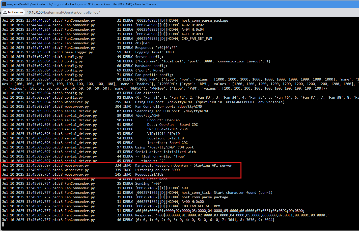

@SasaKaranovic Can you please check what is happening with the latest version of the container? You can check the errors I am getting the previous message.
Hey @JayBee_Unraid the logs has [Errno 111] Connection refused
This means that 192.168.0.5 is refusing connection on port 3000
Most likely you don't have the OpenFAN Controller container running on that IP or it's not running on port 3000.
Maybe double check that you have the correct IP and the port specified. Also make sure that the containers can talk to each other (reachable over network).
p.s. You need to have both, the OpenFAN Controller docker and the OpenFAN Unraid Service docker running and properly configured.

No I already double checked, and it is on the port 3000, else I would have fixed it already...
I didn't change anything in the config compared to the previous versions, and these versions were running fine.
I also tried with 3210 just in case but it's not working either obviously since it's the web interface port.
Are you sure the container version on the github was updated to the latest one this time? It wasn't the case last time.
Also did you try to do a fresh install on your unraid through your own github address to see what it does on your own machine?

You're running the container with bridge networking, so the IP address is 172.17.0.8 with port 3000. Your log shows
Port 3210 is the default port for the web UI. It's not the port listening for API connections, which is 3000.
I recommend you re-check your network configuration on the OpenFanController. Here's how to rule out a network issue or confirm the controller is listening correctly.
From any device on the network, confirm that you can ping the IP address of the controller. If you want the controller to just use the IP address of the unRaid server as the destination, set the network type to host. You then just configure the OpenFANService to connect to the unRaid server IP address. If you want to use the fixed IP of 192.168.0.5 (which doesn't appear to be the IP of your unRaid server) then you need to change the network type to one configured for that network.
Once you confirm that the network packets can be delivered to the controller, confirm the controller is listening on that port. From any device on the network, do a "telnet <ip of controller> <port>". If it's able to connect, you'll see the telnet session clear your screen showing that it connected. You can then do a ctrl-c or ctrl-] to exit the session.
This will help you step through where it's failing. If the telnet works, then you at least have confirmed there's nothing on the network layer causing the issue. From what I can tell, you have a network issue and it's not the OpenFAN controller or service.
Edited by RandoUser
That was it! I just needed to switch it to host. Thanks for figuring that out.
