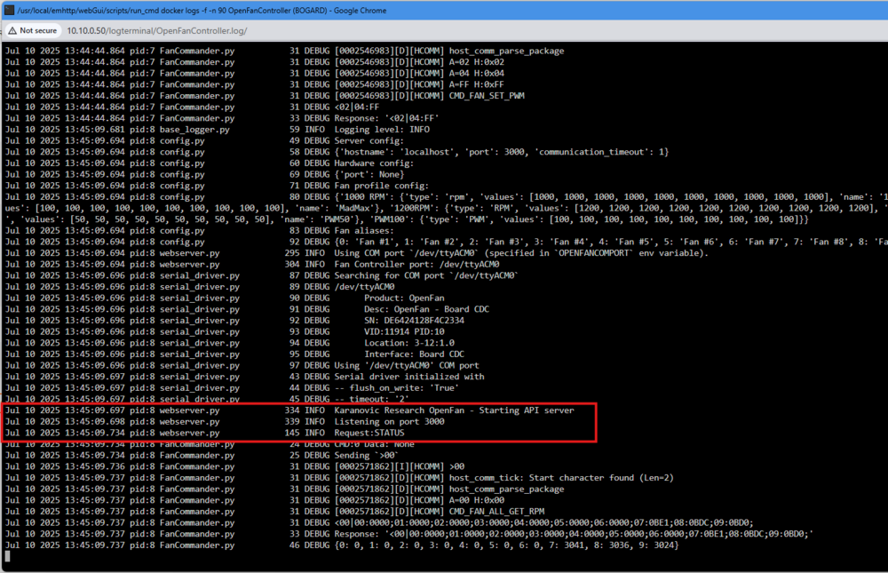

@Enfoxed That's odd. Can you log into your Unraid system and check if you have `/dev/ttyACM0`?
I can see `/dev/ttyACM0` is specified as the COM port
`Dec 18 2024 16:53:29.840 pid:7 webserver.py 295 INFO Using COM port `/dev/ttyACM0` (specified in `OPENFANCOMPORT` env variable).`
But immediately underneath it's selecting `/dev/ttyS0` which is obviously wrong
`Dec 18 2024 16:53:29.843 pid:7 serial_driver.py 89 DEBUG /dev/ttyS0`

    New version should be live now. Main improvement should be that now you are able to specify multiple disks temperatures to be used for determining fan curve profile. This should hopefully make a life

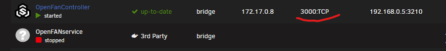

  • JayBee_Unraid
    JayBee_Unraid
    That was it! I just needed to switch it to host. Thanks for figuring that out. No, that address is the one used my unRaid server, you can see it in the screenshot. No problem with the port either. It
Hmm, i cant find it...
Do i need to reactivate it (hardware side) after restart after an update? Never had this issue before

@Enfoxed  You can try power-cycling the OpenFAN Controller and/or restarting the Unraid.
For some reason your system is not registering the board. Maybe the one of the cables got disconnected?
A restart didnt work, i have to open the server tomorrow to check all cables but i dont think they are disconnected. maybe a replug will work
If you can power cycle everything and double check that all the cable are plugged in correctly, that would be great. Please let me know how it goes.

Hi, this helped for a short time. I have to shutdown the complete server and disconnect the fancontroller a few minutes and plug it back in and boot up the server again. Then it works for a period of time. Since this post i had to do several of these restarts because of the fan controller. The usb port works fine for other devices and also changing the port doesnt help. I also dont knwo why the connection from Hardware to docker has to be there. everytime the docker is not reachable because of this connection issue, the fans will run in 100%mode. I have another fan controller from aquacomputer in another rig and there it works without any usb connection after a first setup.
The Docker Log when it happens: Apr 10 2025 08:57:29.623 pid:7 base_logger.py            59 INFO  Logging level: INFO
Apr 10 2025 08:57:29.633 pid:7 config.py                 49 DEBUG Server config:
Apr 10 2025 08:57:29.633 pid:7 config.py                 58 DEBUG {'hostname': 'localhost', 'port': 3000, 'communication_timeout': 1}
Apr 10 2025 08:57:29.633 pid:7 config.py                 60 DEBUG Hardware config:
Apr 10 2025 08:57:29.633 pid:7 config.py                 69 DEBUG {'port': None}
Apr 10 2025 08:57:29.633 pid:7 config.py                 71 DEBUG Fan profile config:
Apr 10 2025 08:57:29.633 pid:7 config.py                 80 DEBUG {'1000 RPM': {'type': 'rpm', 'values': [1000, 1000, 1000, 1000, 1000, 1000, 1000, 1000, 1000, 1000], 'name': '1000 RPM'}, 'MadMax': {'type': 'PWM', 'values': [100, 100, 100, 100, 100, 100, 100, 100, 100, 100], 'name': 'MadMax'}, '1200RPM': {'type': 'RPM', 'values': [1200, 1200, 1200, 1200, 1200, 1200, 1200, 1200, 1200, 1200], 'name': '1200RPM'}}
Apr 10 2025 08:57:29.633 pid:7 config.py                 83 DEBUG Fan aliases:
Apr 10 2025 08:57:29.633 pid:7 config.py                 92 DEBUG {0: 'Fan #1', 1: 'Fan #2', 2: 'Fan #3', 3: 'Fan #4', 4: 'Fan #5', 5: 'Fan #6', 6: 'Fan #7', 7: 'Fan #8', 8: 'Fan #9', 9: 'Fan #10'}
Apr 10 2025 08:57:29.633 pid:7 webserver.py             295 INFO  Using COM port `/dev/ttyACM0` (specified in `OPENFANCOMPORT` env variable).
Apr 10 2025 08:57:29.633 pid:7 webserver.py             304 INFO  Fan Controller port: /dev/ttyACM0
Apr 10 2025 08:57:29.634 pid:7 serial_driver.py          87 DEBUG Searching for COM port `/dev/ttyACM0`
Apr 10 2025 08:57:29.634 pid:7 webserver.py             373 ERROR OpenFan API service crashed during setup.
  File "/mnt/OpenFan/webserver.py", line 371, in main
    FAN_API_Service().run_forever()
  File "/mnt/OpenFan/webserver.py", line 305, in __init__
    self.fan_commander = FanCommander(self.serialPort)
  File "/mnt/OpenFan/FanCommander.py", line 10, in __init__
    super(FanCommander, self).__init__(port_info, timeout=2)
  File "/mnt/OpenFan/serial_driver.py", line 28, in __init__
    raise TypeError("The port_info must be of type {} (given: {})".format(self.__class__, _lpc.ListPortInfo))
TypeError: The port_info must be of type <class 'FanCommander.FanCommander'> (given: <class 'serial.tools.list_ports_common.ListPortInfo'>)
ls -l dev.txt
Hey @Enfoxed!
Sorry about the delay. In the future, if you need support, please email shop [at] sasakaranovic [dot] com directly.
There can be a lot of reasons why the app is intermittently not working as expected and it's very hard to debug it remotely. I suggest opening a support ticket by emailing the above mentioned address.
Also make sure you are running the latest version of the docker application and that you have a good quality (and as short-as-possible) USB cable.
The Docker application is just one of the ways you can use this controller (with Unraid).
The official documentation should help you jump off if you want to build your own solution.
I am not sure what is going on in your setup but this should _not_ be the possible, by design... If your docker application stops/is-not running, the fans will remain in the last state they were until told otherwise. They will not spin up to 100% on their own. Is it possible that you have some other application that is "fighting" to control this COM port?
I have to admit that even though I try my best, this is probably still a very "hacky" open-source open-hardware DIY project. But I still think people should be happy with their purchase, especially if they are supporting my project!
With that said, if you are not happy with the controller (for whatever reason) or you have a better solution that you would like to use, please email me and we can arrange to have you ship the unit back and I will issue a refund for your order, no questions asked.
