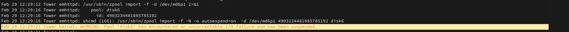

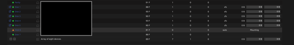

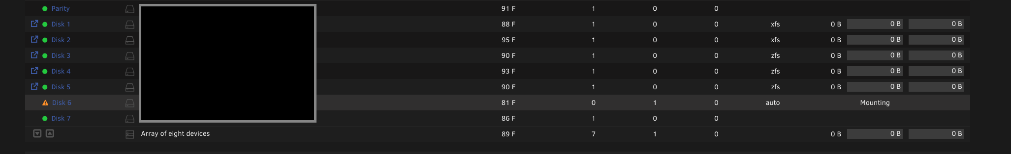

Upon accessing server Unraid was not running processes so I rebooted. Upon rebooting the a ZFS disk in the array was stuck on mounting. I checked all connections rebooted and the same. I tried to replace the drive thinking there is an issue with the drive since I had uncorrectable I/O failure. How do I get the drive to mount, and should it be the original drive since the drive I tried to replace it with won't mount either?

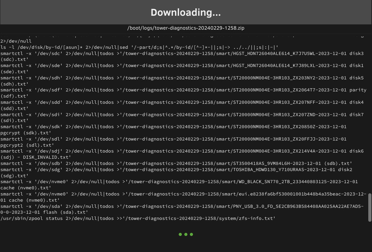

If I understand correctly you already had the same issue with the actual disk before trying the emulated disk? Also please post the diagnostics.
Yes same issue on original disk 6. Trying to pull diagnostics seems stuck here.
You will need to reboot, force it if needed, then don't start the array, post the diags and the output of

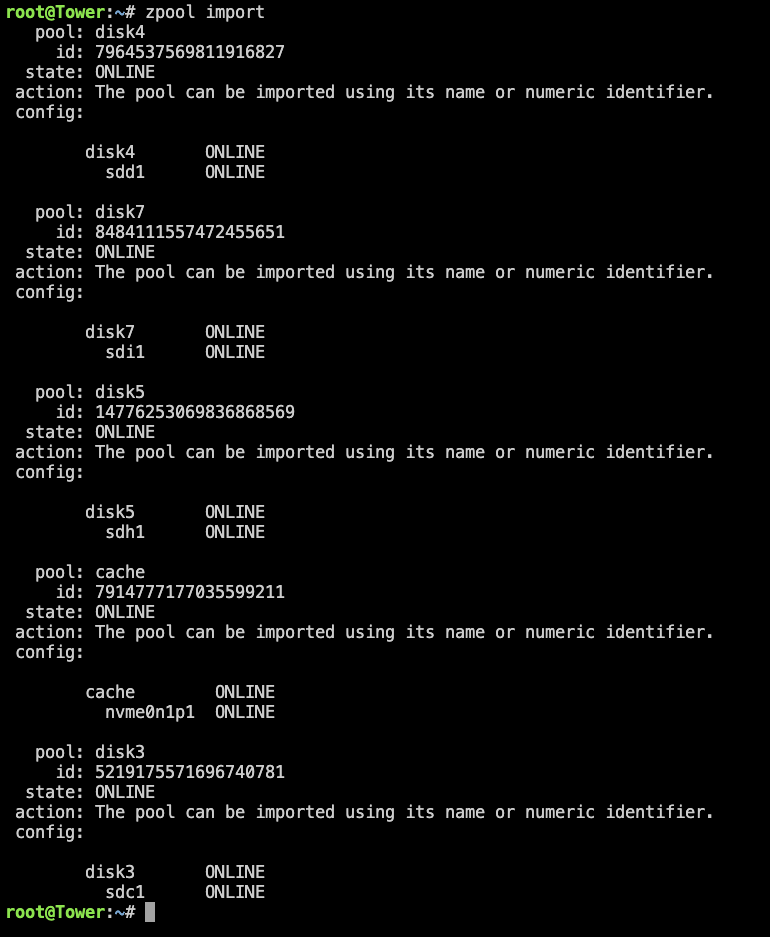

All array disks are using zfs right? Besides disk6 I'm not seeing pools for disks 1 and 2 there.
Try
zpool import -F disk6

Says no such pool available
