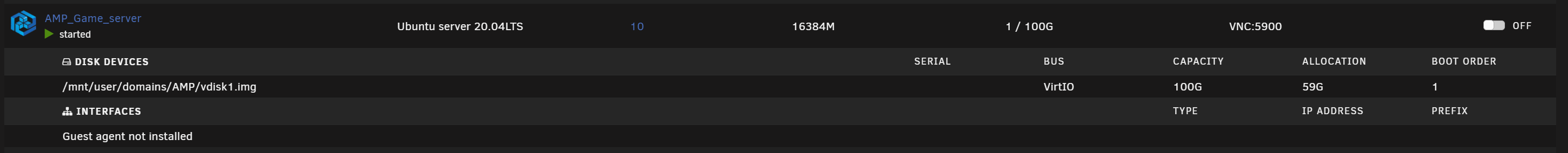

All my VM's work except the AMP VM for my gaming server?
I can see it doesn't get any IP? (This configuration is the same as my Windows VM and that worked perfectly after moving?)

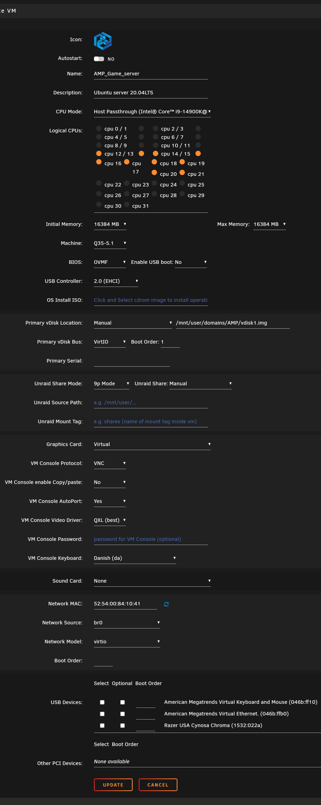

Configuration:
XML:
<domain type='kvm'>
  <name>AMP_Game_server</name>
  <uuid>106257ad-bf64-1305-df79-880b565808af</uuid>
  <description>Ubuntu server 20.04LTS</description>
  <metadata>
    <vmtemplate xmlns="unraid" name="Ubuntu" icon="/mnt/user/domains/AMP/amp.png" os="ubuntu"/>
  </metadata>
  <memory unit='KiB'>16777216</memory>
  <currentMemory unit='KiB'>16777216</currentMemory>
  <memoryBacking>
    <nosharepages/>
  </memoryBacking>
  <vcpu placement='static'>10</vcpu>
  <cputune>
    <vcpupin vcpu='0' cpuset='12'/>
    <vcpupin vcpu='1' cpuset='13'/>
    <vcpupin vcpu='2' cpuset='14'/>
    <vcpupin vcpu='3' cpuset='15'/>
    <vcpupin vcpu='4' cpuset='16'/>
    <vcpupin vcpu='5' cpuset='17'/>
    <vcpupin vcpu='6' cpuset='18'/>
    <vcpupin vcpu='7' cpuset='19'/>
    <vcpupin vcpu='8' cpuset='20'/>
    <vcpupin vcpu='9' cpuset='21'/>
  </cputune>
  <os>
    <type arch='x86_64' machine='pc-q35-5.1'>hvm</type>
    <nvram>/etc/libvirt/qemu/nvram/106257ad-bf64-1305-df79-880b565808af_VARS-pure-efi.fd</nvram>
  </os>
  <features>
    <acpi/>
    <apic/>
  </features>
    <topology sockets='1' dies='1' cores='5' threads='2'/>
    <cache mode='passthrough'/>
  </cpu>
  <clock offset='utc'>
    <timer name='rtc' tickpolicy='catchup'/>
    <timer name='pit' tickpolicy='delay'/>
  </clock>
  <on_crash>restart</on_crash>
  <devices>
      <source file='/mnt/user/domains/AMP/vdisk1.img'/>
      <boot order='1'/>
      <address type='pci' domain='0x0000' bus='0x03' slot='0x00' function='0x0'/>
    </disk>
    </controller>
      <master startport='0'/>
    </controller>
      <master startport='2'/>
    </controller>
      <master startport='4'/>
    </controller>
    <controller type='pci' index='0' model='pcie-root'/>
    <controller type='pci' index='1' model='pcie-root-port'>
      <model name='pcie-root-port'/>
      <target chassis='1' port='0x10'/>
      <address type='pci' domain='0x0000' bus='0x00' slot='0x02' function='0x0' multifunction='on'/>
    </controller>
    <controller type='pci' index='2' model='pcie-root-port'>
      <target chassis='2' port='0x11'/>
      <address type='pci' domain='0x0000' bus='0x00' slot='0x02' function='0x1'/>
    </controller>
    <controller type='pci' index='3' model='pcie-root-port'>
      <target chassis='3' port='0x12'/>
      <address type='pci' domain='0x0000' bus='0x00' slot='0x02' function='0x2'/>
    </controller>
    <controller type='pci' index='4' model='pcie-root-port'>
      <target chassis='4' port='0x13'/>
      <address type='pci' domain='0x0000' bus='0x00' slot='0x02' function='0x3'/>
    </controller>
    <controller type='pci' index='5' model='pcie-root-port'>
      <target chassis='5' port='0x14'/>
      <address type='pci' domain='0x0000' bus='0x00' slot='0x02' function='0x4'/>
    </controller>
      <address type='pci' domain='0x0000' bus='0x02' slot='0x00' function='0x0'/>
    </controller>
      <address type='pci' domain='0x0000' bus='0x00' slot='0x1f' function='0x2'/>
    </controller>
    <interface type='bridge'>
      <mac address='52:54:00:84:10:41'/>
      <source bridge='br0'/>
      <model type='virtio'/>
      <address type='pci' domain='0x0000' bus='0x01' slot='0x00' function='0x0'/>
    </interface>
    <serial type='pty'>
        <model name='isa-serial'/>
      </target>
    </serial>
    <console type='pty'>
    </console>
    <channel type='unix'>
    </channel>
    </input>
    <graphics type='vnc' port='-1' autoport='yes' websocket='-1' listen='0.0.0.0' keymap='da'>
    </graphics>
    <audio id='1' type='none'/>
    <video>
      <address type='pci' domain='0x0000' bus='0x00' slot='0x01' function='0x0'/>
    </video>
    <memballoon model='virtio'>
      <address type='pci' domain='0x0000' bus='0x04' slot='0x00' function='0x0'/>
    </memballoon>
  </devices>
</domain>

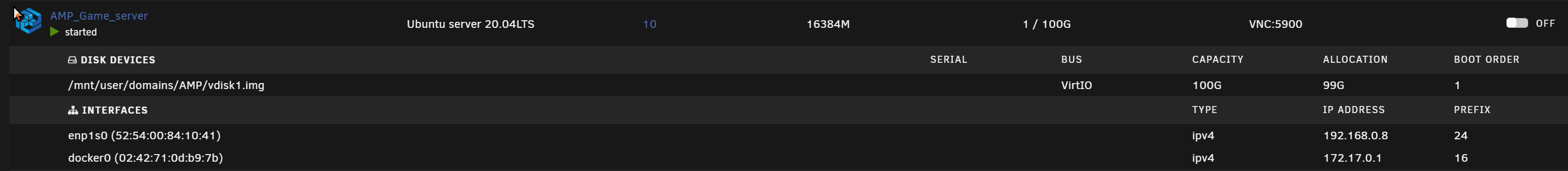

I can connect to the Webserver UI? But it have no internet connection, so strange
Solved by casperse
SOLVED: I am an IDIOT....
Checking the network settings on the ubuntu:
sudo nano /etc/netplan/00-installer-config.yaml
Somehow the gateway was wrong?
Also installing the Guest service:
Step 1: Log in using SSH
You must be logged in via SSH as sudo or root user. Please read this article for instructions if you don’t know how to connect.
Step 2: Install qemu guest agent
apt update && apt -y install qemu-guest-agent
Step 3: Enable and Start Qemu Agent
systemctl enable qemu-guest-agent
systemctl start qemu-guest-agent
Step 4: Verify
Verify that the Qemu quest agent is running
systemctl status qemu-guest-agent
