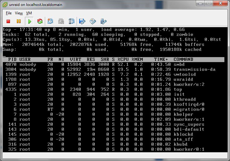

I tried what you said with the irqfixup in syslinux.cfg, and it works for the first transfer (over 40 MB/s). After that it's back to what it was (slow and high cpu usage). After the transfer the cpu usage goes back down, but the transfers never speed up, until I reset unraid. I attached a picture of unraid running top if it can help.

The I/O wait (wa%) looks fine.  Are you trying to write to the same disk that transmission is saving/downloading to?  If that is the case then try stopping all of Transmission and see if the speed picks back up a little bit.
I would probably also not make the NIC's dedicated per VM in this case.  virtual e1000 NIC for my unRAID build works perfectly fine.
