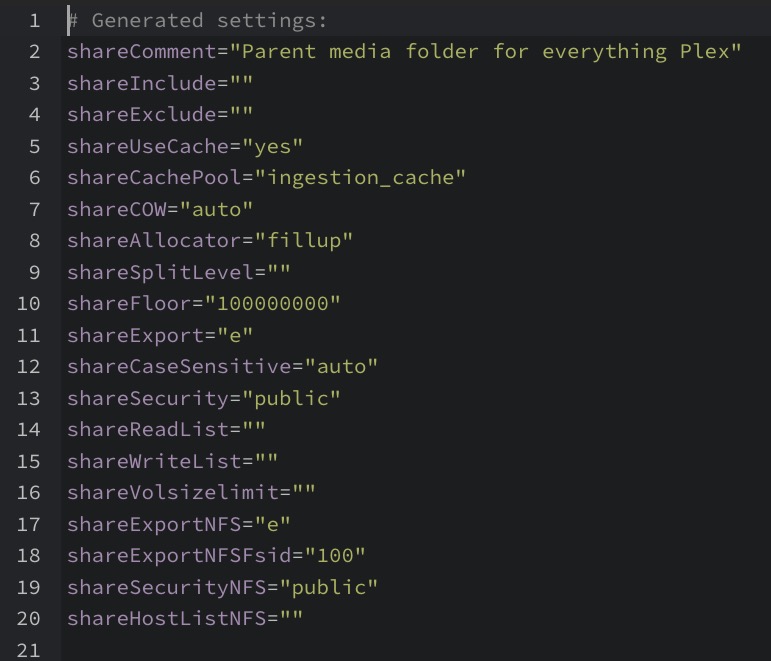

Not sure I follow.  There doesn't seem to be any information regarding the disk configuration.  is it perhaps in another folder?

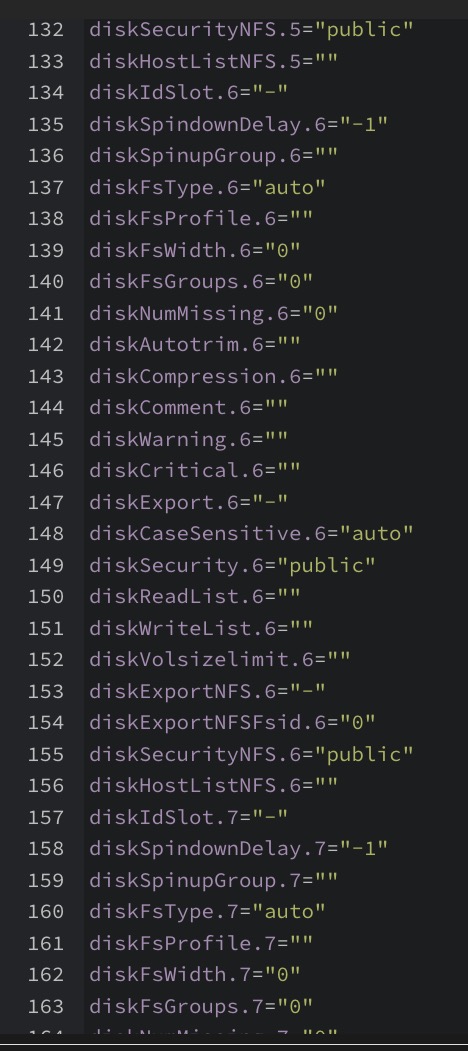

I found a disk.cfg file.  Since disk 6 is one of the disks it is looking for which I'v removed, would it make sense to delete everything between, and including, lines 134-156?  Then do that for all the missing disks?
475462792_StudioSnippet2024-03-23at12_41_46.thumb.jpg.202e6c069b89ee84a48b07b267a43b91.jpg
In your earlier diagnostics, unraiddata.cfg contains
# Share exists on ingestion_cache, disk1, disk2, disk3
# Generated settings:
shareComment="..."
shareInclude="disk1,disk2,disk3,disk4,disk5,disk6,disk7,disk8,disk9,disk10,disk11"
shareExclude=""
shareUseCache="yes"
shareCachePool="ingestion_cache"
shareCOW="auto"
shareAllocator="fillup"
shareSplitLevel=""
shareFloor="100000000"
shareExport="e"
shareCaseSensitive="auto"
shareSecurity="public"
shareReadList=""
shareWriteList=""
shareVolsizelimit=""
shareExportNFS="e"
shareExportNFSFsid="100"
shareSecurityNFS="public"
shareHostListNFS=""
So perhaps it is fixed now if it doesn't show anything in shareInclude.
