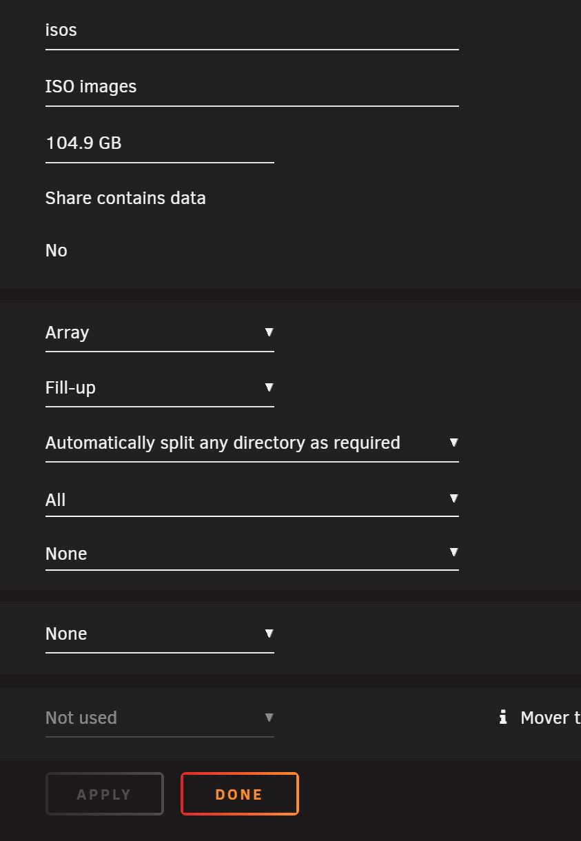

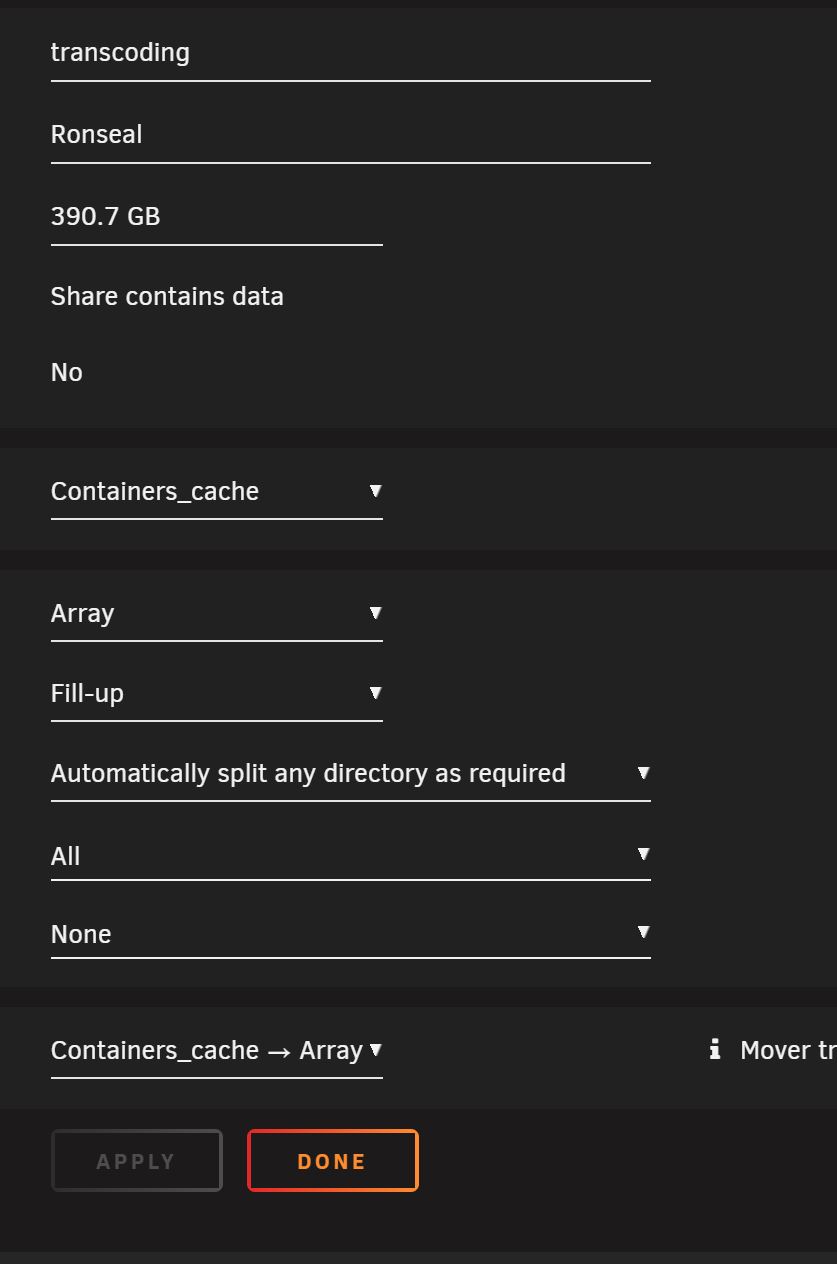

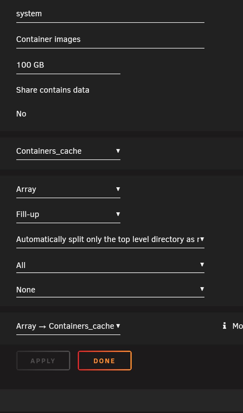

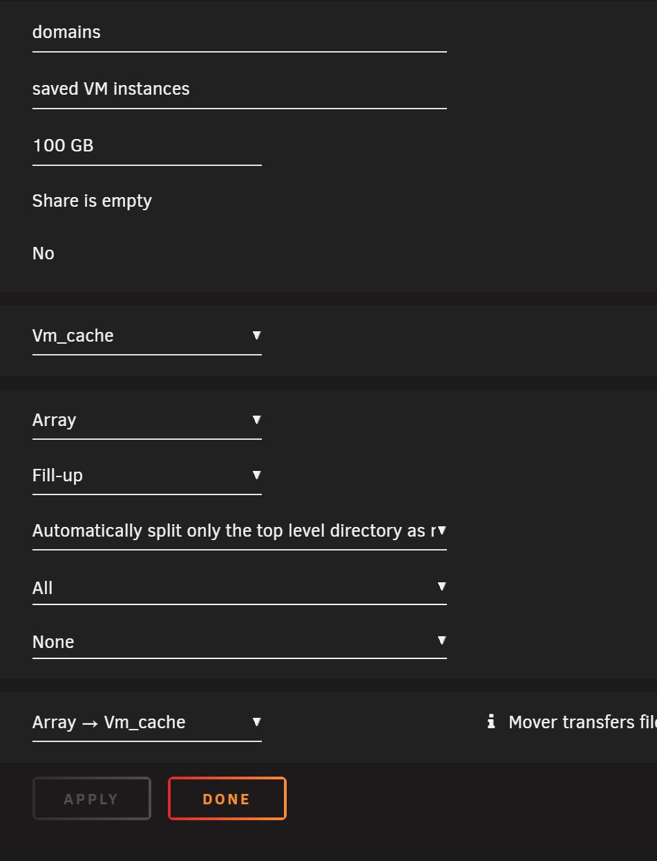

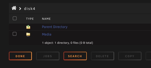

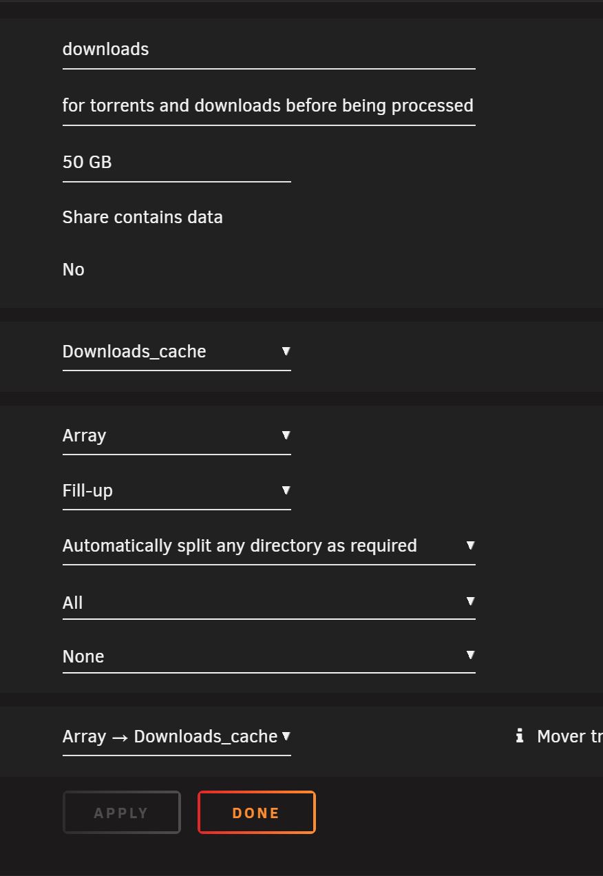

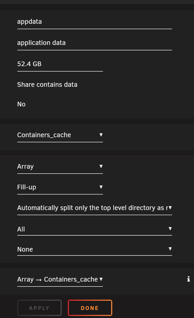

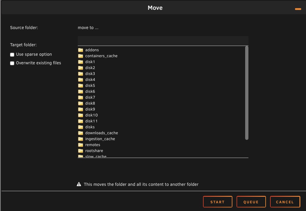

Ok, so using File Manager, selecting the folder Media (in my case) which has TV and Film subfolders, and moving it to another disk as per the images?

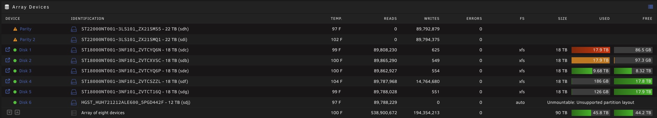

Also, I just noticed that despite the disks saying there is 126GB of data used on the drives I want to use, the folders are empty.  is this expected?
There is always some filesystem overhead even on a newly formatted disk.

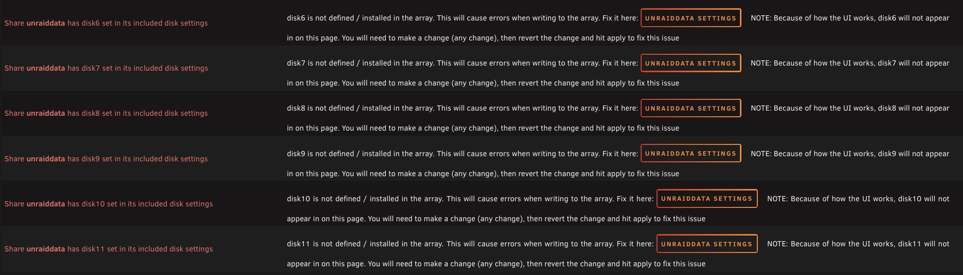

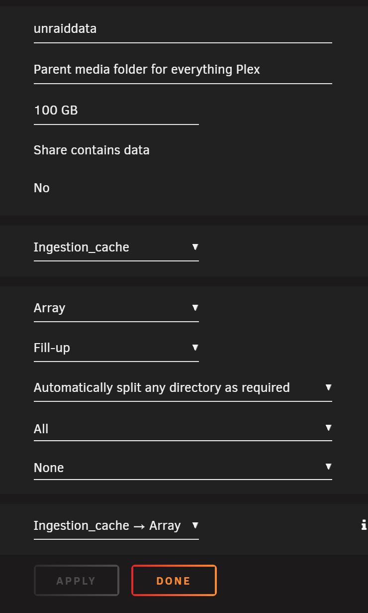

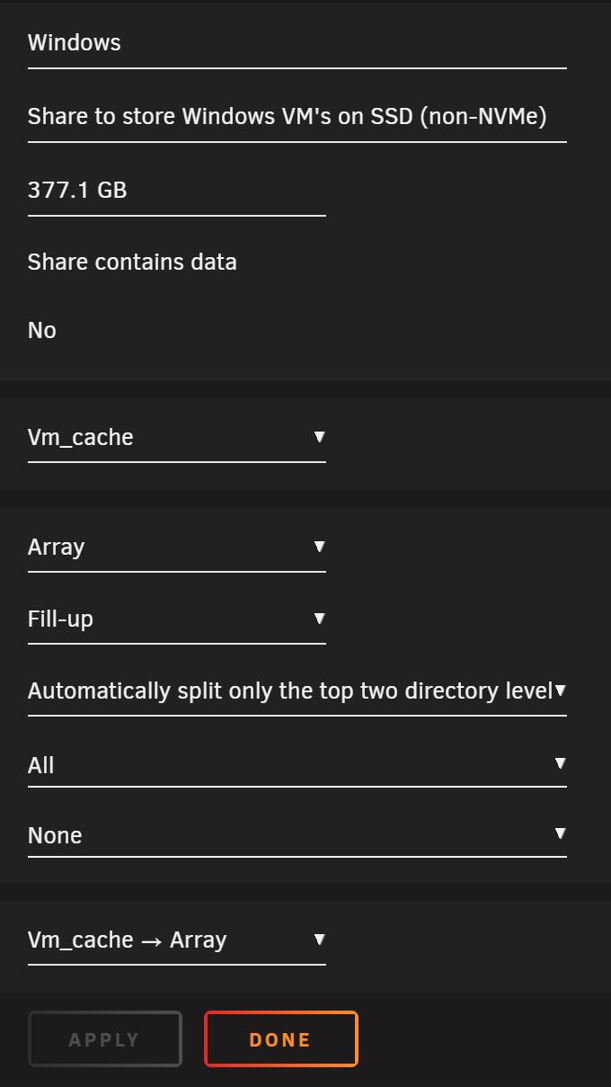

The messages will be valid if you explicitly gave a list of included disks in the definition of the share rather than leaving it at the default of ‘all’ and did not go into the settings for the share to adjust the list after removing the disks.
 However no reason that would have caused the system to lock up like you describe sp I suspect you have some other problem.

Have you done anything to start correcting those reported problems which all look like they are probably genuine.
1 hour ago, Bmalone said:
Mar 21 13:53:09 Goathead root: Fix Common Problems: Error: Share unraiddata has disk6 set in its included disk settings
Mar 21 13:53:09 Goathead root: Fix Common Problems: Error: Share unraiddata has disk7 set in its included disk settings
Mar 21 13:53:09 Goathead root: Fix Common Problems: Error: Share unraiddata has disk8 set in its included disk settings
Mar 21 13:53:09 Goathead root: Fix Common Problems: Error: Share unraiddata has disk9 set in its included disk settings
Mar 21 13:53:09 Goathead root: Fix Common Problems: Error: Share unraiddata has disk10 set in its included disk settings
Mar 21 13:53:09 Goathead root: Fix Common Problems: Error: Share unraiddata has disk11 set in its included disk settings
If you want to restrict a share so it only goes to a few disks, Include is the right idea. If you want to restrict a share so it doesn't go to a few disks, Exclude is the right idea. Never use Include and Exclude together.
Looks like you tried to include a lot of disks you no longer have. Better to Include All instead of specific disks that might not exist.
It's not clear how to fix the shares looking for drives that aren't there.  I haven't selected any specific disks and checking them, they are all set to all.
The Guacamole share was one I created, but then when I mapped a Windows drive to that in Guacamole, it created an additional one.  I tried using Dynamix File Manager to delete it and that made everything unresponsive, so no, I've been afraid to touch it again.  At least all my containers are working now and I can read/write files, which is good enough to move all the data onto the new server while I wipe it and start afresh.
According to the diagnostics the ‘unraidddata’ share DOES have a list of included drives in its settings.   If you think that is not the case then perhaps a screenshot of the settings page for that share might clarify things?
AFAIK the problem is that once a drive was removed the UI doesn't show it in the list anymore so while it's still in the config file you can't see or unselect it in the UI.
Edited by Kilrah
you could try editing the config/shares/unraiddata,cfg file on the flash drive to adjust the list of included drives.
i must admit i thought that making any change to the list and using Apply would rewrite the values to reflect the new selection
See image of the settings.  Seems like the GUI doesn't accurately reflect the actual settings.
appdata                           shareUseCache="prefer"  # Share exists on containers_cache, disk1, disk3, vm_cache

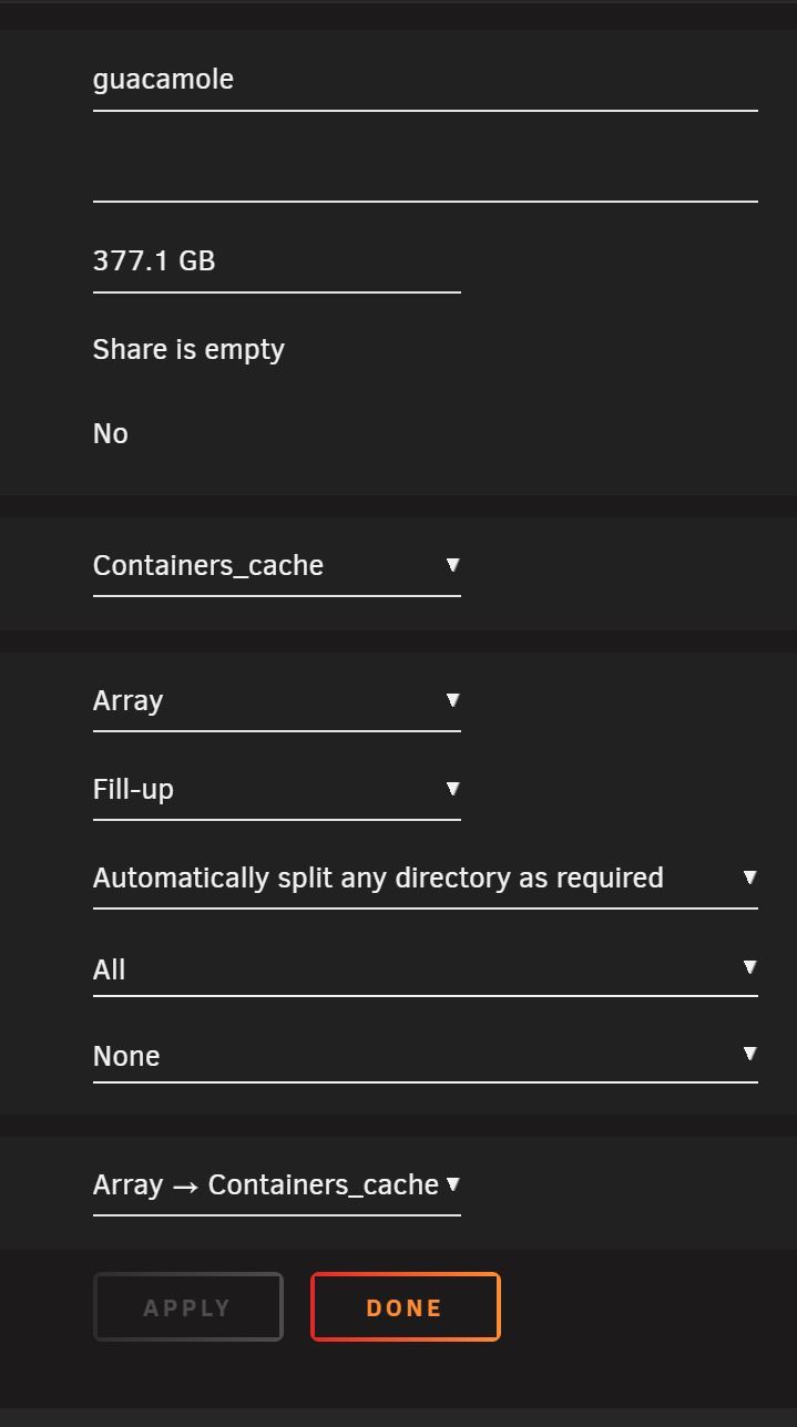

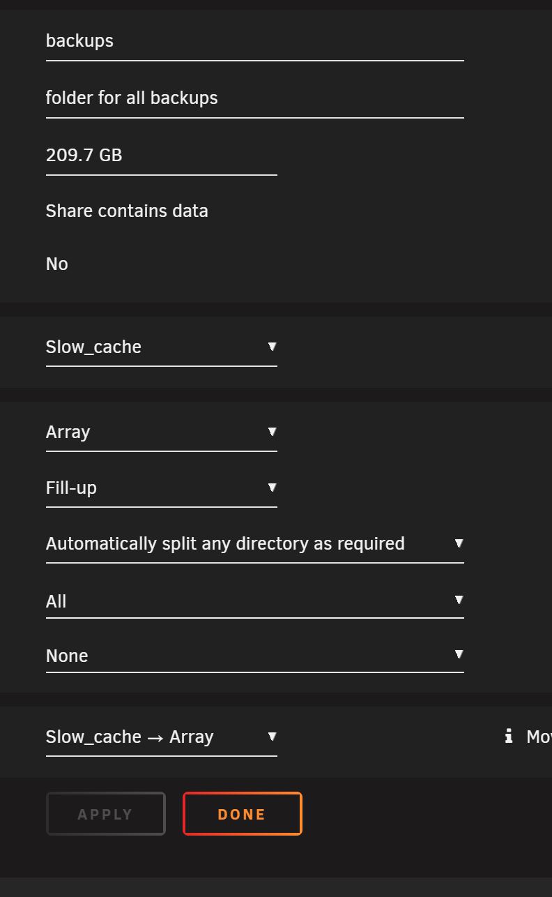

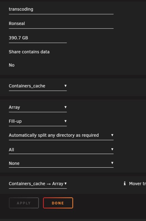

I have that set to move from array to cache.  That's where my torrent downloads land, and I want to move them manually to the ingestion cache which feeds the shares when I want.  If it fills up, I expect it will spill over to the array, and then when I free up space, my expectation is mover will move as much as it can back to the cache.  Is that not correct?
I've added screen shots of the GUI settings too.
Is that somewhere on the flash drive?
