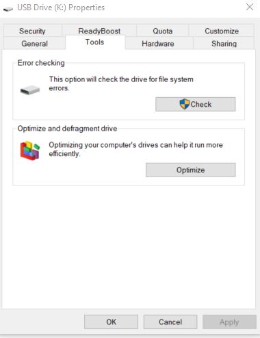

And it booted up fine. I then decided to shut the server down via the web gui. Removed the flash drive and placed it into my Windows 10 computer and ran a Windows check disk from the Windows Tools menu.
Errors were found and corrected.
