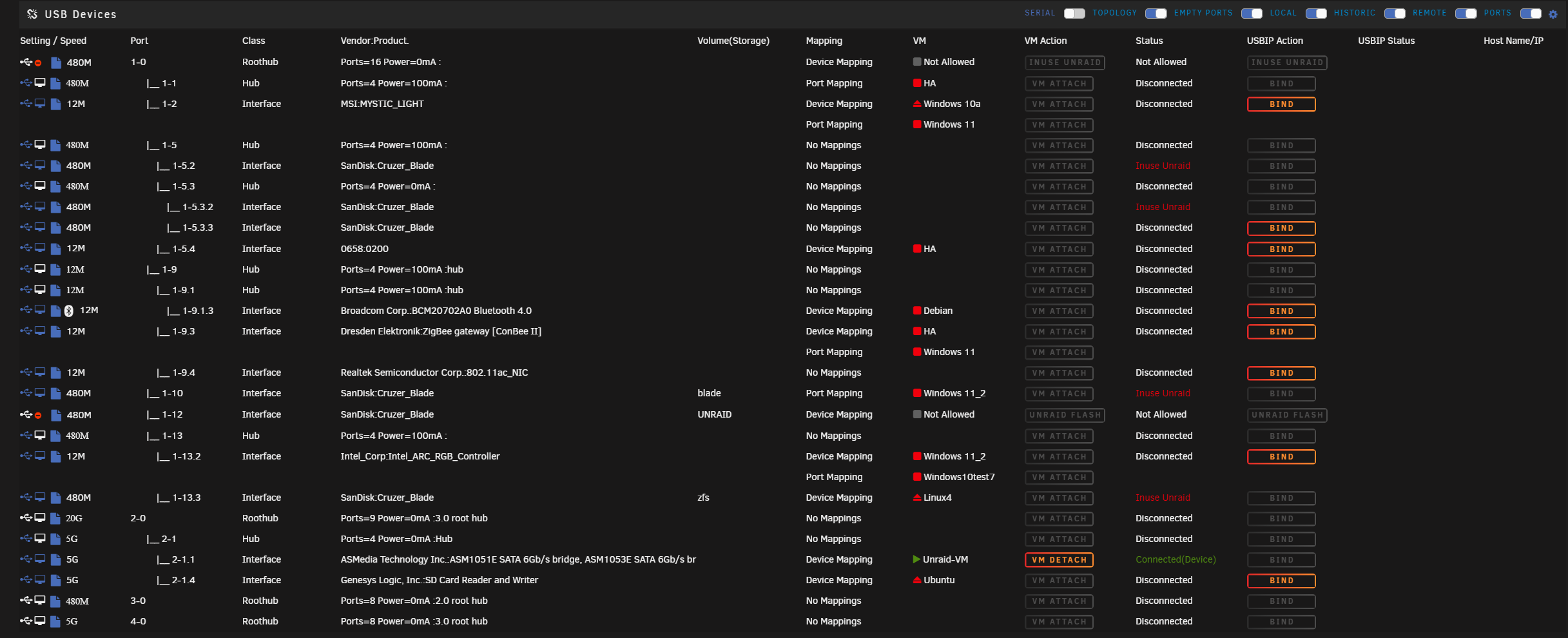

So the USB device is remove from the VM in the template?
How do you re-add the device to the xml. You could try using my USB Manager and see if that fixes you issue. Not sure why the template option does not work. If you can provide screen shots before and after, also a new syslog just after you start the VM.

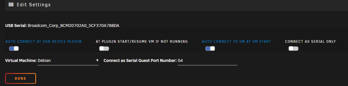

Example settings below for a USB Bluetooth device. If you use this method you dont need to have in VM template.

In the meantime I also installed your USB Manage and it looks like that has solved the issue. I have attached my USB devices to the VM only through the Manager now and the connection is correctly being established even after reboot.
Thank you very much for your kind support and the development of that great tool! :)
