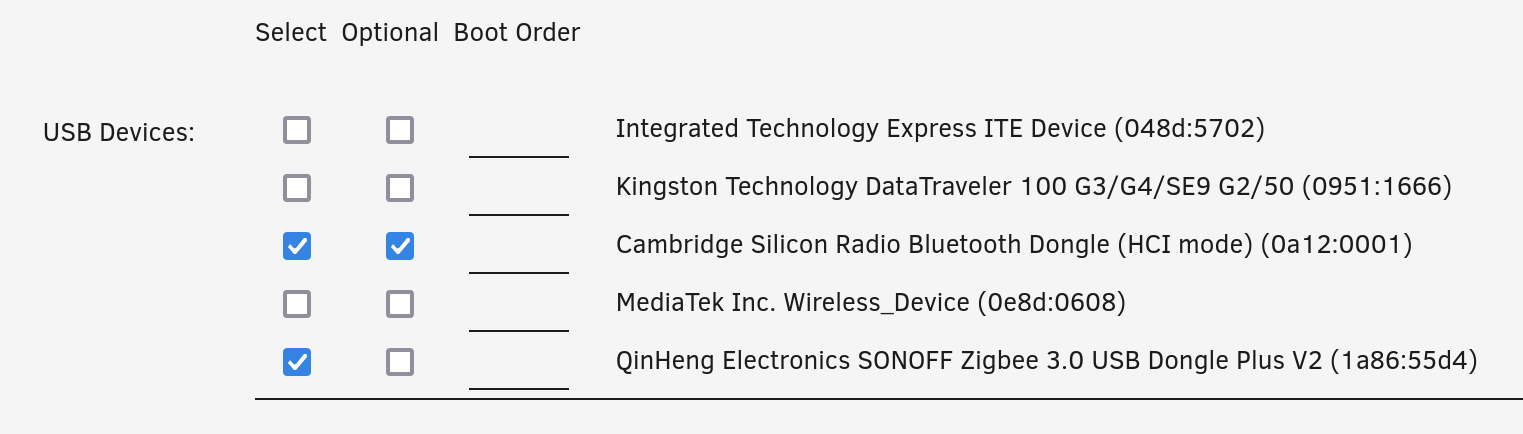

  2. The device is still visible but unselected in the GUI after reboot or array restart. There is also a strange phenomenon with that editor that always applies the "optional" tag once I save and refresh the page. Here is what the XML looks like: <hostdev mode='subsystem' type='usb' managed='no'> <source startupPolicy='optional'> <vendor id='0x0a12'/> <product id='0x0001'/> <address bus='1' device='2'/> </source> <alias name='hostdev1'/> <address type='usb' bus='0' port='3'/> </hostdev> The optional-policy seems to apply the following rule (accoding to this post): No idea if this is relevant for this issue. --- In the meantime I also installed your USB Manage and it looks like that has solved the issue. I have attached my USB devices to the VM only through the Manager now and the connection is correctly being established even after reboot. Thank you very much for your kind support and the development of that great tool!
  3. Maybe I should add: The dongle is working flawlessly in my Home Assistant VM once I reassign the adapter in the VM configuration after system reboot. The issue is that it always reverts back and removes the dongle from the selected devices once the system reboots or the array is restarted. Both my Zigbee Dongle as well as a USB soundcard I tried the other day are being applied permanently and presist in the VM configuration even after reboot. The issue thus appears to be somehow specific to the bluetooth dongle. I just don't get why the selection of that device resets all the time. Since it does also occur after restarting the array, I don't think that it is related to something like the USB power management, boot order or something. Do you think excluding the device from the host is the solution here?
  4. Hi all, I have a problem with the USB passthrough to a Linux VM (Home Assistant). My Bluetooth dongle, a Cambridge Silicon adapter, is always being unselected in the VM configuration after I do a reboot of the server. I have a Sonoff Zigbee dongle which works just fine. It is selected via the same procedure. I have already tried switching the USB port and connecting the Bluetooth dongle to the same controller as the Zigbee dongle. Unfortunately, the result remains unchanged. The device is listed as "(HCI mode"). Does this play any role in this case? Moreover, I have noticed that once I apply the settings in the VM config and then refresh the page, both main and optional are checked in the menu, altough I only selected the device only inside the left column in the first place: Any idea why this is happening? Appreciate your help! Kind regards
