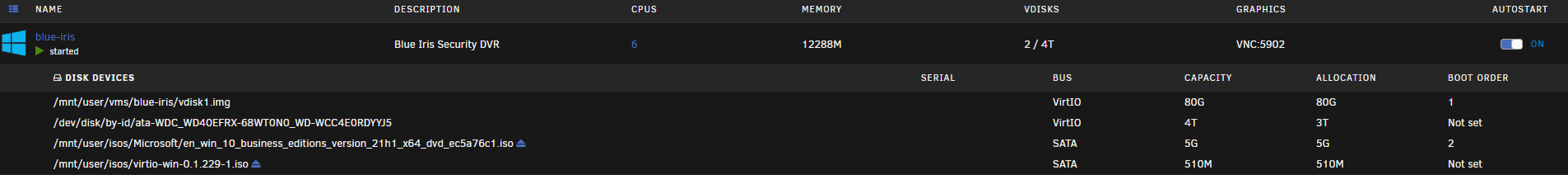

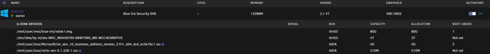

I have 3 VMs on one of my unraid servers and after an upgrade to 6.12.8, none of them will autostart after a reboot. Not sure what is going on or how to begin diagnosing it.
Dockers auto start as configured, the VMs, though configured to autostart, do not.
Manually starting the VMs after boot works perfectly fine.

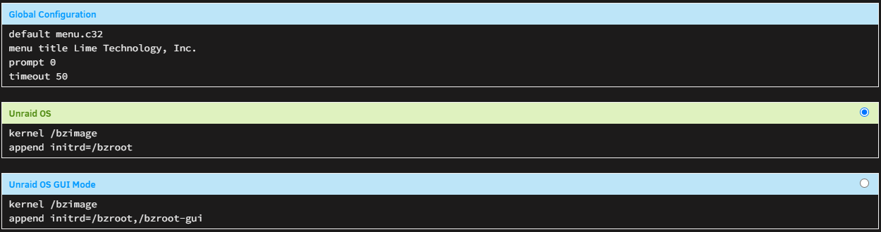

I don't have any references in the syslinux config like we used to do.
The only passthrough I even have is a spinner hard drive I am passing to a BlueIris server, which seems to be working perfectly.
No other hardware passthrough going on as far as I can see.

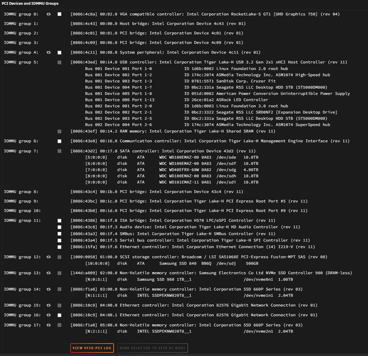

Looks like you had a 2060 bound to vfio on 1:00.x which is no longer there. and a device at 09:00.0 if you don't need them delete the vfio file and next reboot you should be ok.

If you are not using PCI passthru you can either leave blank or remove. Changes where made to stop autostart if vfio binding fails as could indicate PCI numbers have chaged due to hardware removal/additions etc. If the VM autostarts and now as the wrong device is allocated to the VM due to PCI number changes it could lookup or crash the host.
Before
07:00.0 VGA Card(Passthru to VM)
08:00.0 Disk Controller(Unraid)
After
07:00.0 DIsk Controller(Unraid)
If the VM autostarts the diskcontroller would be allocated to the VM and all the Unraid disks would not been seen on the host as a simple example.
