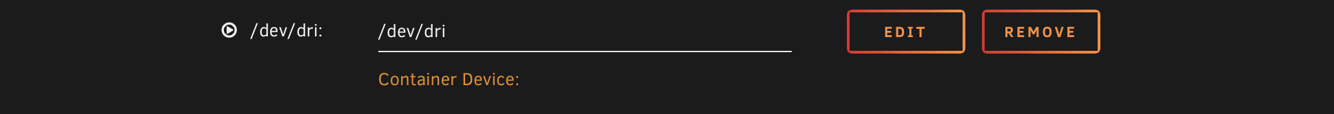

Has anyone gotten an intel iGPU to work with the immich docker from the community applications? The immich docs state it should work but i havent been able to figure out how to get it working. I added a device to the docker with it mapped to /dev/dri is there something im missing?

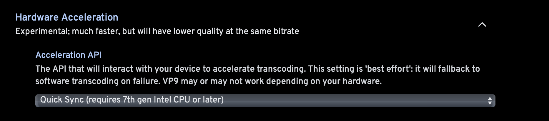

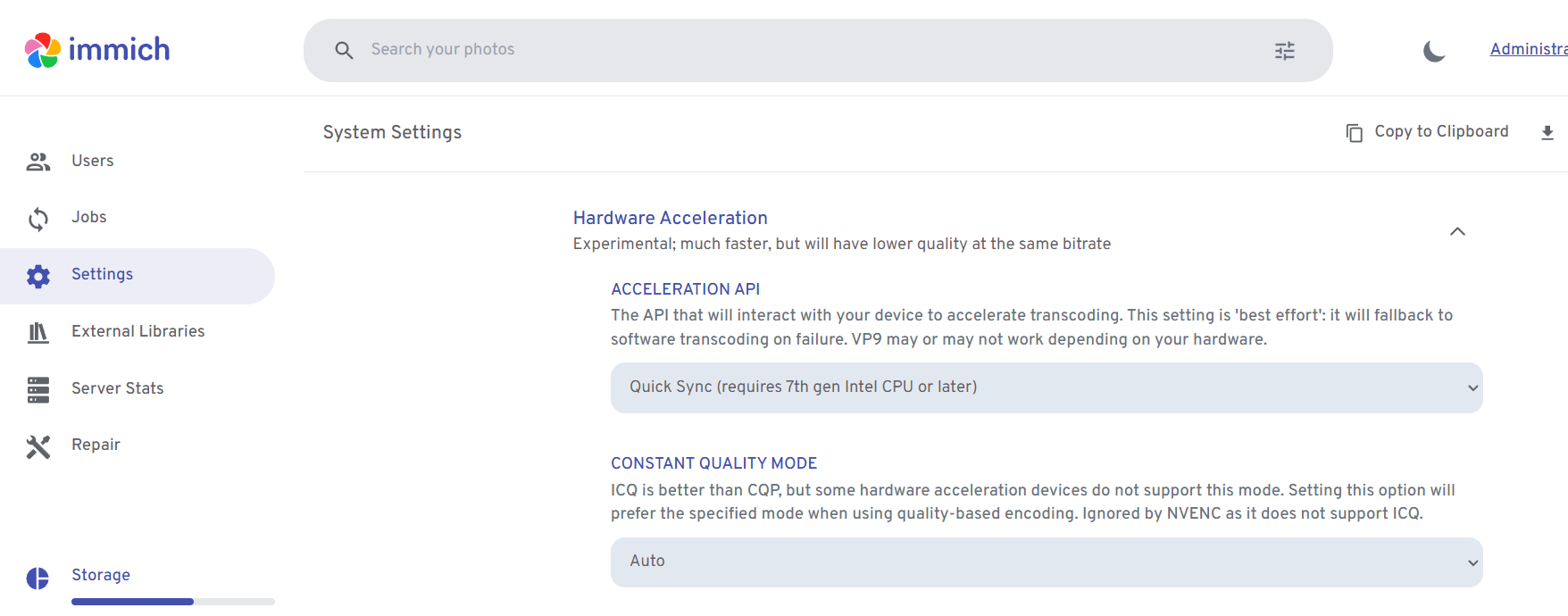

Did you turn change the hardware acceleration setting on the immich administration settings?image.thumb.png.b284fb25327c8c537651c3b60e2efa8c.png
It is set to intel. But immich still doesn't seem to be using the iGPU

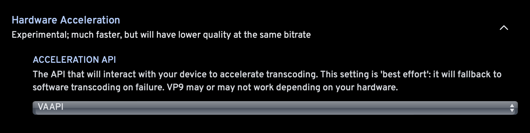

The quick sync setting seemed to generate ffmpeg error. I'm trying VVAPI:

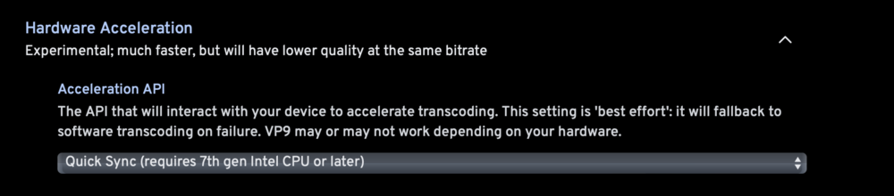

I switched to a different server but QuickSync seems to be working for me:
Passed the GPU through.

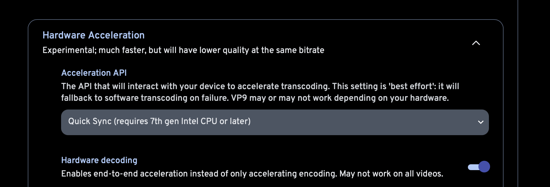

Also in immich I have:
