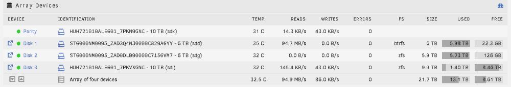

Share Settings (Allocation Method = High-water):
Is the mover trying to move only to Disk 1 (because of the "high water" allocation method)?  But fails because Disk 1 is below the 25 GB minimum free space?
Will mover try to move to Disk 2 or Disk 3, when high water allocation is no longer viable?
Should I choose a different allocation method?
The reason why the disks are not balanced, despite "high water" allocation, is because I have add disks at different points of time.

15 minutes ago, Jaybau said:
share cache full
It means the it's hitting the set share floor, i.e., the pool free space is less than the share's minimum free space.
The pool/array's free space is 8.61 TB, and the share floor is 25 GB.
What is causing the error message?
That has nothing to do with the array or mover, some share with cache=yes is bypassing the pool when new data is written to that share (not from the mover) and logging that warning,  because it hit the minimum floor setting, cannot tell which share based on the warning, but if you look at the time stamps you may be able to know to which share you were writing to.
