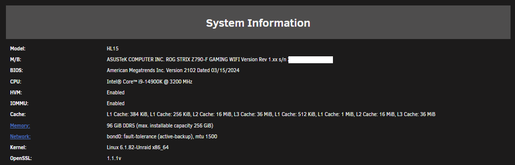

I have also been experiencing similar issues. hoping to see if you find resolution. I was also told to test ram, tested both together, then seperate for over 24hrs each time. No errors only passes.
Did you issues start about 2-3 weeks ago? I Also have a Z-790 motherboard, but ASUS. Is your ram DDR5?
I believe my issues started more than 3 weeks ago. I turned rsyslog on to start having logs saved around March 1st, and my problems started 1-2 weeks before that. In total, about 4-5 weeks ago.
Yes, my RAM is DDR5. It is some cheap G.Skill RAM that runs at 5600 with XMP but 4800 with XMP turned off. I've tried with XMP enabled and without, both ways still causes the hang. Everything was working great for about 1 month straight after I initially set up the server, then it started crapping out.

WOW, even the same cooler as me lol. I have a HL-15, its a mini-storinator, but otherwise almost identical builds. I am temped to try and squeeze an AIO cooler in there somehow.
