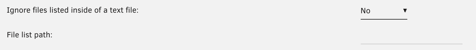

The Mover Tuning plugin allows setting exceptions
Thanks! This is amazing - even when Unraid is not doing something, there is a plugin for it :).
I guess this is what i need:
Believe so, but never used it myself
I will check hopefully tomorrow and report here.
So it actually works like a charm. All you have to do is to list files you want the mover to skip in a text file, and tell the Mover Tuning plugin to use it. In my case seems it was enough to list:
