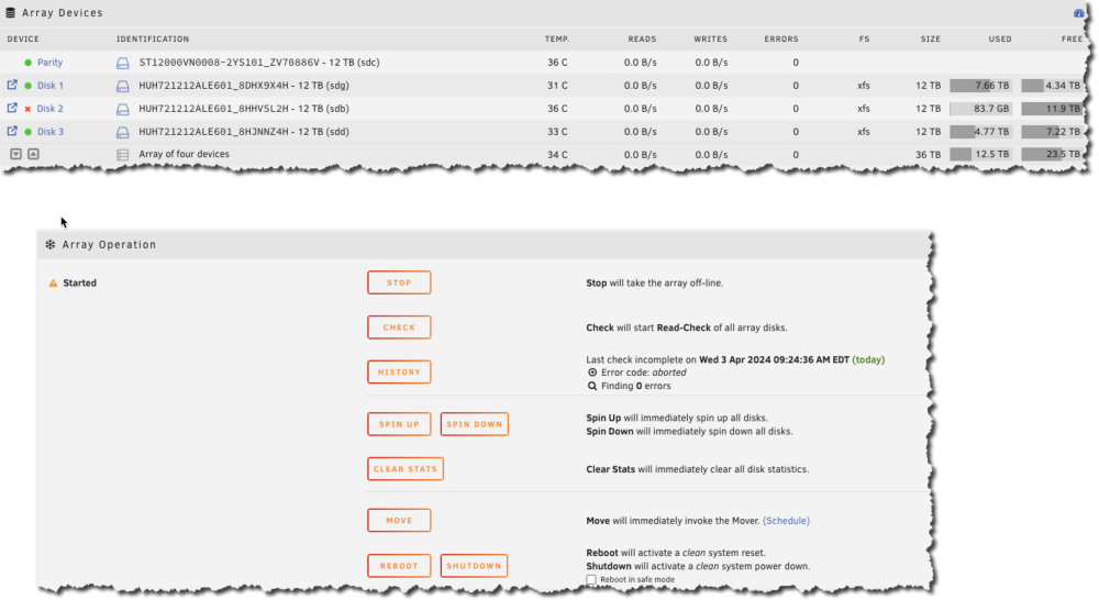

Situation
3 Disk + Parity Array
  1. One of the disked 'failed'.
  2. I believe this is due to a SATA controller issue.
  3. I move the failed drive to another controller.
  4. The drive showed as unusable, but could be formated
  5. formated the drive
  6. drive is formated, but still a red X beside the drive and no rebuilding of the data.
Solved by MAM59
The procedure is
https://docs.unraid.net/unraid-os/manual/storage-management/#rebuilding-a-drive-onto-itself
But... you NEVER format a drive you need to rebuild, there are plenty of warnings about that. Now you can see the emulated drive is empty since it was freshly formatted. Hopefully the data is still on the actual drive.
What is the exact situation now, is the drive connected, is it assigned to the array? Do not do anything else.
Edited by Kilrah
If formatted or not, does not matter.
If the emulated drive still shows the old contents, follow the mentioned procedure PRECISELY and the old drive will be rebuild in place. Nothing lost.
Screenshot shows he formatted the emulated drive, so nothing there anymore.
Oh🥴
Too bad... Use the Backuo.
7 minutes ago, MAM59 said:
Oh🥴
If it was only the emulated drive that was formatted the physical drive may still have all its data intact.
Diagnostics so we can check the current state of things is probably what is needed now.
Thank You ALL
How do you know that it was the emulated disk from the screen shot?
Also, all of the data is backed up. Trying to get the server stable from used parts, so at this time, it is a clone, and a learning box.
Edited by kcossabo
The array shows the emulated data until a rebuild is run.
But @itimpi is right, the physical drive could still have the data. In this case you have to use a different procedure. But first check the drive with unassigned devices.
The drive does have the data. Interesting. I formatted an emulated disk. Neet.
Yeah, one nice feature of UNRAID: even if you do it wrong, usually there is a way to recover without loss.
So in your case, you need to delete the array config and reassign all drives like before again. parity needs rebuilding (because of your format action)
read about "new config" in the manual. it is the same like you did at the beginning.
Hint: write down the serial numbers of the drives before. Use the same ones for the new config (don't put a data disk as parity or vice versa!!!)
When using New Config I nearly always recommend using the option to keep all assignments so serial numbers do not need re-entering.   You can then make changes (if any are required) from that position.  Minimises the chance of error.
Thank You all.
