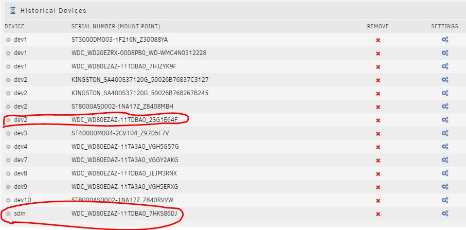

One thing that I did notice, was that the drive descriptors had changed - the drives were showing up in the historical devices, but with a different identifier as shown.  Here they are in the array:
Disk 6    WDC_WD80EZAZ-11TDBA0_2SG1E64F - 8 TB (sdc)    26 C    1298    528    0    xfs    Unmountable: Unsupported or no file system
Disk 7    WDC_WD80EZAZ-11TDBA0_7HKS86DJ - 8 TB (sdh)    26 C    1299    528    0    xfs    Unmountable: Unsupported or no file system
Here are how the drives are shown in the historical devices:
dev2    WDC_WD80EZAZ-11TDBA0_2SG1E64F
sdm    WDC_WD80EZAZ-11TDBA0_7HKS86DJ
Could this change in the identifier be the cause of the inability to properly mount the drives?  Any help would be greatly appreciated!  I have attached the diagnostics from my server.

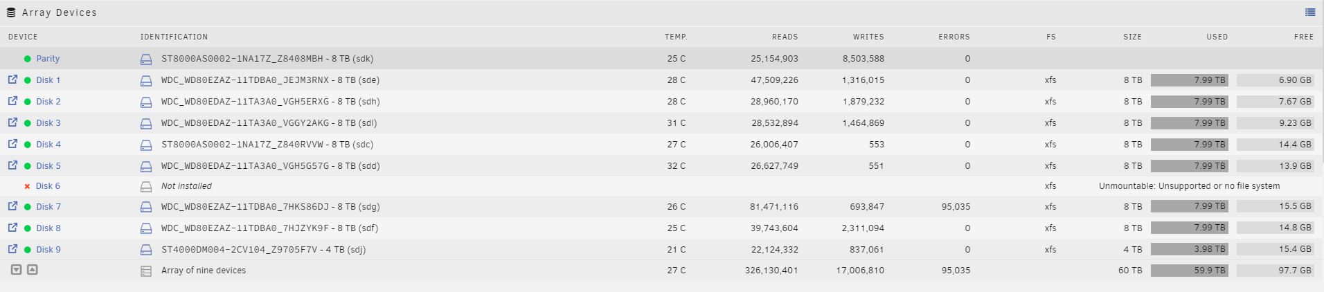

The picture entitled 'Primary-Drives-04-02-2024' shows the drive info just after Disk 6 was removed - it also shows the Disk 7 errors that accumulated when I tried to pull data from it

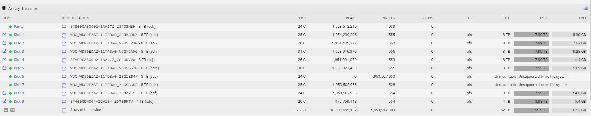

The picture entitled 'Capture1' shows the new drive identifiers and the 'Unmountable: Unsupported or no file system' errors
The picture entitled 'HistoricalDevices' as they are currently shown.  The 2 problems drives are circled in Red

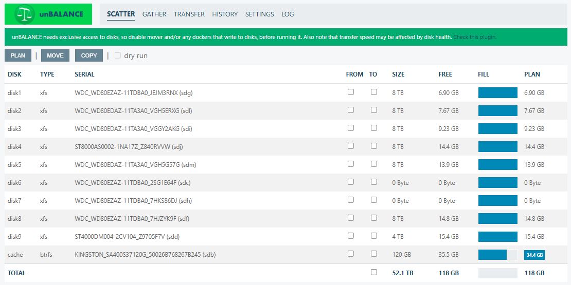

The picture entitled 'Capture3' shows the drive descriptors as seen by the unBALANCE plugin - taken before the rebuild

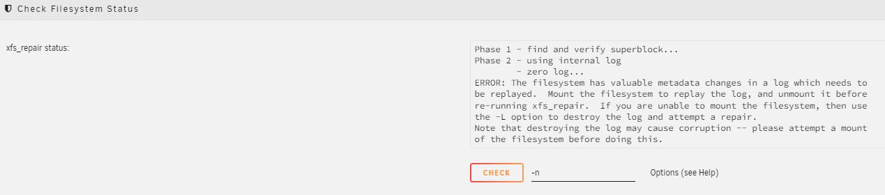

When I try to run it on Disk 7, I get the info as shown in the attached image - I did not proceed with running anything on Disk 7 - I would like to get some feedback on the following question first:

18 minutes ago, Xandros said:
Should I not bother with trying to get Disk 7 back online
Not sure what you mean, the disk is already online, only unmountable, you should just use -L, basically is the only option, and usually it's a not a problem.
