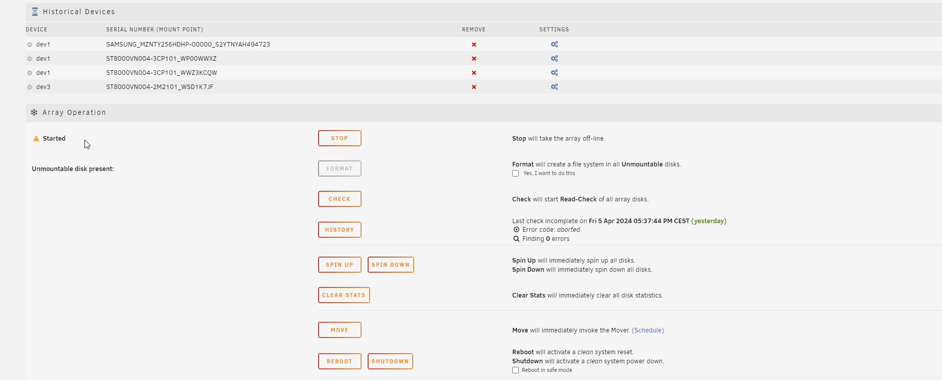

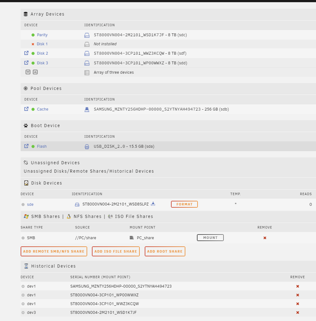

I'm also attaching a screenshot of the `Main` screen. I have 4 disks in total. 1 parity and 3 data drives.

Disk1 is still logging a lot of errors, but it could a disk problem since it's not generating a valid SMART report, swap cables with a different disk.
Then check filesystem on the emulated disk1, run it without -n, and post new diags after array start.
