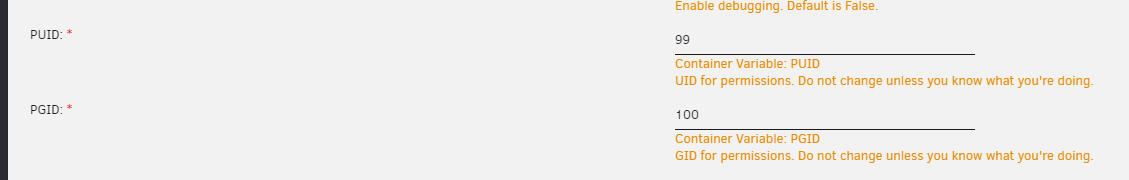

Well i'm confused here. The docker settings of TubeSync is just 99/100 ?
And I already did the Tools => New Permissions a few time to just be back to that state ?

Those are correct to get the user and group but is not sufficient.   Is there anything that mentions Umask which is used to get the correct permissions.
Here's the whole setup for the container, nothing about Umask / Groups etc :(
Sorry for the bother
Then you would need to get the author of the container to provide a way to set permissions correctly.   Typically this is done by exposing the unmask setting in the container
Yep, sadly, I can't find anything more :(
