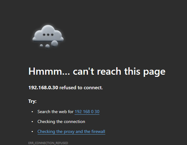

3.  Attempting to connect via ip is unsuccessful (https and http)

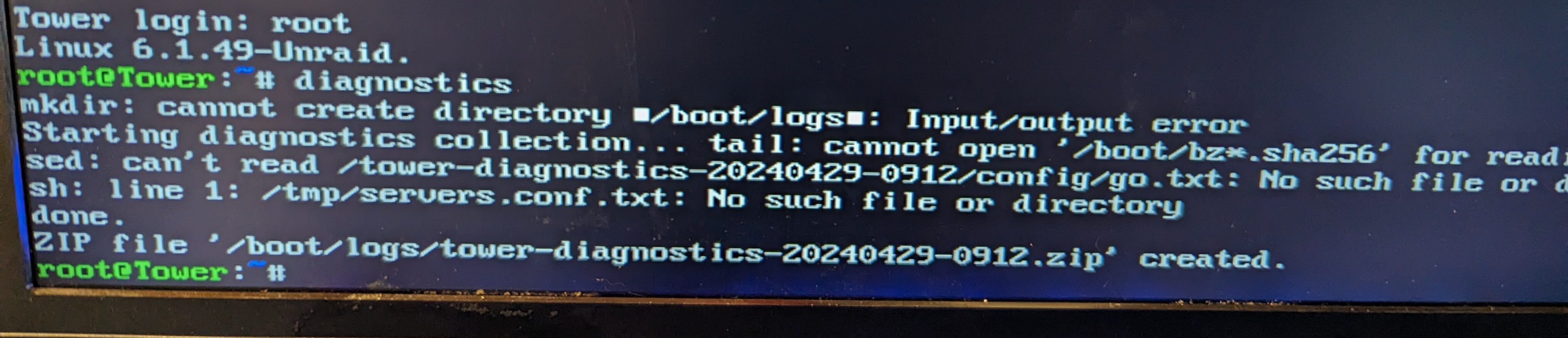

Having issues getting it to actually write a diagnostic fail. See picture. I'll post the last diagnostic and I'll attempt again.

The screenshot shows that you are having a problem with the flash drive (/boot is where it is mounted).

No idea - just that you were getting an input/output error.   It could be the flash drive starting to fail or that it has dropped offline for some reason.   It would do no harm to plug it into a PC/Mac and check that you can read and write to it successfully.
