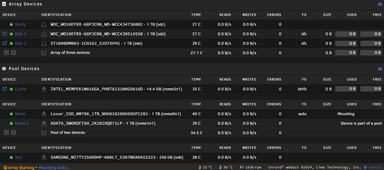

Finally after reboot the server was stuck on Mountunig array.
I connected the monitor and saw an error while mounting:
Unraid login: VERIFY3(size <= SPA_MAXBLOCKSIZE) failed (24155136 <= 16777216)
PANIC at all.c:188:abd_alloc()
Even though I have many pools, I finally found out that the problem is with the ZFS pool consisting of 2x 1TB disks.

When disabled array tries to execute the command:
zpool import -o readonly=on nvme
I have the same symptoms as when staring array (VERIFY3 ...).
