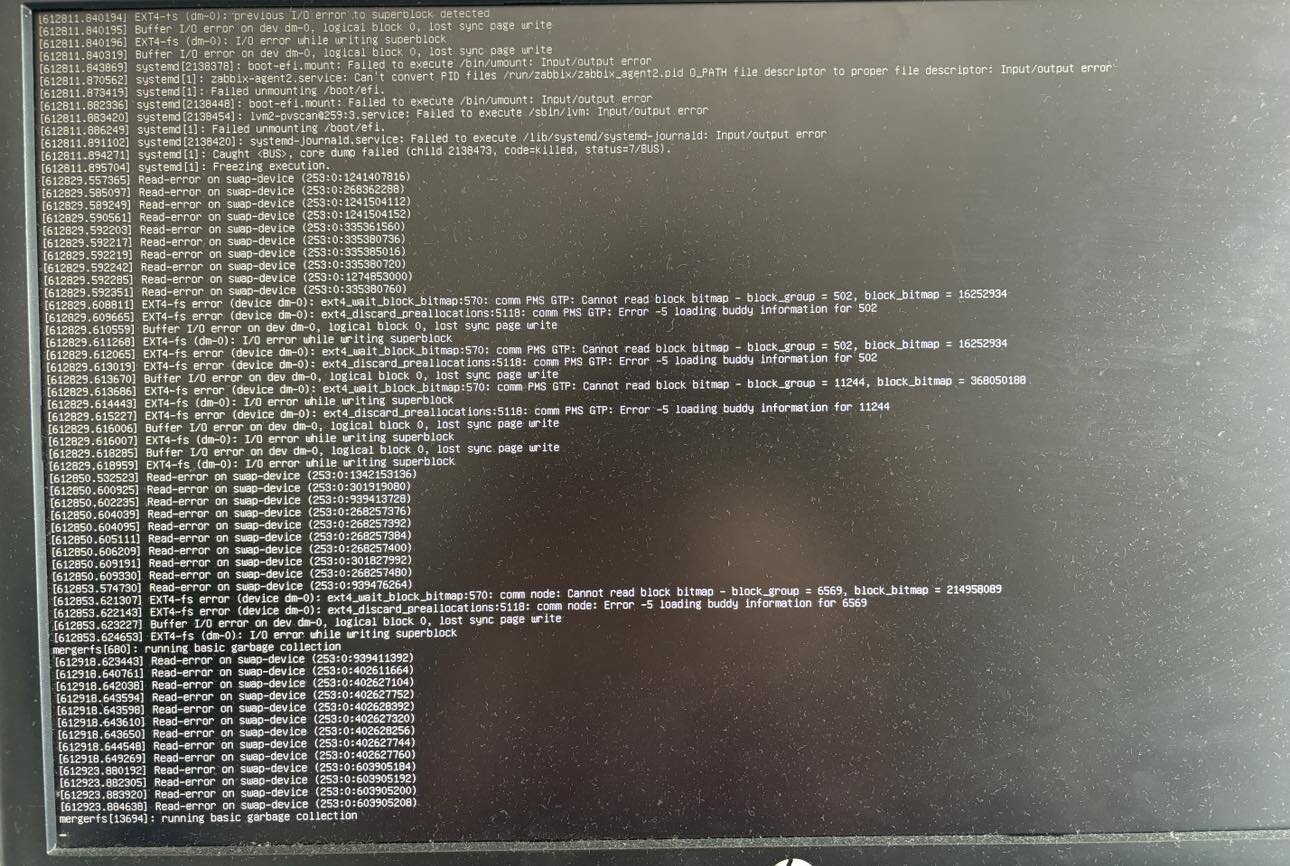

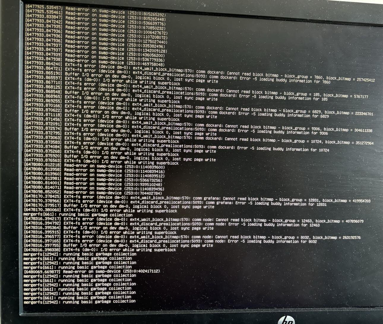

I want to thank you to post your result of your test as I have the same problem as you since one year.
I have a NUCPRO12 with the SSD Samsung 990 pro as my system disk.
About once a month since one year (it's very random) , my server crashes unexpectedly. The crashes are often accompanied by a flurry of I/O errors, EXT4-fs error, Buffer I/O error on dev dm-0 and out-of-memory (OOM) killer messages, indicating severe issues.
I primarily use the server for containerization (running Docker containers) and Plex for media streaming.
What I've Tried:
fsck: Verified all partitions with fsck, and they are reported as clean.
smartctl : I ran smartctl on the system disk, and no errors were found. The disk is relatively new (1 year).
Memory Upgrade: I upgraded the RAM from 16GB(2x8) to 32GB(2x16) even though my previous setup never exceeded 40% of its memory usage.
I’ve already cleaned the RAM, re-seated the disks, and ensured everything is properly connected, but the issue persists.
Post-crash log issue: After I reboot the server following a crash, I’ve noticed there’s a gap in the logs. It seems like no logs are recorded from the moment of the crash until the server is rebooted, making it difficult to diagnose the exact cause.

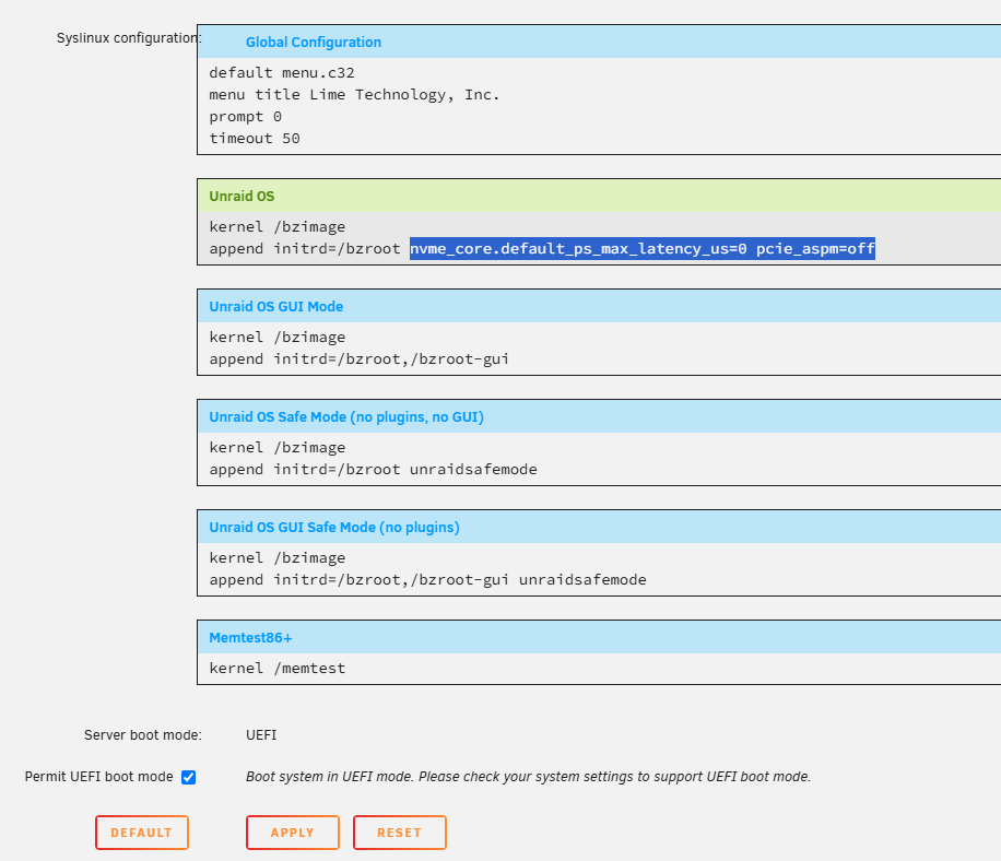

I had the same problem at the start of the year, I swapped my old SSD with a new Samsung 990 Pro (2TB) using a btrfs cache pool with RAID1. I think It was already happening using Unraid 6, but I was updating Unraid to 7.0 at that same time, so I couldn't remember exactly.
It happened 2-3 times at intervals of a week. I was using a cache pool with btrfs filesystem and a docker image with a btrfs image. Every time this happened, I had to hard reboot the server (complete shutdown and restart using power button, restarting directly wasn't working). I had to completely rebuild my docker image, because it wasn't able to mount again after the reboot. After the second time, I was really frustrated.
I found this thread and the added the following config in the syslinux.cfg:
For an updated syslinux config, checkout the updated post (added "pcie_port_pm=off")
append initrd=/bzroot nvme_core.default_ps_max_latency_us=0 pcie_aspm=off
I also changed the docker image from btrfs to xfs. It is working fine right now, I really hope this doesn't happen again, but it's looking good for now.

I have added now "pcie_port_pm=off" to the syslinux container resulting in the following line:
append initrd=/bzroot nvme_core.default_ps_max_latency_us=0 pcie_aspm=off pcie_port_pm=off

Did you try this:
1 hour ago, JorgeB said:
Did you try this:
Yes, but unfortunately, it didn't resolve the issue. I've also come across posts from others experiencing the same problem, and sadly, it didn’t help them either.
