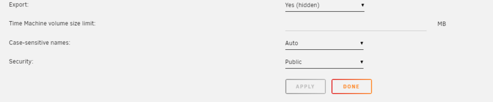

under share setting you can specify where you want file to live:
under smb security setting is how it is sahred:
with tips and tricks you will get a ? icon over the black text of a setting to assist you with your desired options:

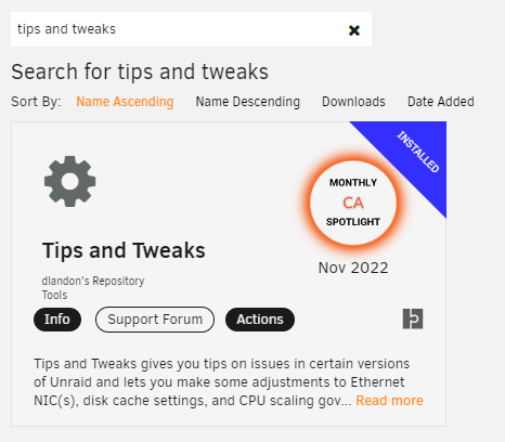

There are many applications and plugins in the community app store!
My recommendations are:
CA Auto Update Applications > used to update dockers and plugin on schedule
Docker Compose > add docker compose to unraids docker system
Dynamix File manager > A FCP tool for latter if needed- web UI file access and management
Dynamix System information > Linux system info dump to get hardware details
Enhanced log viewer > adds color and helps filter log
Fix Common Problems > Squid Common scan and general fixes
Tips and Tweaks > General Setting information
User Scripts > pearl/cron scripting when necessary for manually overrides and run sh scripts on schedule.

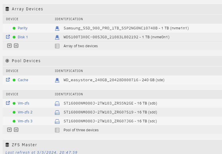

For your setup, I would recommend a traditional unraid array with parity. wiping the disk and using them all for unraid.
2x 16 TB drive as disk 1 and parity with the nvme as the single cached drive.
I would have vms if you have them on the cache drive and domains folder changed to the cached drive so dockers and vms live on the nvme drive.
You can then use plugins / user script terminal tools to copy the data to the array for backup.
I would then point you towards dockers. and run a plex docker. If you want your ubuntu os back, you can reinstall a vm and run Ubuntu on top of unraid.

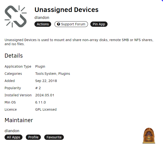

you can add 1 disk to disk 1 and nvme to cache disk then use unsigned devices to copy the data over and later assigned and format the other disk drive.

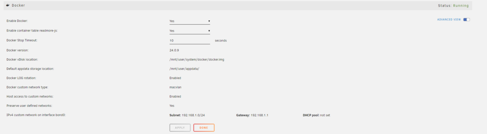

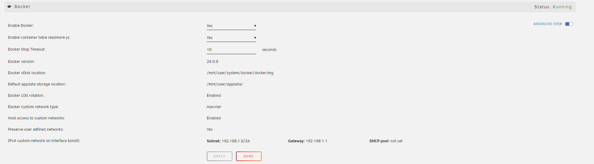

Then to turn on Docker:
To use docker, you must enable it first. (same with VM) Both VM and docker must be off to edit your netwrok settings!
webui > settings > docker
top right advance toggle switch
My recommend settings:

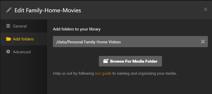

Then with the Linux io template I just need to add /mnt/user/dlna and later tell Plex to go to xyz to load content for tv / movies / etc.

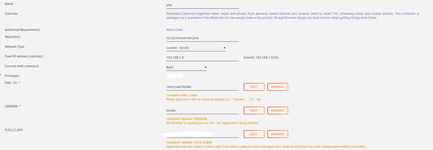

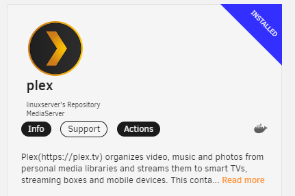

So back to apps search plex and install, you will then be greeted by the template
I recommend using a static lan ip. so set network type to Custom bond0 and pick a ip where you want your plex server to be at.
Then specify the file path to your data. In the docker, the media will be at /tv/xyz sub folder

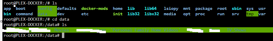

 if you hit edit:
as you can see my path is /data, so data is symlinked... my unbraid data in the dlna folder becomes the data folder in the docker.
Confirmed later via console to access the terminal windows of the docker cd /data ls
later added to plex:
