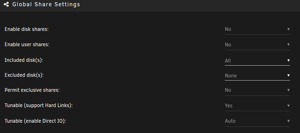

Thanks @JorgeB.  I don't use the traditional unraid shares.  I have them turned off as per the screenshot below.  If I'm understanding what you're saying, I could do it, (use a raidz1 vdev and a raidz2 vdev in the same zpool), via terminal and it would work?  Could I automate the import in the go file so the mixed vdev zpool is online after a reboot?  Do you happen to know if this would work in the upcoming Unraid 7?

It should work fine if used outside the GUI, you just need to do
zpool import pool_name
