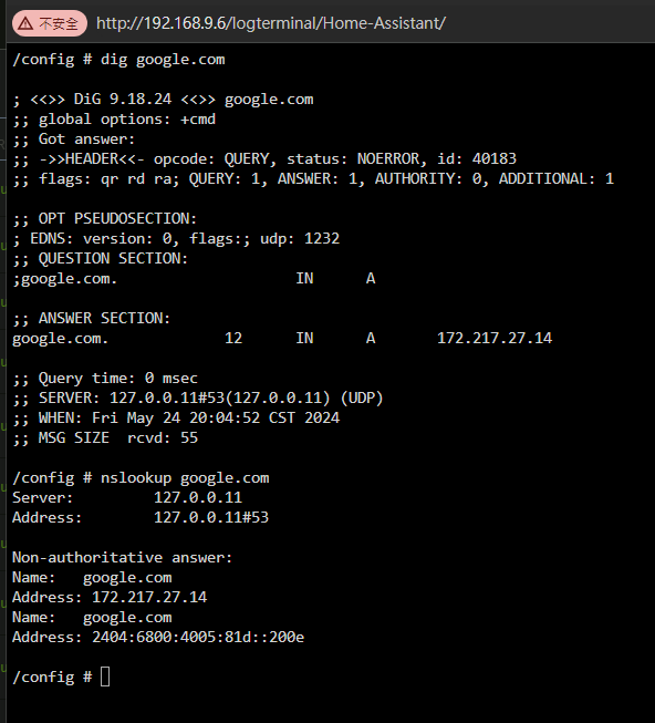

Your dig result haven't answer session, anyway depends on docker itself, my HA docker have dig and nslookup. The DNS translate also 127.0.0.11
I am not sure how to diagnostic if DNS resolve not work in docker.
Edited by Vr2Io

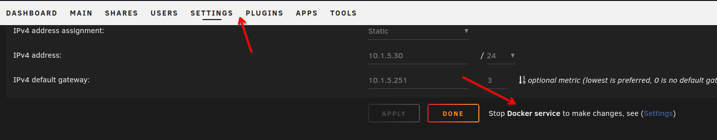

Now, I can't make changes on network. Because docker is stopped, but it's still saying that has to be stopped for changes:

3 minutes ago, SeRiusMe said:
RESOLUTION IN CONTAINER IN VLAN5 WORKS IF DNS OF VLAN5 IS FORCED INSTEAD OF THE DEFAULT (10.1.3.251)
Interesting, but don't know why 10.1.3.251 not work, because eth0 no gateway ?
This also the difference on my setup, my private DNS ( Pihole ) was on eth0.2, not the router or public DNS. But my private DNS endup also lookup on a public DNS.
If I change the order for the DNS at the host and put the 10.1.5.251 at the top, The container at VLAN5 resolves DNS. BUT ALSO OTHER ONE IN VLAN2. (But it takes a while, I suppose because is trying 10.1.5.251 first?

# nslookup google.com
Server:         127.0.0.11
Address:        127.0.0.11#53
Non-authoritative answer:
Address: 142.250.201.78
Address: 2a00:1450:4003:803::200e
WTF??
No, by now there's no interface with an empty gateway.
DOCKER:
IPv4 custom network on interface eth0:
Subnet: 10.1.3.0/24 Gateway: 10.1.3.251 DHCP pool: not set
IPv4 custom network on interface eth0.2:
Subnet: 10.1.2.0/24 Gateway: 10.1.2.251 DHCP pool: not set
IPv4 custom network on interface eth0.5:
Subnet: 10.1.5.0/24 Gateway: 10.1.5.251 DHCP pool: not set
Same on me. But I have Adguard installed on my router machine. Listening on port 53 and I changed the routers DNS server to 53530. Adguard resolves to router and router to upstreams.
Then it look like no problem on docker system now.
All DNS server must accessible by all subnet, client will randomly resolve on all DNS server according the setting, not 1st one then 2nd then 3rd.
Edited by Vr2Io
