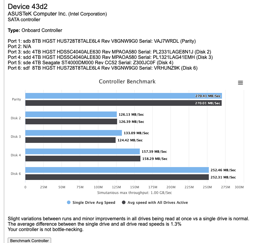

Okay does anyone actually have a remedy with the WD drives? I have a similar issue with 52TB across 13 drives in mixed environment of 7200 and 5400 speeds. Is it possible to go around the parity/data rebuild from a failed drive? Can these checks be done separately and what method of order if so.
You are running a SAS3 controller, use SAS3 drives for your parity. Right now you have a ferrari controller hooked up to moped parity drives.

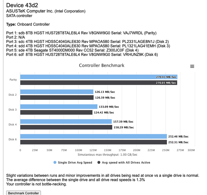

Here is a ss of my disk speeds
I switched out the parity disk, but the parity check speed is still very slow

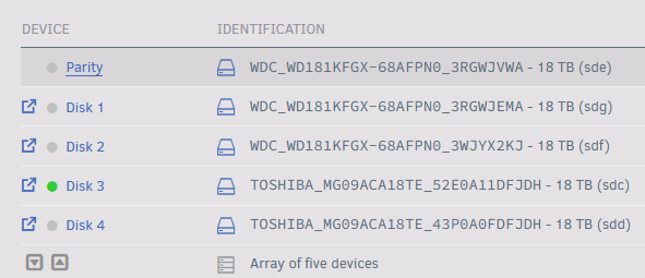

I switched the parity drive but the speed is still very slow (see pictures above)
Disks look OK, also run the controller benchmark in the container and post that.
do you mean this?
Post the test results, looks like this:
took me a few minutes to find how to do that
controller-benchmark2.thumb.PNG.0ed891713266bea97d4b0e0adc77930a.PNGcontroller-benchmark1.thumb.PNG.a13224265eba2edbe162e3e9323d5faf.PNG
it kinda makes sense now, somehow. Is there a reason for the low avg. speed with all drives active?
It shows the problem, but doesn't really make sense, the disks are connected directly to the HBA right? No enclosure/expander?
preclear is running atm on sdc (started it long after I started the parity check), but even if it isn't running, the speed never exceeds 60-80mbit
all connected via the HBA only
Edited by wulperdinger
If there's no enclosure I would suspect an issue with the HBA.
