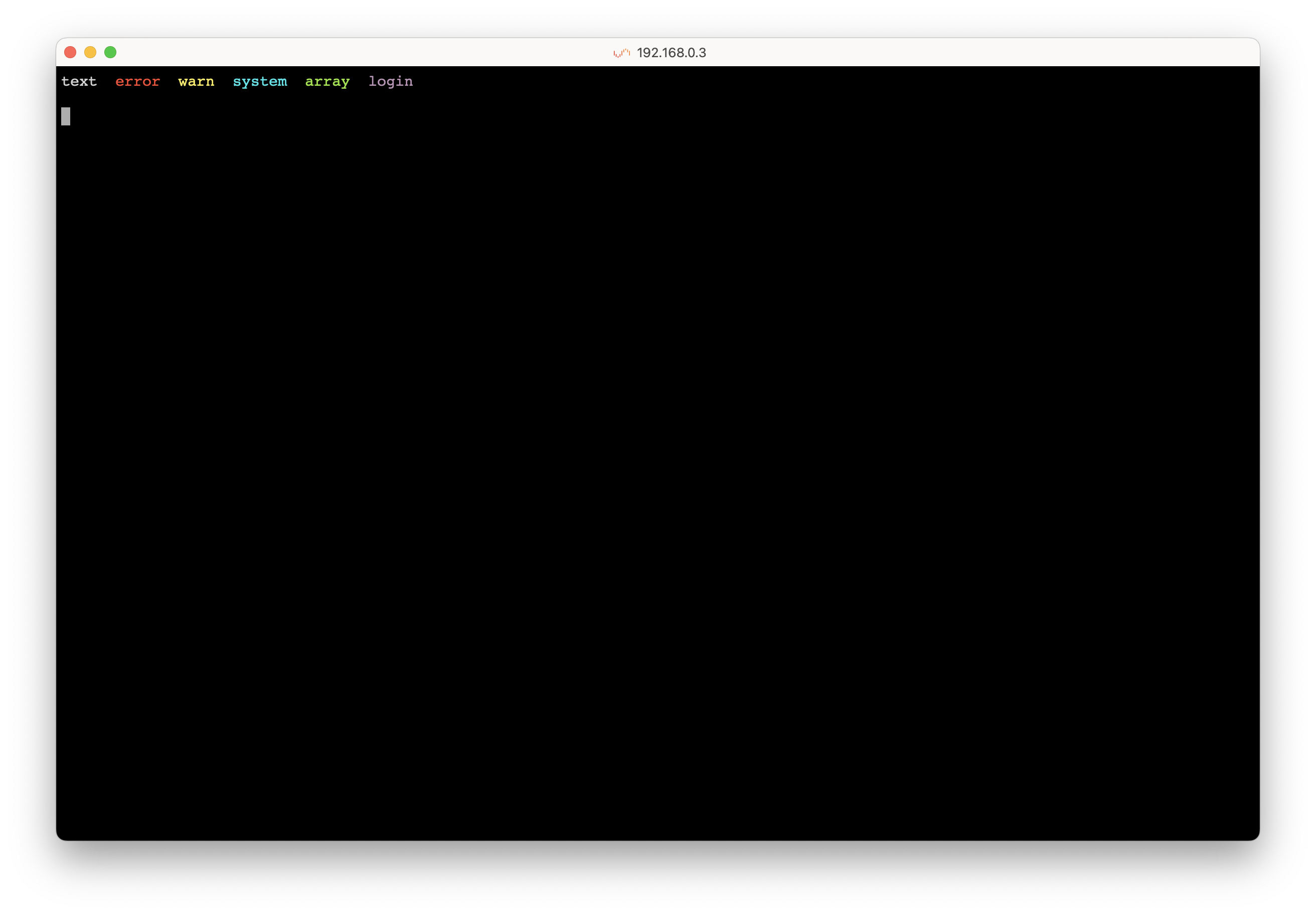

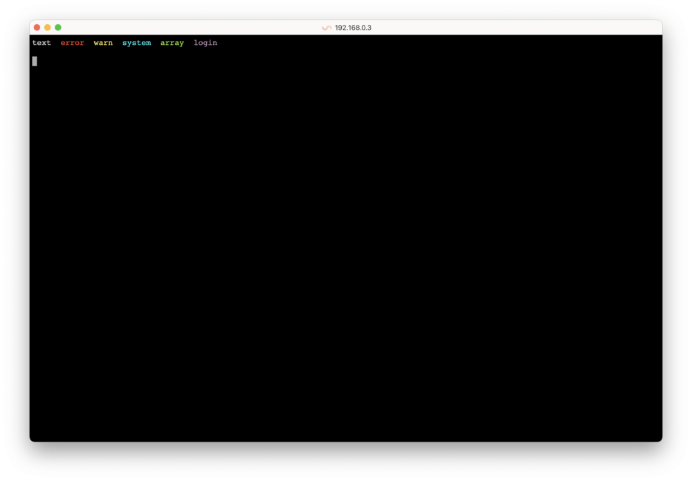

May 22, 20242 yr Hi, I've had a long term issue where my system logs are always blank / empty. i.e – Tools > System Log shows nothing – /boot/logs contains only diagnostic files I did enable the Unraid syslog server this morning, and pointed Unraid to log to its own IP, but no log files have been created in the share. I haven't sought to fix this in the past because Unraid has been very stable, and always assumed a future update would fix it. But I'm now having few random lock-ups and would like to understand why. Thanks. unraidrack-diagnostics-20240522-1005.zip
