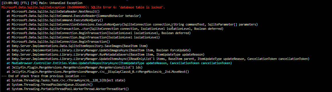

Hello, i'm having this issue with docker container giving the error message: SQLite Error 6: 'database table is locked'. whenever the cache drive gets full, however i'm a bit confused on how things work i have on my data share the primary storage set to my cache then the secondary storage to my array; once the cache drive gets full isn't it supposed to use the secondary storage? why such an error happens? and what can i do to fix it?
after running a mover the error goes away btw so i know that is indeed the problem since i've been having it for a week straight.

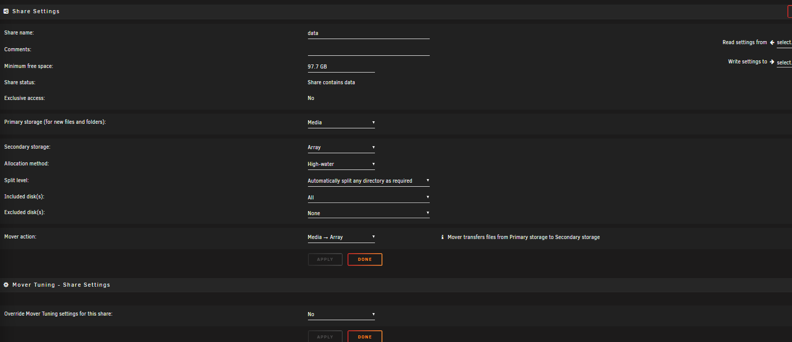

It will start overflowing NEW files to the array once the free space on the pool falls below the value you have set for Minimum Free Space for the pool.   Existing files that are growing are never moved so you have to allow for that in the pool's Minimum Free Space setting.
You need to set an appropriate value for Minimum Free Space for the 'media' pool.

just found out why it wasn't working, was using a plugin called mover settings or something like that and it completely broke the mover, now it works fine. and thanks for the tip on the setting, it was already set to that on my unraid
