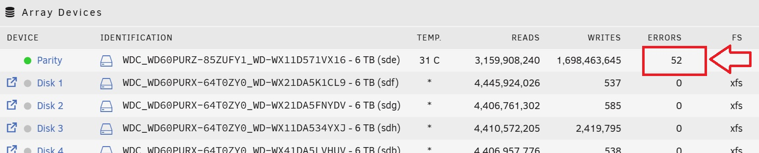

I have recently replaced my parity disk with one which only has 5273 hours of use. It has been in the array for about 2 months and suddenly has flagged up 52 read errors...
I have run a short SMART self-test and it shows no errors.
So, are these errors a hardware failure indication of the disk, or is it a software read-error?
I am just trying to work out if I need to replace the hard disk (again)... it is still under warranty so I should be able to get it swapped out OK.
Also, as this is a parity disk am I right in thinking there is no way anyone can recover any data from this disk alone as I dont want to erase/preclear it before sending it back in case it resets the error? I am 99.99% sure this is correct, but would just like someone to add the 0.001% reassurance ;-)

SMART log does show uncorrectable errors at the locations unraid couldn't read, so yeah that's a bad disk.
What's on the parity drive is indeed just garbage that means nothing in an array with >2 drives.

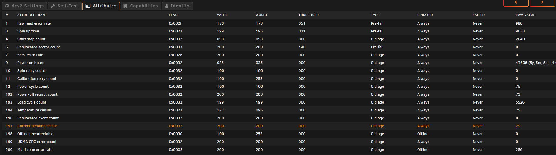

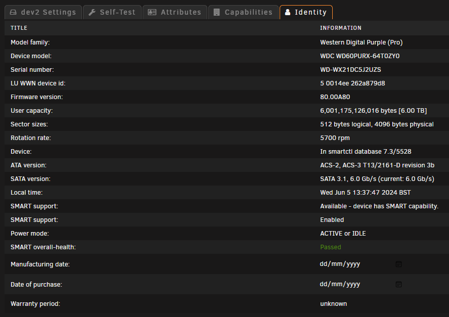

OK, when I went to lunch the disk showed - "self-test in progress, 90% complete", when I got back it said disk was spun down, spin up to get results... when I spin it up it shows "self-test in progress, 90% complete" - so am not sure if this is 'stuck'.
Attributes shows;
Identity shows;

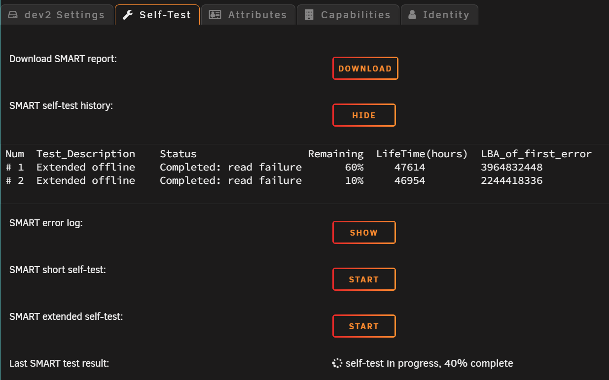

How long should the Extended SMART test take? Its been running for 8 hours now and hasnt moved from 40% in hours - it says its still running, but also says it failed at 60%;
Two tests failed, the disk should be replaced.
Thanks - that confirms the original error from the original host. Its now 16hrs into an extensive test and still says progress is 40%... so will bin it - thanks
