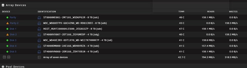

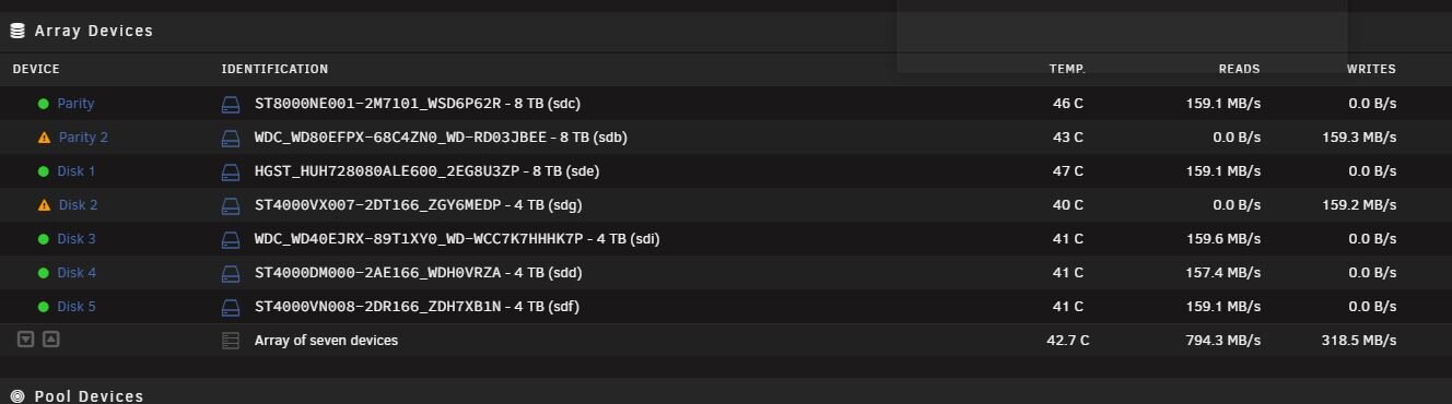

Parity 2 and Data disck 2 that is one of my better ones, its a seagate skyhawk 4 tb (that was i efford to buy when i started my unraid), that works fine with a very good speed.

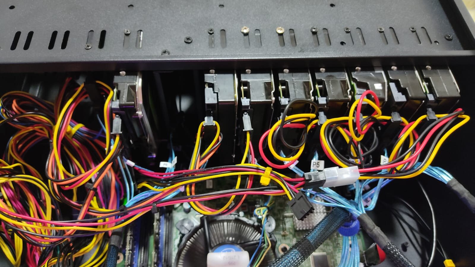

I dont know what to do now, i cant lose the data of this disk 2, can anyone help me to proceed to avoid data loss causes i think this two disks is perfectly fine but i dont know how to enable them again on my Unraid, i attached the diagnostics, i attached two pictures, don't say about the power cables heheh, is this way causes i have to dissambly all my rack19" cabinet.

Diags are after rebooting, so we can't see what happened, but looks like you have one splitter for 5 disks? Even if it's Molex not recommended, try to only power no more than two drives from a splitter, after correcting that try rebuilding the disks, you can do both at the same time, post new diags if it fails.

If is it, yes, i have 5 disks connected at one power supply out, and other disks are connect 2 disks per power supply cableout.
But i used this way since i build the system, its strange, this mess started after i upgraded my Cabinet, from old rack 19" to this new one that support more disks as show in the image i posted.

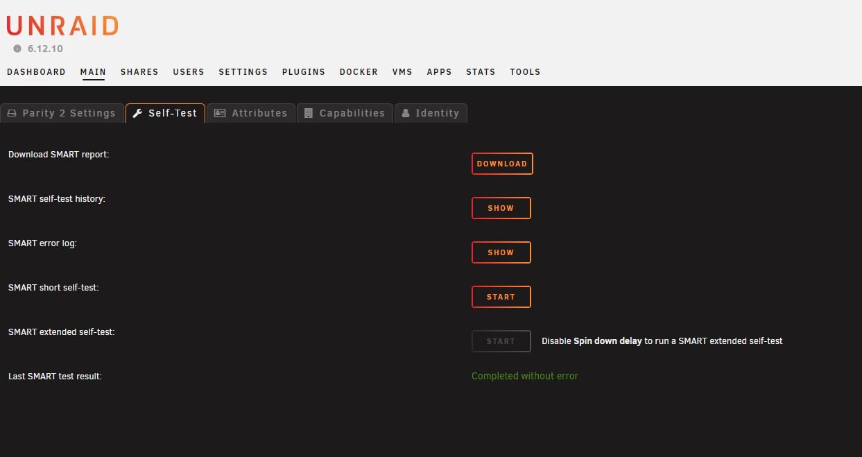

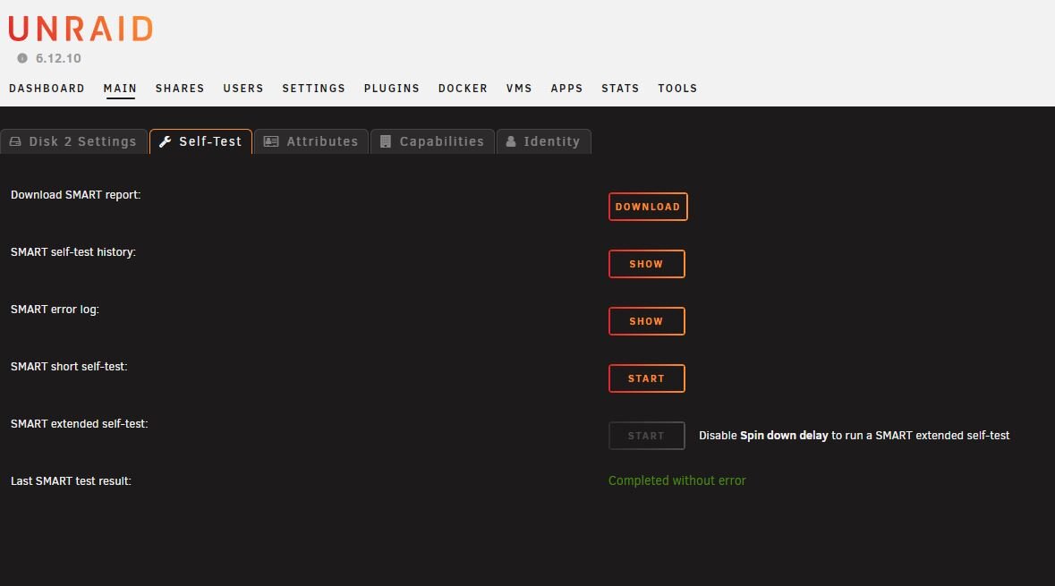

If the emulated disks were mounting and contents look good rebuilding is the next step, any errors during post new diags.

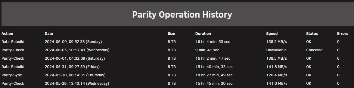

Rebuild was good, i did on last sunday, the parity 2 was rebuild, and data disk 2 too. no errors at all, and i did the two same time.

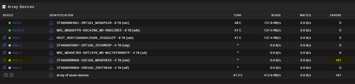

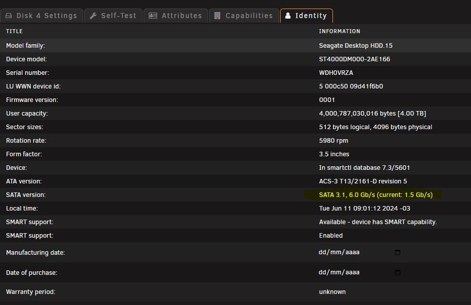

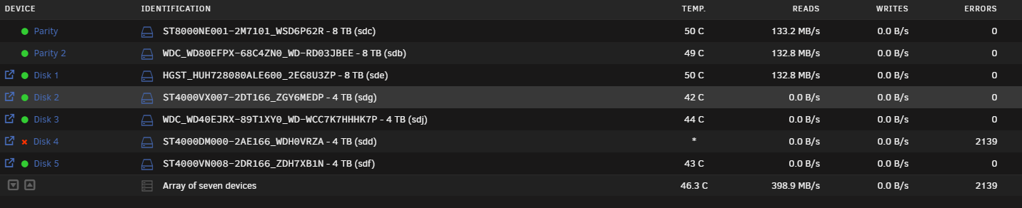

Yesterday i started a parity check just to confirm, and now my disk 4 are displaying errors, when i checked the disk  4 information i see the sata connection are negotiated at only 1.5 gbps, this disk are connected to a ASM1166 x6 sata ports controller, brand new.
This thing of bad sata negotiation was that started all my headache with my unraid, i dont know what can i do anymore, i swapped power supply's, cleaned my sata cables with a small brush and a proper contact cleaner spray.
I attached the diagnostics and some prints, thank you in advance Jorge!!!
Screenshots:
delorean-diagnostics-20240611-0911.zip
That is initially logged as a disk problem, though after the first error it looks more like a connection/power issue, still, and because of the 1st error, recommend running an extended SMART test, if it passes, replace the cables and try again.

Thank you Jorge, one more small question, do you know if power supply or not good quality power cable can make the disk slowing down the sata port speeds, keeping unstable, changing from 6 to 3 and to 1.5? of this can be the sata cables?
If will be the sata cables i will have to order another on ali express...
THank you!
usually it would be more a SATA cable issue.

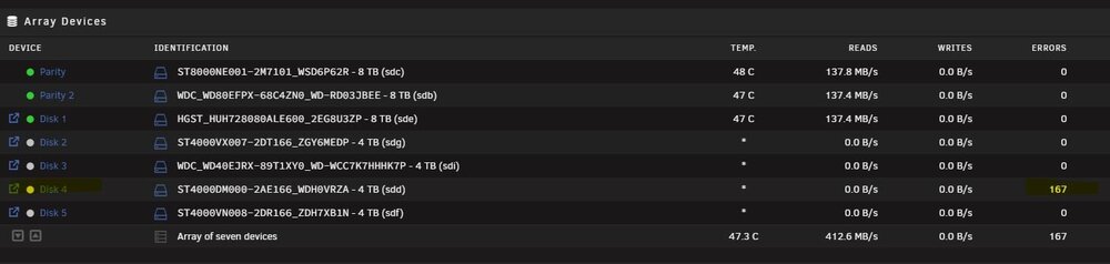

Hello people!

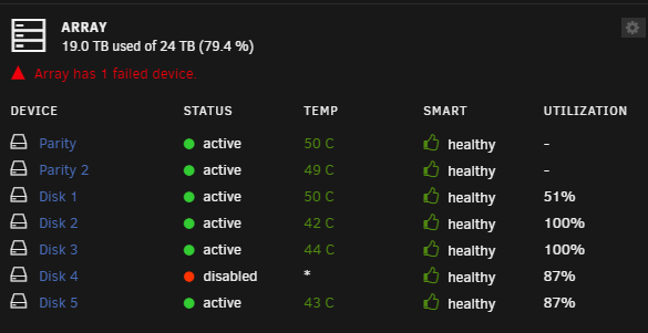

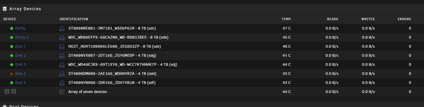

This night i run the parity check again, and now i get erros on disk 4, after the erros unraid has disabled the disk.
Smart screen says the disk is healthy, why?
At this moment the parity check is still running remaining 2 hours to finish (are checking the rest of 8 tb disks)
I attached the diagnosis file, should i replase this disk?

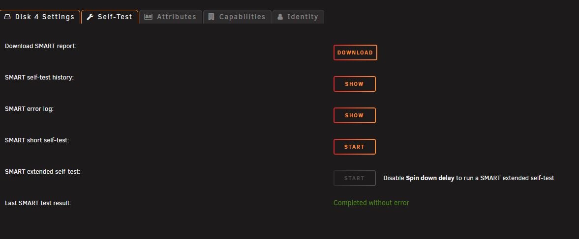

I try to run a extended smart tests on this disks, but after press the start button, nothing happens, i think this is because the disk is disabled by unraid or for still running parity check.
any tip is welcome!
Thank you all
delorean-diagnostics-20240617-1104.zip
The initial error is logged as a disk problem, but it then dropped offline, so there's no SMART, when you can reboot and post new diags.

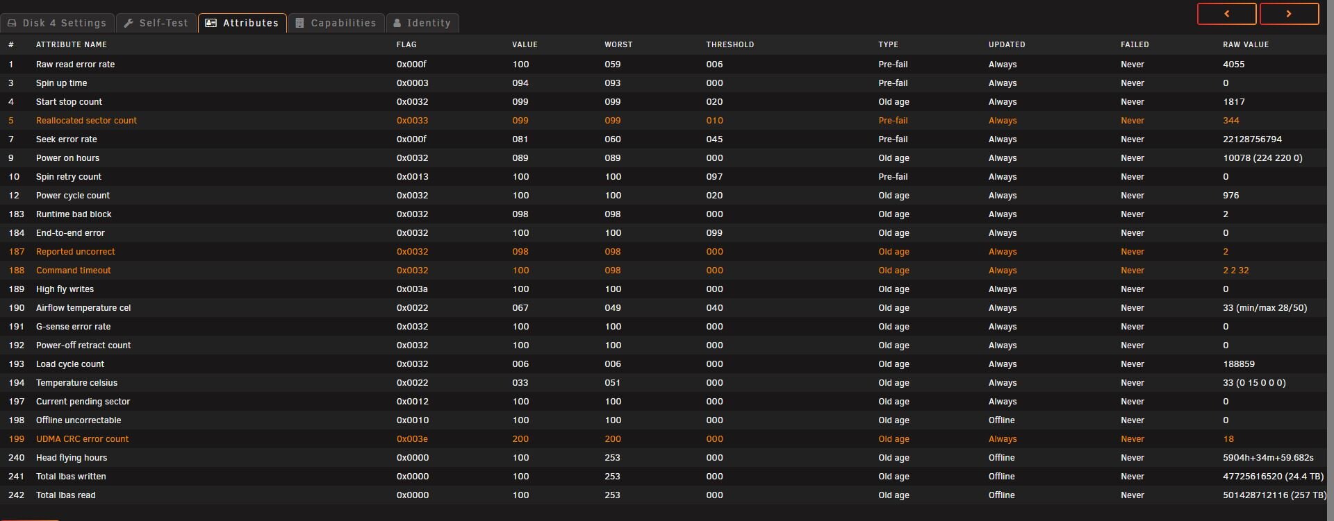

I rebooted, but the disk is still disabled, i started the array into maintenance mode, heres the diagnostics:
delorean-diagnostics-20240617-1611.zip

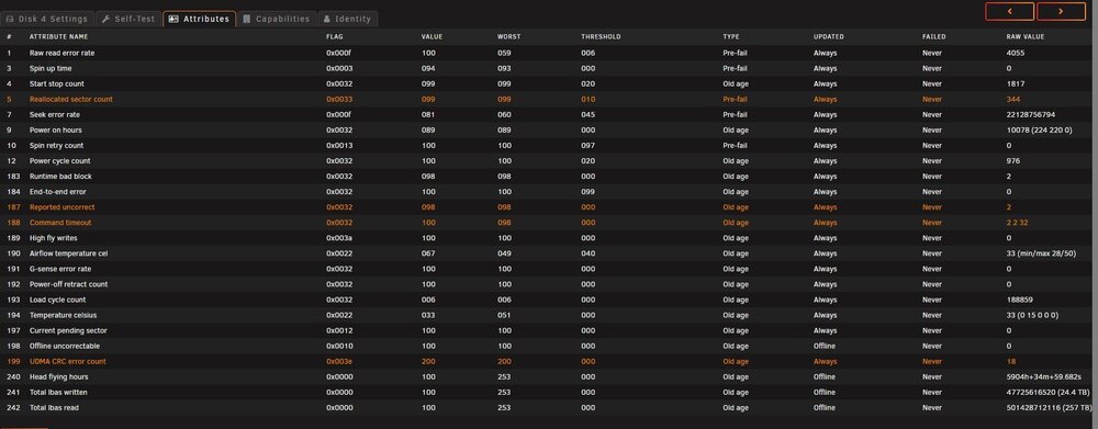

That's expected, it will be disabled until rebuilt.
SMART for disk4 shows some issues, run an extended SMART test.
