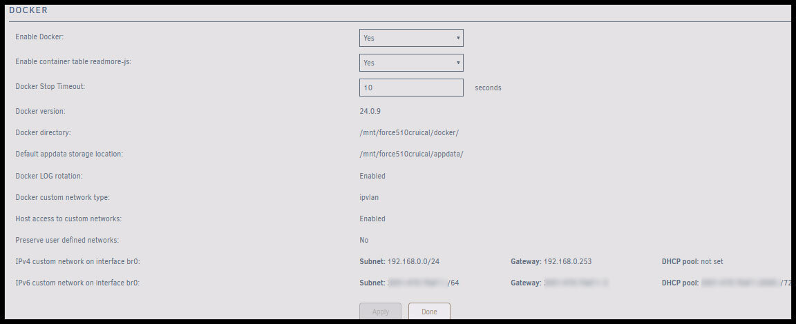

I assume you have entered a valid path to appdata and docker and use ipvlan with bridgeing ?
As an aside, why do you have 150GB allocated to the docker.img file?
The default of 20GB is enough for most people as when properly set up this only holds the binaries for docker containers.  If you increased the size because you run out of space it is typically because there is a path not mapped correctly for at least one container so files are being written internally to the image rather than to a location on the host.
Is there an easy way to figure out what caused this issue? I did increase it because it was filling up, but I am not sure what went wrong or where
Check the mappings for all container paths, that's the most common reason for this.
