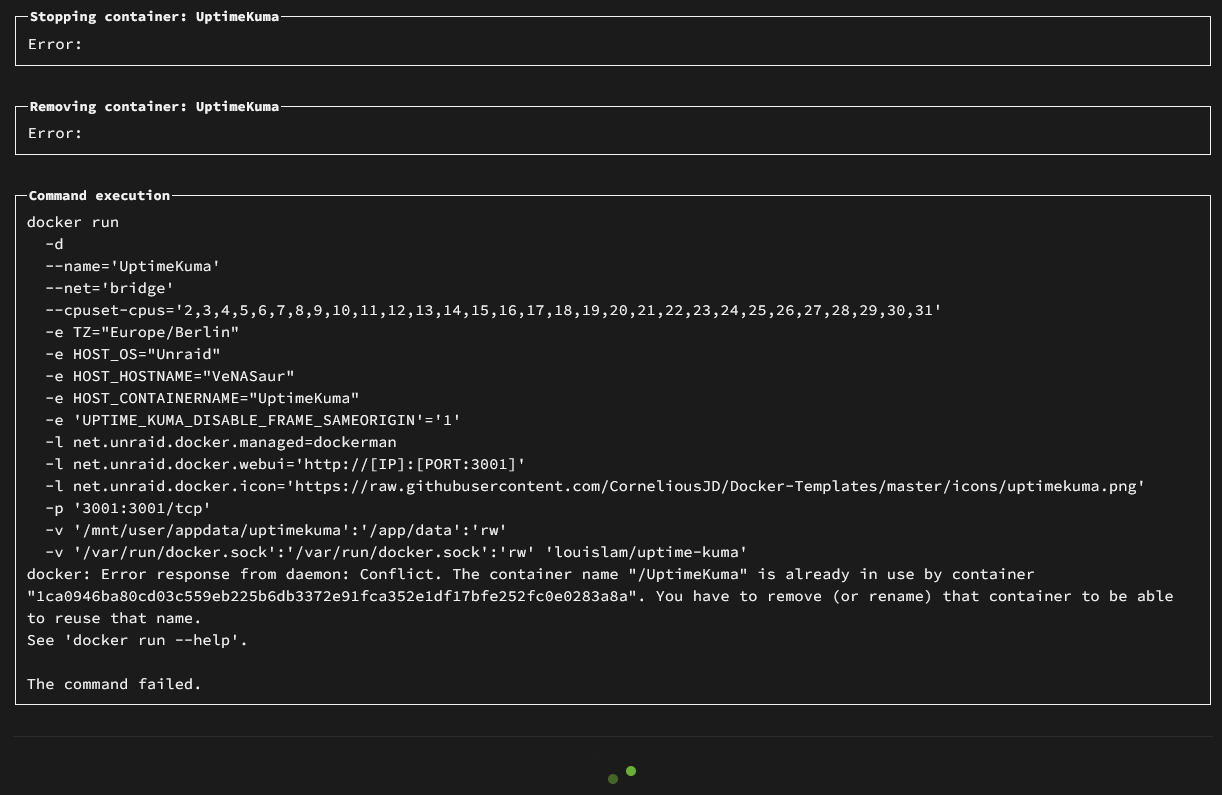

This is a very typical error when updating a container:

the webui never got past the "progress" page and i had to close the page, and still 10+ minutes after i closed that tab the webui is still not responding. but if i then reload php with
/etc/rc.d/rc.php-fpm reload
the webui instantly starts responding again.

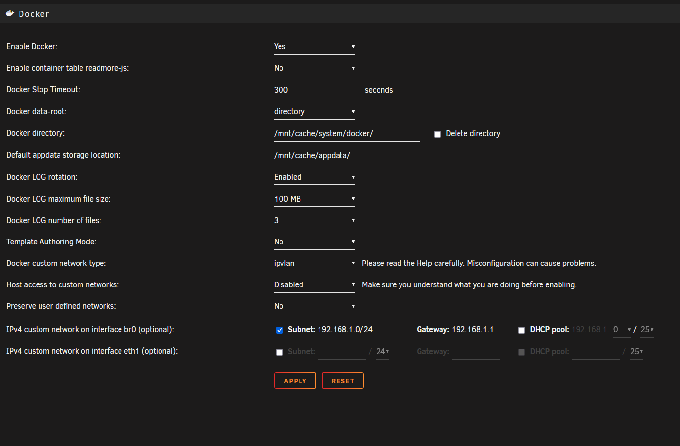

here are my docker settings:
I recently updated to a 14900k and i did not have this issue before so im not sure what the issue might be, though i did a bit of troubleshooting when trying to set the CPU pinning so i mightve changed something...
