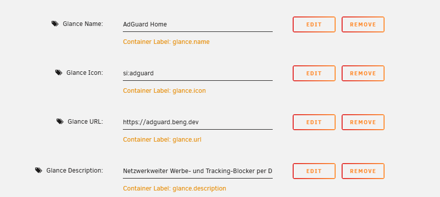

Has anyone gotten the docker-containers widget to work? I included the docker.sock in the configuration and gave a container the labels as an example. Nevertheless, Glance shows “No containers available to show”
My glance config:
My adguard home config:

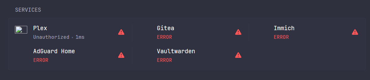

for some reason downloaded icons that i put in the assets folder does not show. I tried diffrent icon paths and even copied the image to the config path aswell. you will see below all the paths i tried.
widgets:
          - type: monitor
            cache: 1m
            title: Services
            sites:
              - title: Plex
                url: http://192.168.1.17:32400
                icon: /assets/plex.png
                icon: app/assets/plex.png
                icon: plex.png
