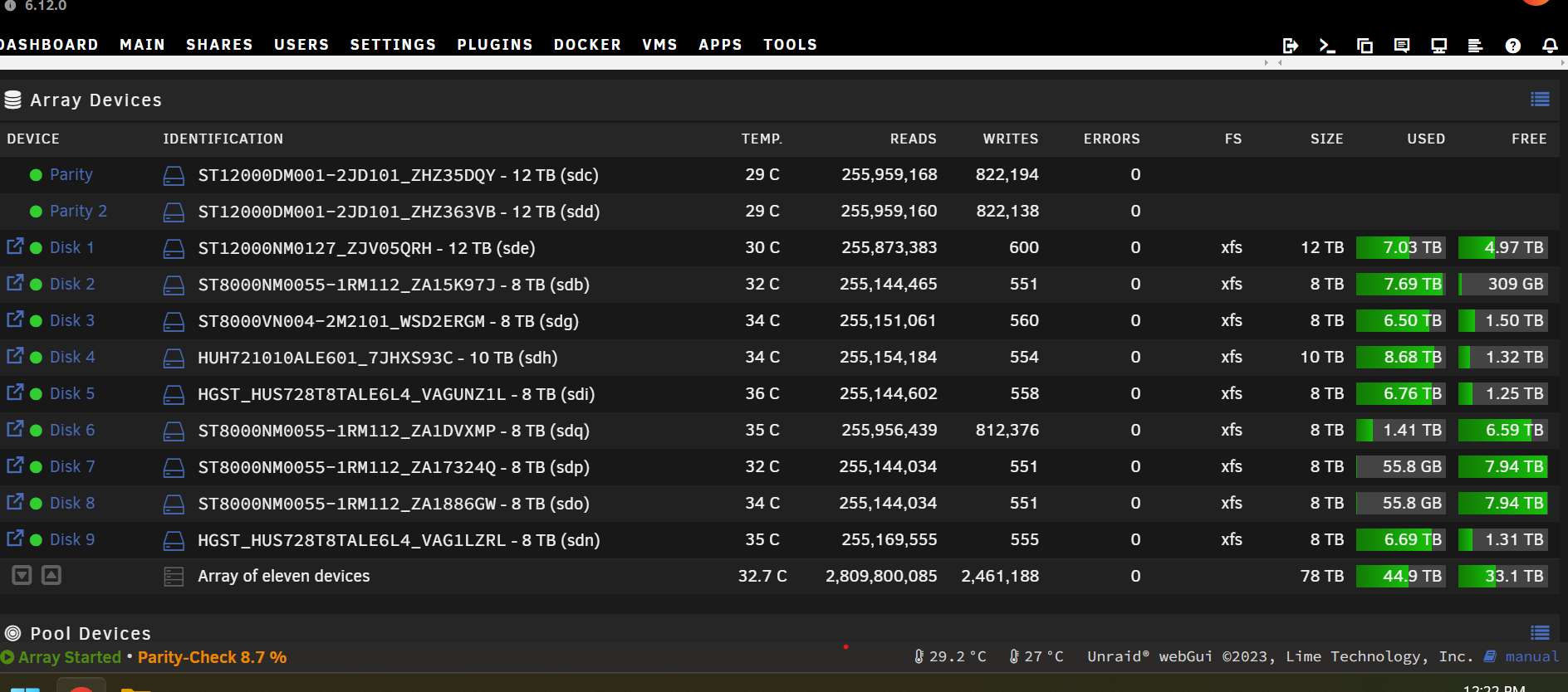

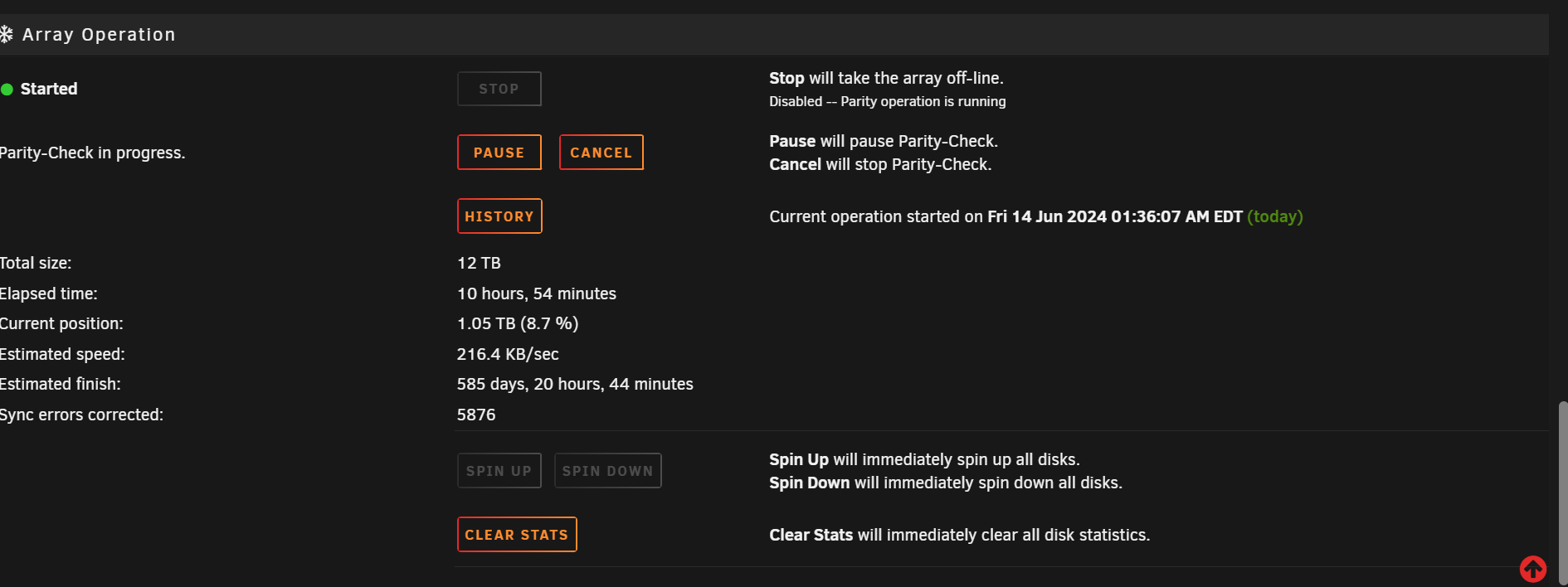

Hey I am having multiple issues. My system freezes. Dockers are disappearing. Downloads start out fast and the slow to nothing. Parity started running at normal speed and then slow near nothing. I have deleted the docker .img and redownload my dockers. I have tried a different NIC and then a new motherboard. Last night I replaced one LSI mini SAS card. My case uses a mini SAS connection backplane. I'm not sue how long but it has ran until recently with no issues. I am uploading two diagnostics one as it was running well doing a parity check and the other from this morning when parity has slowed to a crawl.

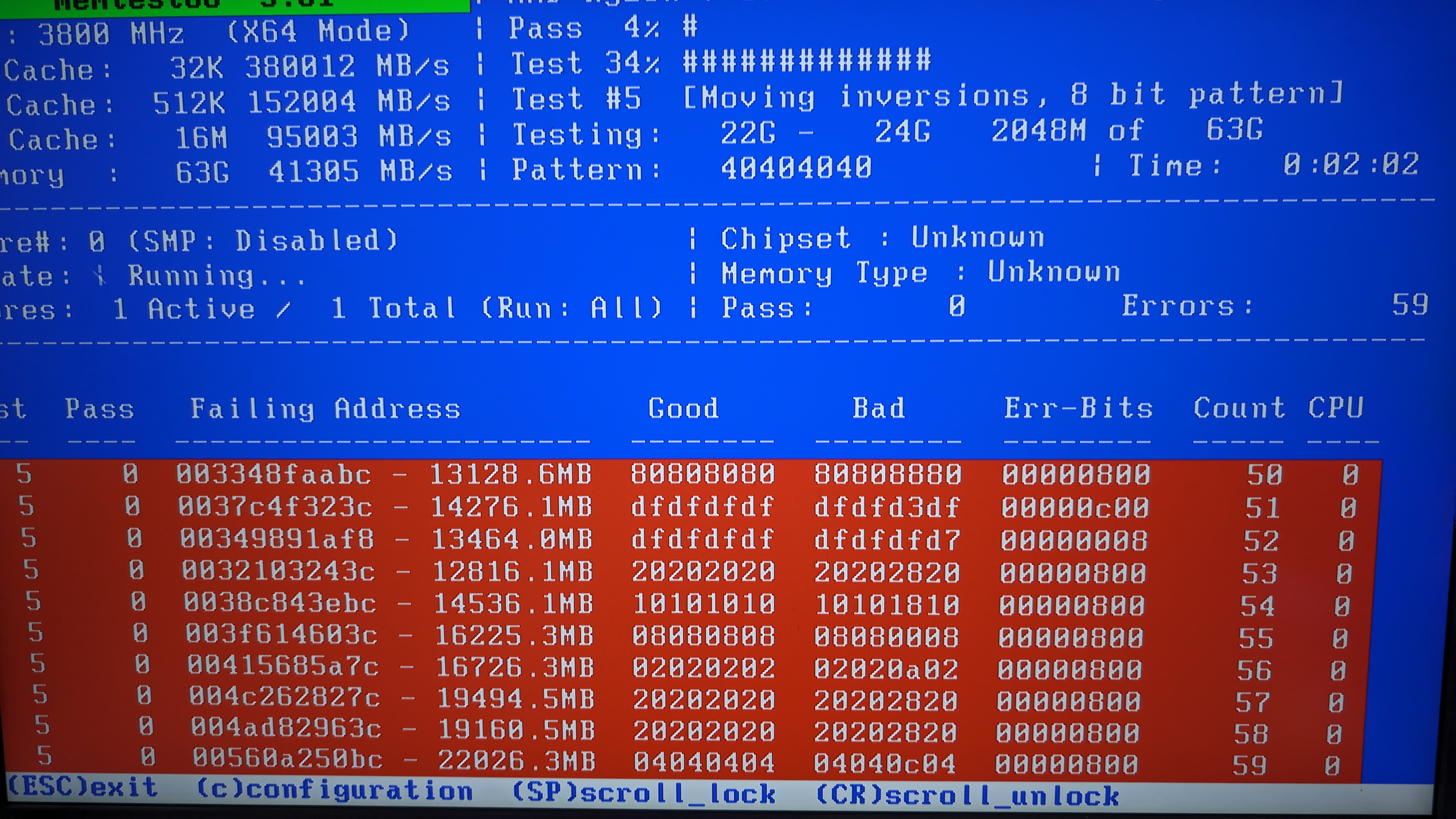

It is already showing errors. I am attaching a photo as it is already showing errors. I am unfamiliar with how the results are read. Does it show if it is one stick give any diagnosis. Will I need to just rule the individual sticks out by running one stick at a time.
It doesn't show the affected stick, but you can remove one at time and retest to see if you can find the culprit.

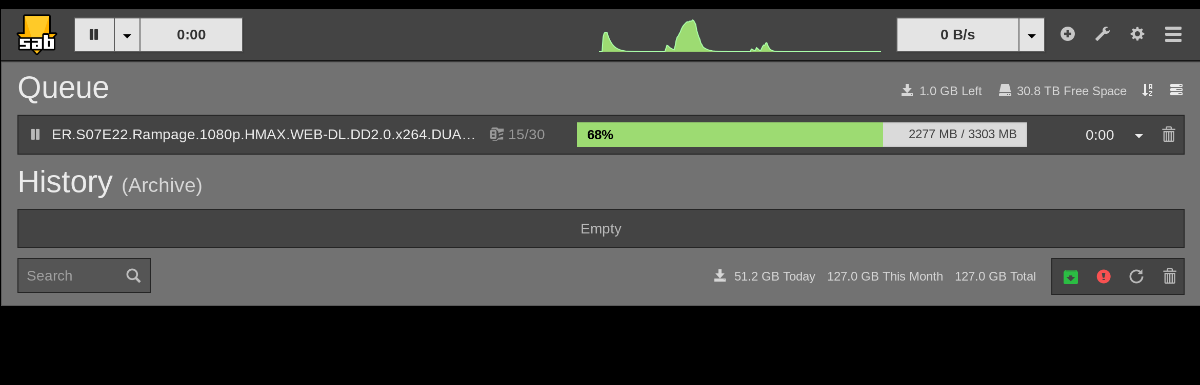

Hey just to go along with the logs I wanted to add a screen shot. I can go from  76 MB's to pretty much nothing. At the same time I may or may not be able to access the system otherwise like say the main page. Then all of a sudden it will go back to normal and the system will come back quick as can be. Just using this as an example. I am sorry to be such trouble but this is killing me. Also if it seems I am taking a long time to respond it's because I'm having a bad day and can't get around well. I have CMT II disease and I have to sometimes let my wife be my arms and legs.
Btrfs is detecting data corruption on all devices, also multiple apps segfaulting, looks like a RAM problem, since memtest is only definitive if it finds errors, and if you have multiple sticks, try using the server with just one, if the same try with a different one, that will basically rule out bad RAM.

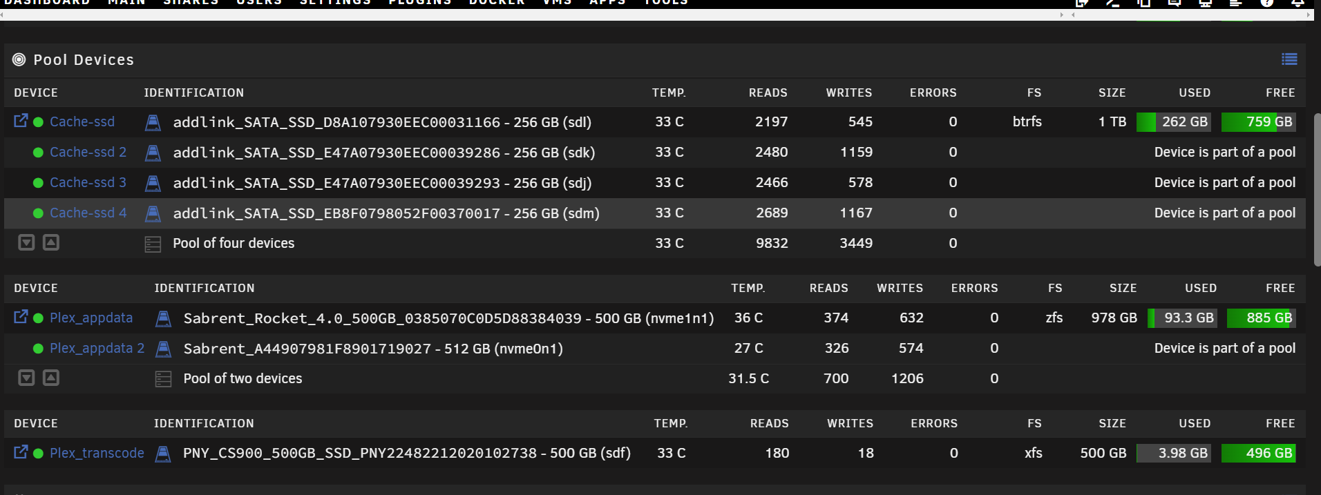

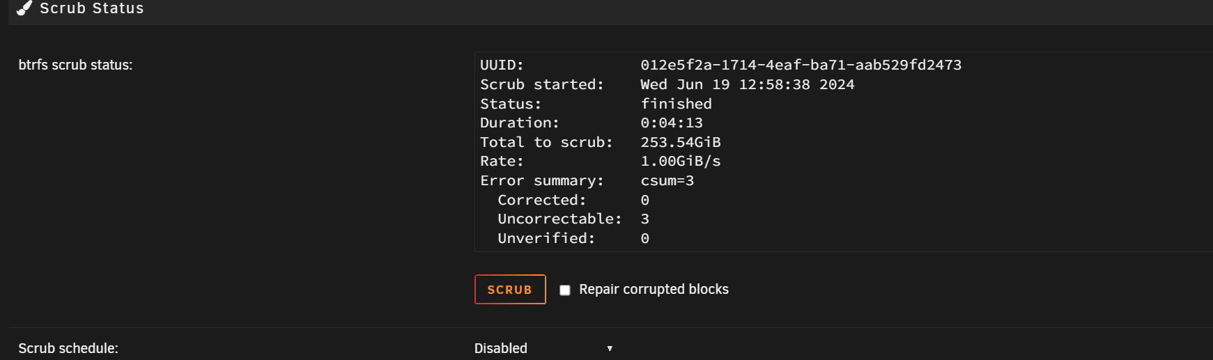

Do I need to do this separately for each device in the pool or is it considered as one device. I have a scrub running at this moment on the first device since it was the one that showed errors. I have attached what errors were shown before clearing.pre scrub.txt
Just the pool, it scrubs all devices from that pool.

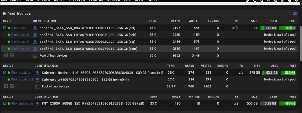

Ok so it completed with three uncorrectable errors. See attached. It seems to have started with three and ended with three.
