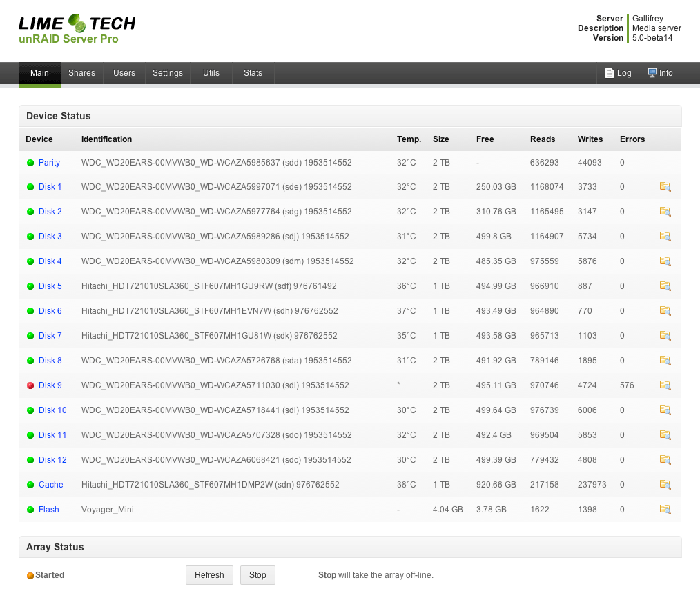

Server went down while watching TV earlier. Couldn't access gui, and couldn't access via telnet. Had to do hard reboot. On reboot, unraid did a parity check and found one drive with a lot of errors. Screenshot is attached (unfortunately it's the only one I got). Array came back up, but I was completely unable to run anything via console because the system was generating error message after error message without stopping. I couldn't escape out of it. Eventually the server stopped responding and I had to do a hard power down.

The syslog doesn't show anything wrong with disk9. The problem must occur later in the log. Post a SMART report for disk 9.
