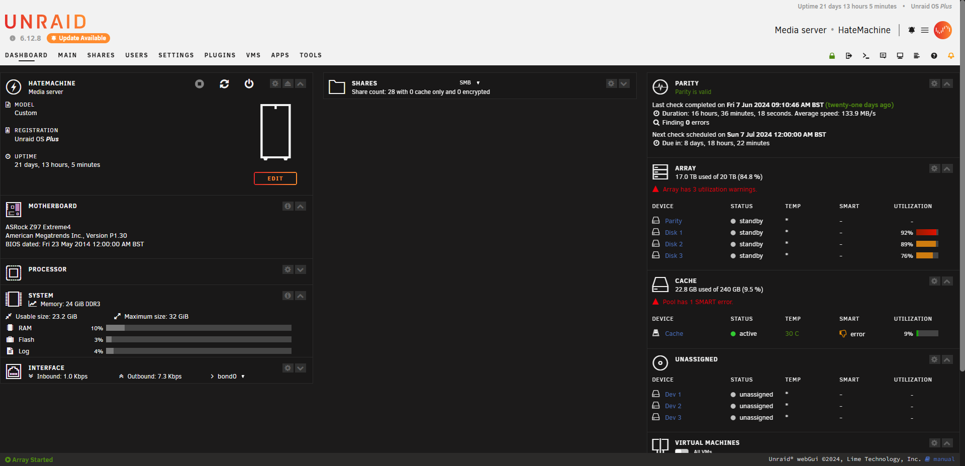

Hi everyone,
Today my cache started to report that it's "FAILING NOW" so it's probably about time that I replaced it ;D.
I've quickly ordered a new SSD (Kingston A400 SSD)
Luckily the past few days have been pretty light on any new data so if my understanding of SSD life cycles is correct the existing data on the drive should still be ok.
I've stopped all my applications and scheduled scripts so no new data should be hitting the cache.
I've also changed any shares set to prefer the cache to move from cache > array and kicked off the mover. This should effectively move everything from the cache to the array.
My plan this weekend is to:
  1. Stop the array
  2. Remove the current cache drive from the cache section of the UI
  3. Power down the server
  4. Physically swap the old SSD for the new one
  5. Power on the server
  6. Add the new SSD to the cache section
  7. Start the array
  8. Revert share cache preference
  9. Run mover
My questions to the forum are:
  1. Does the above check out?
  2. Any recommendations for when I'm setting up the new cache SSD? I setup the server a few years ago (2020) using an old gaming system (specs attached). I used pretty much all defaults (plain xfs). And I don't know if it's worth it (or even possible) to switch my cache drive to BTRFS or similar without altering my existing array setup.
  3. I see mentions of cache pools now, is that relevant? Should I pickup another SSD to make use of them?
Apologies if this is already well covered on here (it probably is) and I should just rtfm (I probably should...)
Thanks in advance
