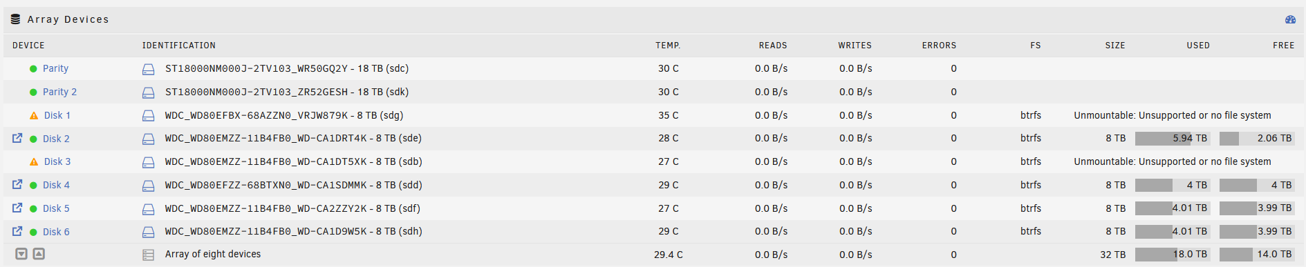

Then I figured out that the main issue was the 10 Port PCIe SATA controller. So I switched to a proper SAS controller.
The two missing disks are back, boot log doesn't throw any errors. So far so good.
Then I assigned the missing disks back to the array, started the array and started the rebuild.
Only after a couple of minutes I saw the warning that the disks ar unmountable. My mistake...
So I stopped the rebuild/sync.

Trying to mount the disks as unassigned devices:
Jul  2 12:38:30 GrayBigBerta unassigned.devices: Mounting partition 'sdg1' at mountpoint '/mnt/disks/VRJW879K'...
Jul  2 12:38:30 GrayBigBerta unassigned.devices: Mount cmd: /sbin/mount -t 'btrfs' -o rw,relatime,space_cache=v2 '/dev/sdg1' '/mnt/disks/VRJW879K'
Jul  2 12:38:30 GrayBigBerta kernel: BTRFS: device fsid d92a06ea-1eb0-4fd1-8aa3-47e0d921bdd8 devid 1 transid 29956 /dev/sdg1 scanned by mount (4220)
Jul  2 12:38:30 GrayBigBerta kernel: BTRFS info (device sdg1): using crc32c (crc32c-intel) checksum algorithm
Jul  2 12:38:30 GrayBigBerta kernel: BTRFS error (device sdg1): superblock checksum mismatch
Jul  2 12:38:30 GrayBigBerta kernel: BTRFS error (device sdg1): open_ctree failed
Jul  2 12:38:32 GrayBigBerta unassigned.devices: Mount of 'sdg1' failed: 'mount: /mnt/disks/VRJW879K: wrong fs type, bad option, bad superblock on /dev/sdg1, missing codepage or helper program, or other error.        dmesg(1) may have more information after failed mount system call. '
Jul  2 12:38:32 GrayBigBerta unassigned.devices: Partition 'VRJW879K' cannot be mounted.
My own idea
Because the array is still functional due to the emulated disks I had the idea to simply format the two disks and assign them as "new" disks to the array.
I did that with single disks before but not with two at the same time, so I'm not sure if that is a good idea.
Is ther a way to repair the filesystem? If yes, then I'd kindly ask for help.
Note: the rebuild was running for ten minutes or so before I canceled it, don't know if this makes any difference.
Or should I go with my idea?

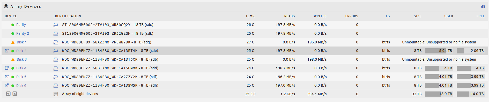

Start the array with both disks unassigned and post new diags.
If I understood correctly you have a backup of both disks?
Diags after starting array attached.

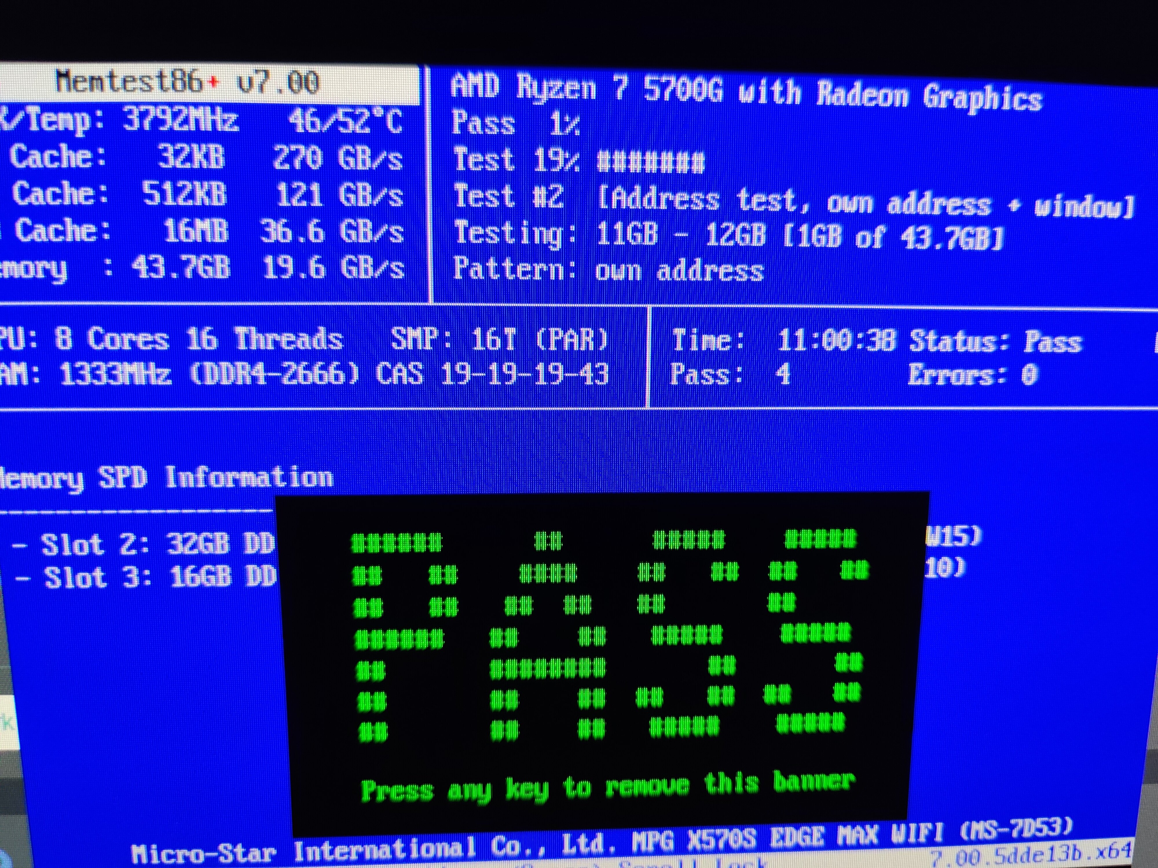

First thing I would recommend is to run memtest for at least a couple of passes, you will also need to scrub all those disks, but that can be for later, run memtest now and post back the results, though keep in mind that memtest is only definite if errors are found.
Thank you, memtest v7 is running now. I'll post the results after a couple of passes.

Hi JorgeB,
memtest86 results attached. No errors after 4 passes.
Keep in mind that memtest is only definitive if if finds errors, but for now, lets make a final try to recover the data, finish rebuilding both disks, we can then try to use a backup superblock to see if that works, but don't have much hope, if that doesn't work, you can then try using a file recovery app like UFS explorer on the rebuilt disks.
You will also need to scrub all the disks that have corruption detected, then reset the errors and monitor to see if new ones come up, but this is for later.
Ah, now I understand what you meant with "definitive" - letting memtest run until it finds an error.
Sorry, english is not my first language 😅
Ok, I assigned both disks and started the array. Rebuild started automatically.
But both disks are labled as "Unmountable: Unsupported or no file system".
I read in another post that in this case, the rebuild will not actually write anything on the disks.
I paused the rebuild for now.
Shall I proceed?
Edited by fusselnerd
It will still write to the disks, BTW, I forgot to ask, those disks are the original disks 1 and 3 right? Or are they new and you still have the old ones?
Ok, thx. Rebuild is resuming.
