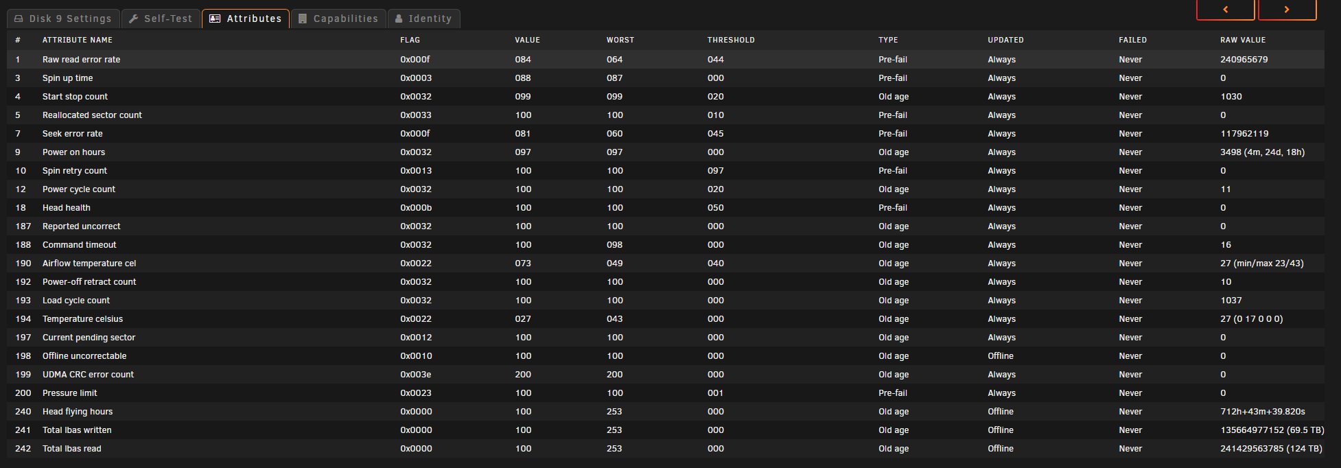

here's the smart info if that helps

The above still applies to the latest diags, and don't see anything that suggests a disk problem

I was wondering if you would be able to help me by letting me know what information i could provide to seagate regarding the error.  I did a quick scan of the drive and it came back fine.  I'm just trying to cover my bases before i submit the rma.
Post a SMART report for that disk.

I don't see anything that suggests a disk problem with that SMART report, and Seagate may not replace it.
