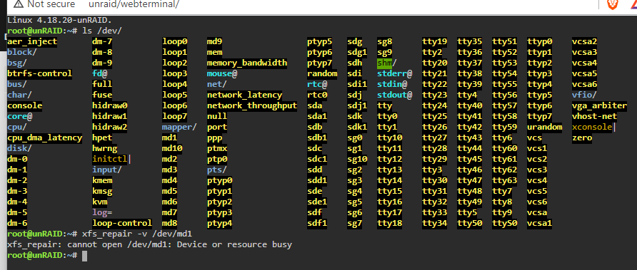

  7. When I started the array, the first data drive (Disk 1 • WDC_WD60EZRZ-00GZ5B1_WD-WX21DB6N4KN4 (sdh)) reported "Unmountable: Unsupported partition layout"

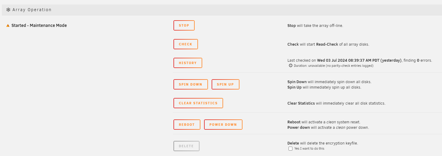

  8. I restarted the array in Maintenance mode to follow the XFS repair procedure.

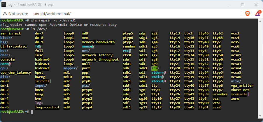

  9. xfs_repair said "Device or resource busy" on Disk 1 (/dev/md1), so I also tried running it on /dev/sdh itself:
    root@unRAID:~# xfs_repair -v /dev/md1
    xfs_repair: cannot open /dev/md1: Device or resource busy
    root@unRAID:~# xfs_repair -v /dev/sdh
    Phase 1 - find and verify superblock...
    bad primary superblock - bad magic number !!!
    attempting to find secondary superblock...
    ....found candidate secondary superblock...
    unable to verify superblock, continuing...
    [12 hours later...]
    .........Sorry, could not find valid secondary superblock
    Exiting now.
    root@unRAID:/#

Not sure what you really did there, but Maintenance mode doesn't mount any disks, so they can't be busy. You should try it again.
And this was the incorrect command. You have to run it on the partitition, not the device.

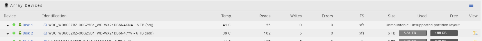

Stop the array, Start the array in normal mode. Disk 1 still says "Unmountable: Unsupported partition layout"
Not seen that before :(  The repair look like it ran successfully so I would expect the drive to have mounted when when you restarted in normal mode.   Maybe you should post current diagnostics to see if we can spot a reason why it has still not mounted.
This is a different problem, not filesystem corruption, since you don't have valid parity see if the disks mount with UD, but use the read-only option.

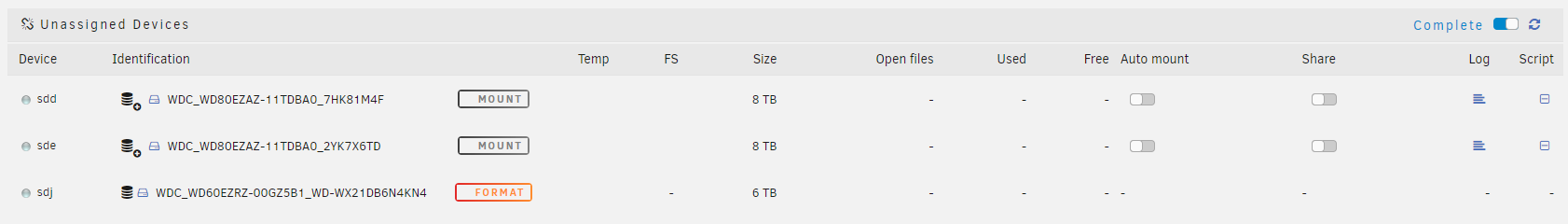

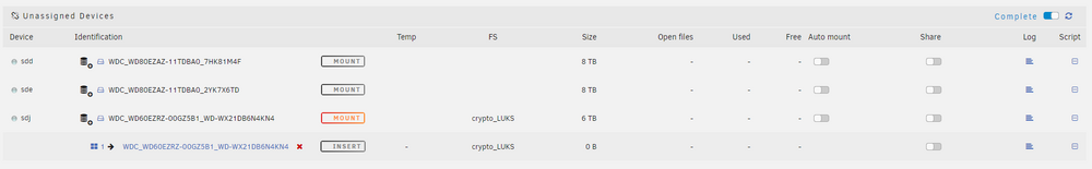

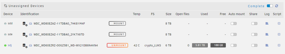

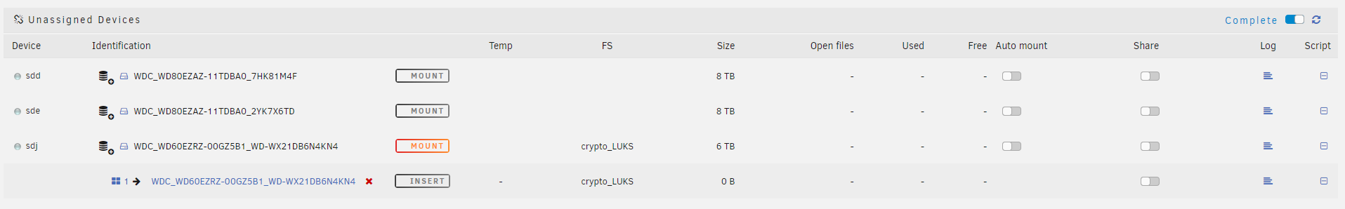

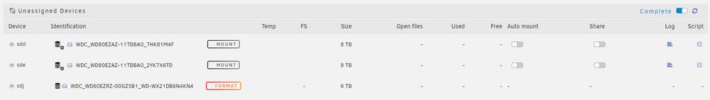

Okay, I removed Disk 1 from the array to make it appear as an unassigned device, but I don't see any options in UD to mount it as read-only; it just says FORMAT where the other drives say MOUNT.
2024-07-0508_43_32-unRAID_UnassignedDevices-Brave.thumb.png.2290aa044b155fd0492794950d2d1386.png

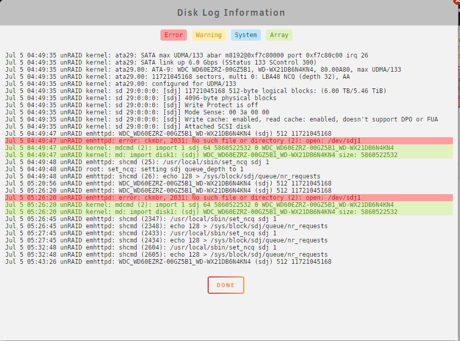

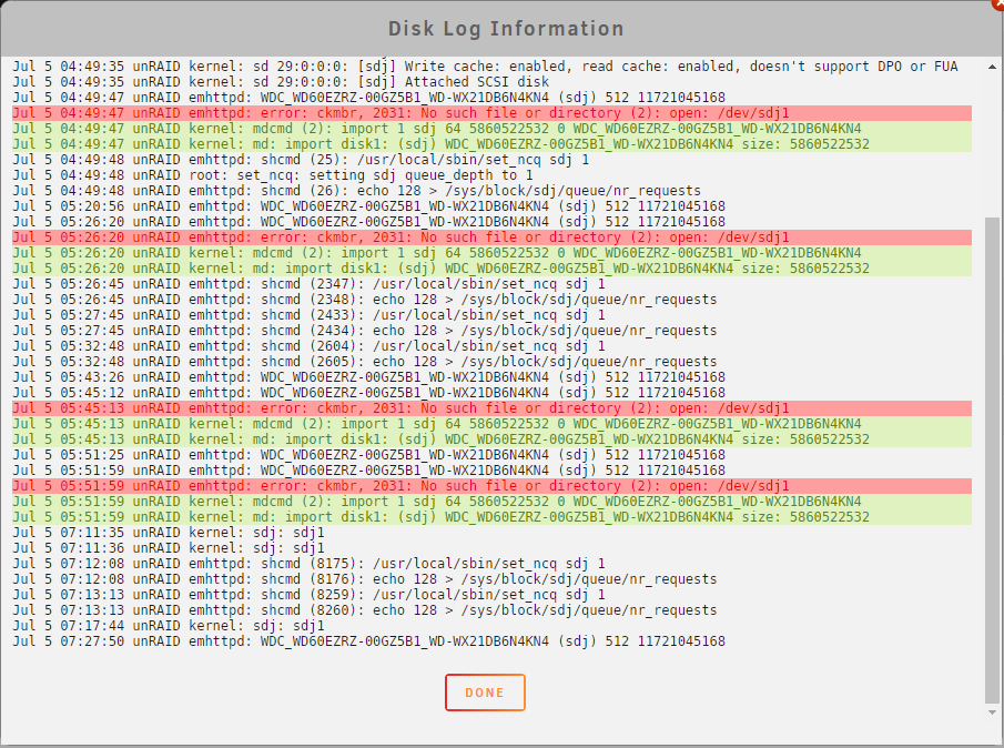

Here's the drive log:
2024-07-0508_44_21-unRAID_UnassignedDevices-Brave.png.60b74ab7c20386da7f7d18c03667f397.png
Should I update Unraid from 6.6.6 to the newest 6.x.x and see if there are UD updates? My version is from 2019.
Also, since xfs_repair didn't find any errors, I'm happy to pull that drive and try to mount it on a Linux system if that simplifies things. I have a laptop running Ubuntu 22.04 and a drive dock.

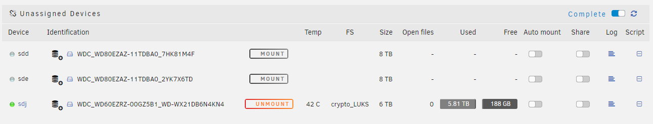

27 minutes ago, neubert said:
The primary GPT table is corrupt, but the backup appears OK, so that will be used.
You can try to fix this to see if it helps:
Post the output of:
gdisk /dev/sdj
Post the output of:
gdisk /dev/sdj

type
w
then
y
Command (? for help): w
Final checks complete. About to write GPT data. THIS WILL OVERWRITE EXISTING
PARTITIONS!!
Do you want to proceed? (Y/N): y
OK; writing new GUID partition table (GPT) to /dev/sdj.
The operation has completed successfully.
root@unRAID:~#
Start the array, but it still says Unmountable: Unsupported partition layout:
Stop the array, back into the terminal:

Looking better. Remove Disk 1 from array and open UD. I still don't see a read-only option. Should I just press that MOUNT button?
2024-07-0510_28_30-unRAID_UnassignedDevices-Brave.png.e2abe19796d380736db2c60d656e79d0.png
2024-07-0510_29_06-inunraidusingtheunassigneddevicesudtooldoihavetoremoveadrivefrom.thumb.png.811fe38890f7f7b691bde12d5fcb0327.png
Try, no read-only option may be because it's encrypted.
Okay, it mounted and I can see the files under /mnt/disks:
2024-07-0511_13_52-unRAID_UnassignedDevices-Brave.thumb.png.2b47839a52cee4a0fb81a2a1941ce6a7.png
Linux 4.18.20-unRAID.
Last login: Fri Jul  5 07:17:37 -0700 2024 on /dev/pts/1.
root@unRAID:~# ls /mnt/
disks/
root@unRAID:~# ls /mnt/disks/
WDC_WD60EZRZ-00GZ5B1_WD-WX21DB6N4KN4/
root@unRAID:~# ls /mnt/disks/WDC_WD60EZRZ-00GZ5B1_WD-WX21DB6N4KN4/
root@unRAID:~# du -hsc /mnt/disks/WDC_WD60EZRZ-00GZ5B1_WD-WX21DB6N4KN4/
5.3T    /mnt/disks/WDC_WD60EZRZ-00GZ5B1_WD-WX21DB6N4KN4/
5.3T    total
Thank you!
