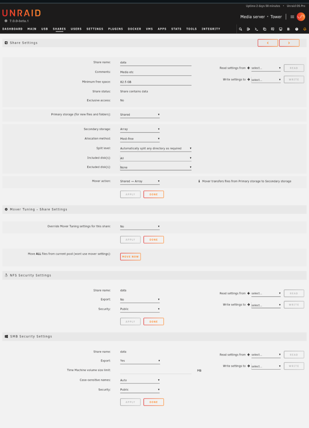

Only just upgraded to the latest beta, everything was working properly beforehand. I have two cache's, one is called cache and one is shared. I have a share called 'Data' which is set so that files first go onto the shared drive and are moved to the array when Mover does its thing.
For some reason, Mover isn't moving anything from the shared drive. Instead it's just filling up. Diagnostics zip is attached.
