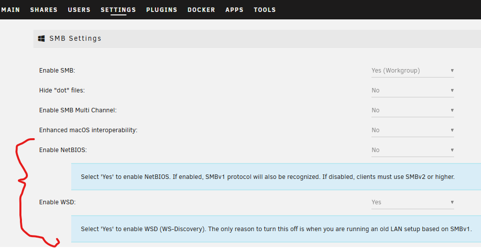

I am not running Version 7.0 on either of my servers.  However, let me point out that SMBv1 is well out of date and is only needed fro very old hardware that is not had a software update recently.  (MS, by default, does not even install the SMBv1 protocol in WIN10 and WIN11 on new installs!)  First ting to look at is these settings:
      SETTINGS  >>>   Network Services   >>>   SMB
And look at these settings:
Be careful if you turn off the second one as it may break things for devices that don't (or can't) use SMBv1.  I wold try only if the first option doesn't work..

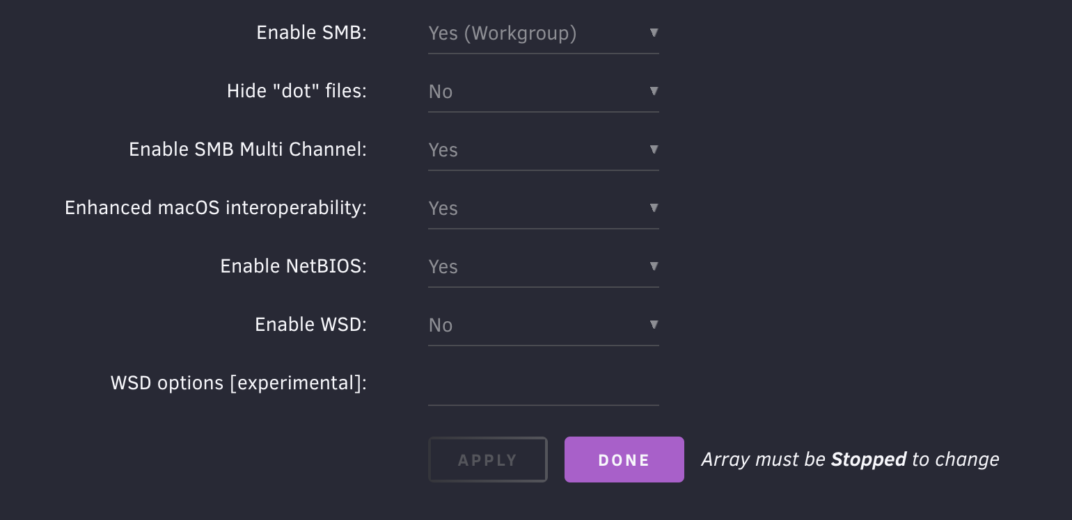

the picture is my setting. I will try your setting.
