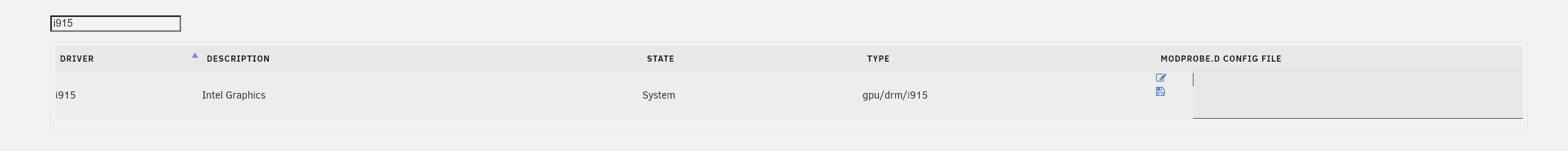

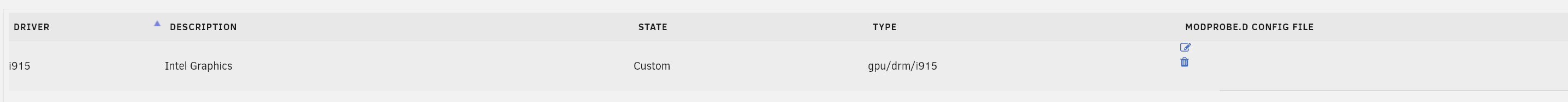

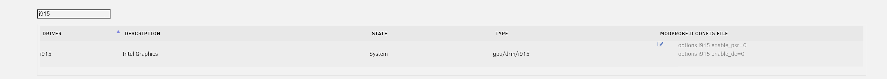

July 21, 20242 yr 7.0.0-beta.2: U cant clean remove modprobe config. (only way is to add a space " ") and save (after click on save icon:) U can only save one space " " And if u click delete modprobe config Edited July 21, 20242 yr by NewDisplayName
July 21, 20242 yr 7 minutes ago, NewDisplayName said: U can only save one space " " Correct has the os has somefiles and you need to create a blank one to replace the shipped one, i.e. it may blacklist a driver as default.
July 21, 20242 yr 16 minutes ago, NewDisplayName said: U cant clean remove modprobe config. (only way is to add a space " ") and save I find you delete all of the white space it works also. Code is public so you can raise prs if you want.
July 21, 20242 yr Author what else i should send? video proof? or what? I showed exact pictures of removing everything and clicking saving.. the piucture after is what is shown to me which is FALSE. Edited July 21, 20242 yr by NewDisplayName
July 21, 20242 yr 29 minutes ago, NewDisplayName said: what else i should send? video proof? or what? I showed exact pictures of removing everything and clicking saving.. the piucture after is what is shown to me which is FALSE. Post in the bug reports section not feature requests, This feature has been in since 6.12 are you seeing the issue on 6.12 7beta?
