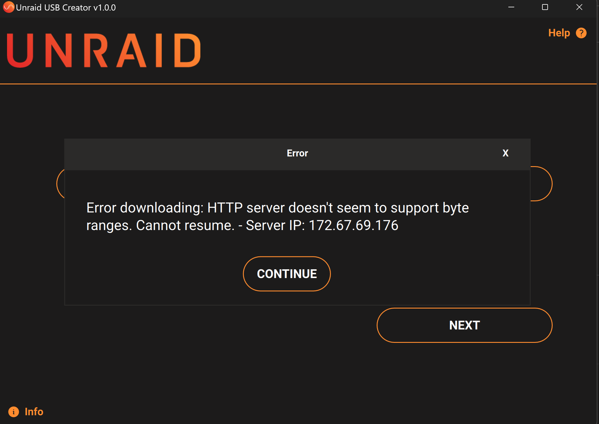

July 26, 20242 yr When i try to use the Unraid usb creator tool i get this error code at around ~40%: Error Downloading: HTTP Server doesn't seem to support byte ranges. Cannot Resume. - Server IP: 172.67.69.176 If anyone can help me out id really appreciate it. I've formatted the USB multiple times to no avail. I'm sure there is a solution to this, I'm just having a hard time finding it.
August 18, 2025Aug 18 Community Expert This thread is old.Are you having exactly the same error message?
August 26, 2025Aug 26 hello there, it is old but issue still persists... heres photo:Any idea how to finish creating boot disk ?
August 26, 2025Aug 26 Community Expert You can use the manual install method:https://docs.unraid.net/unraid-os/getting-started/manual-install-method/
