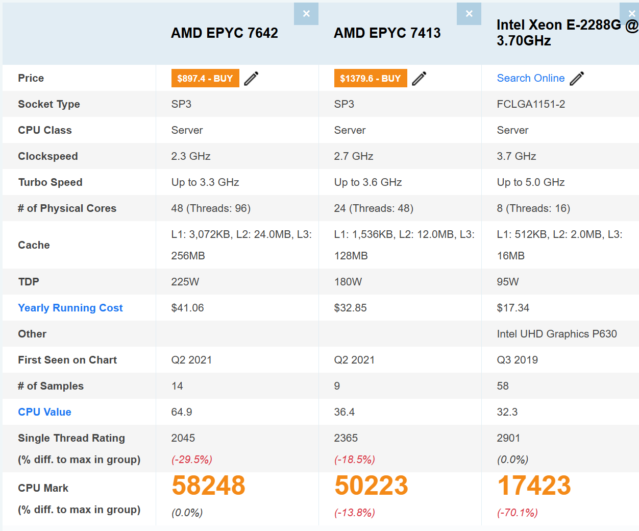

July 28, 20242 yr I'm running an Intel Xeon E-2288G CPU + Supermicro X11SCZ-F at the moment. I am strongly considering "upgrading" to an AMD EPYC 7642 or EPYC 7413 with Supermicro H12SSL-I. I lose integrated graphics, but I gain a huge amount of PCI lanes and CPU power. I also have higher potential power consumption. I'm looking at these two listings right now: AMD EPYC 7413+ Supermicro H12SSL-I +8x32g 3200 DDR4 REG ECC=256G combination US $1,814. https://www.ebay.com/itm/387125658055? Supermicro H12SSL-i Motherboard With AMD EPYC 7413 CPU,8x32GB 3200MHz RECC RAM US $1,679. https://www.ebay.com/itm/126573440505? AMD EPYC 7642+ Supermicro H12SSL-i +8x32g 2133P DDR4 REG ECC=256G combination US $1,470. https://www.ebay.com/itm/175430840223? I'm leaning towards the 7413 just because it's newer, but frankly the 7642 is much better value. Twice the cores, $350 less, and just a bit less efficient per core. I'm also considering staying where I am now. My server does everything I need still, but I don't think I can push it much harder and still be happy with the performance. Also, I would love more PCI lanes and a second SSD slot on board. I don't think I'd even install the full 256GB of memory as 128GB is fine right now, but I like having it on hand for future expansion. What would you do? Why? Thanks! Edited July 28, 20242 yr by craigr

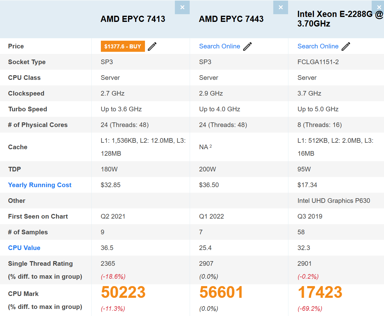

July 29, 20242 yr Author I found these resources helpful: https://www.cpubenchmark.net/compare/4346vs4708vs3546/AMD-EPYC-7413-vs-AMD-EPYC-7443-vs-Intel-Xeon-E-2288G This site is no ARK, but it's a place to start. Some of the information is wrong or incomplete, but it's a good place to start: https://en.wikichip.org/wiki/amd/epyc Best, craigr
