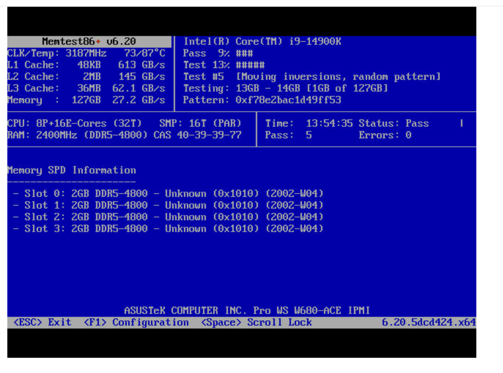

I noticed my server started hanging a couple of days ago with no configuration changes on my end.
i restarted the server and a couple hours later it crashed again.
I had recently heard that some intel CPUs had some instability, i went to the mobo manufacturers website and installed the latest BIOS update 3701. a couple hours later it crashed again.
I tried downloading diagnostics but it seems to hang on the flash drive
Samsung_Flash_Drive_0376622050006768-0-0-2024-04-03 flash (sda).txt' /usr/sbin/zpool status 2>/dev/null|todos >>'/venasaur-diagnostics-20240805-0635/system/zfs-info.txt'
Not valid!
i have a syslog server setup on another server and it stops updating as well.

in this so called hung state i can see the disk activity on /main and i can navigate to /settings and /tools but if i go to /dashboard the webui is blank and it will not load, at this point i cannot navigate back to /main without having to reload php with
/etc/rc.d/rc.php-fpm reload
even weirder is i have homeassistant running in a VM and some docker containers that don't appear to be affected at all. but even then there are a couple of docker containers that seem to load indefinitely even though they dont seem to outright crash.
From what i can see when trying to create the diagnostics it stops on the zpool status which seems to indicate there is an issue there.
But then in the syslog there seems to be a lot of different stuff like segfaults, tainted kernel, and call traces.
any ideas what issues i'm having here?

overnight it did another "real crash" where i wasn't able to connect via ssh, webui, or even the physical keyboard.

ill reformat the zfs cache and see if that helps.
trying to move data off of the cache to the array using Mover my server has crashed twice

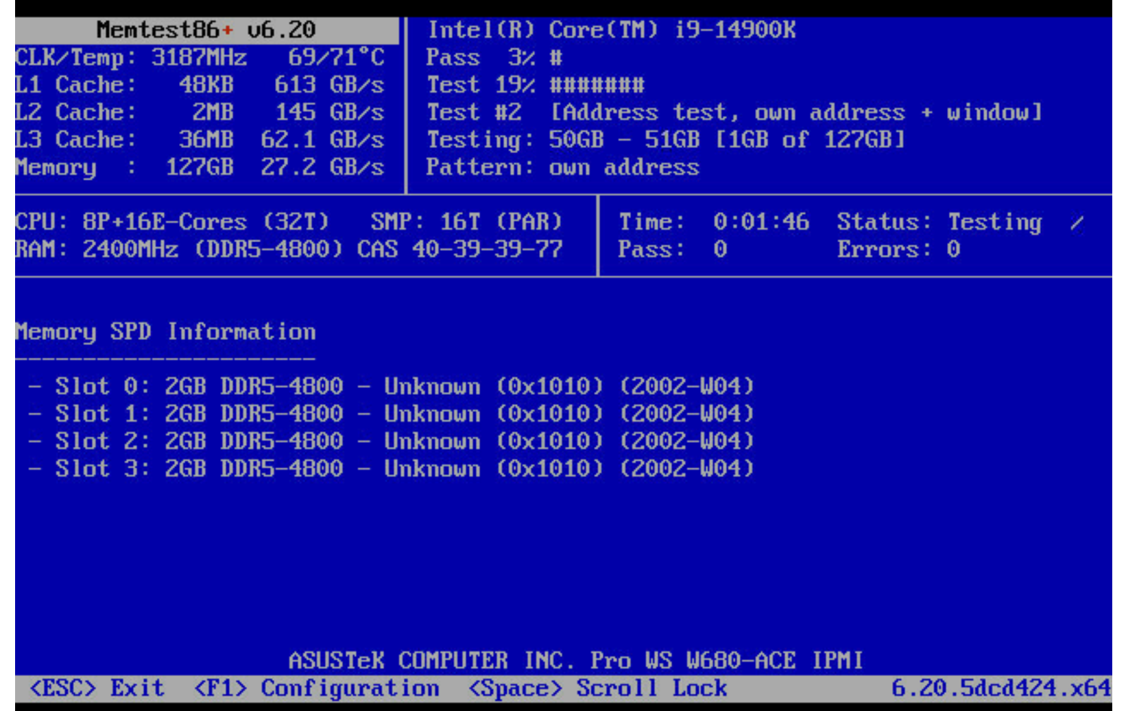

There may be other issues, I would start by running memtest.
I moved everything off using mc, then reformatted the cache, no issues.
I then started the mover to move everything back to the cache, and the server crashed 🤔
I'll run memtest and get back to you...

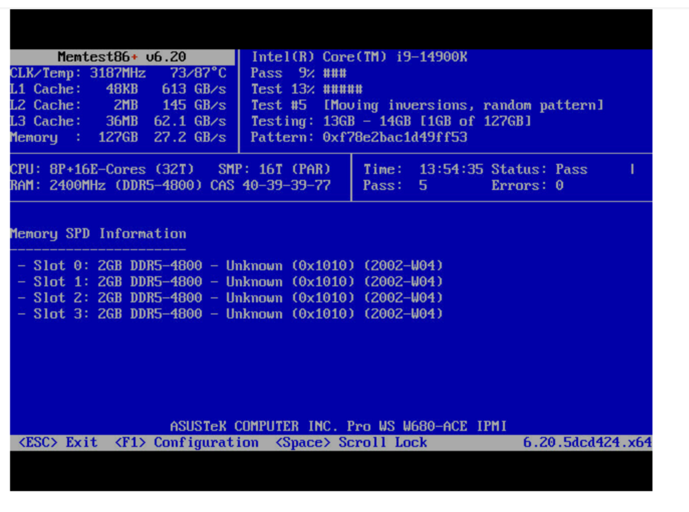

memtest ran 1 pass with no errors
i let it run overnight and it got up to 5 passes without errors
Whats next?

The crash happened a couple of minutes after i finished manually moving a couple of things (400GB~) off of the cache to the array.
The mover is disabled.
the self test didn't find any errors either.
Could it be a bad PSU?

I still think it's a hardware problem, possibly the Intel 13/14th gen stability issue.
I started the RMA process and should receive the replacement CPU within the week..
I tried disabling docker and VMs and just running mover for the past 24 hours and it did not result in a crash, i turn on VMs (HAOS) and it results in a "hung" state within 4 hours.
This time i was able to grab diagnostics since i destroyed the zpool.
Not sure if it shows anything or if it's a different issue altogether.
Edited by MammothJerk
Shows a kvm related crash, which can or not be hardware related.
New cpu installed.
i'll try to run a parity check now and see what happens.
haven't had any crashes since, mover has mover 3TB and parity check finished (with lots of errors 🥲) and the server has not crashed.
