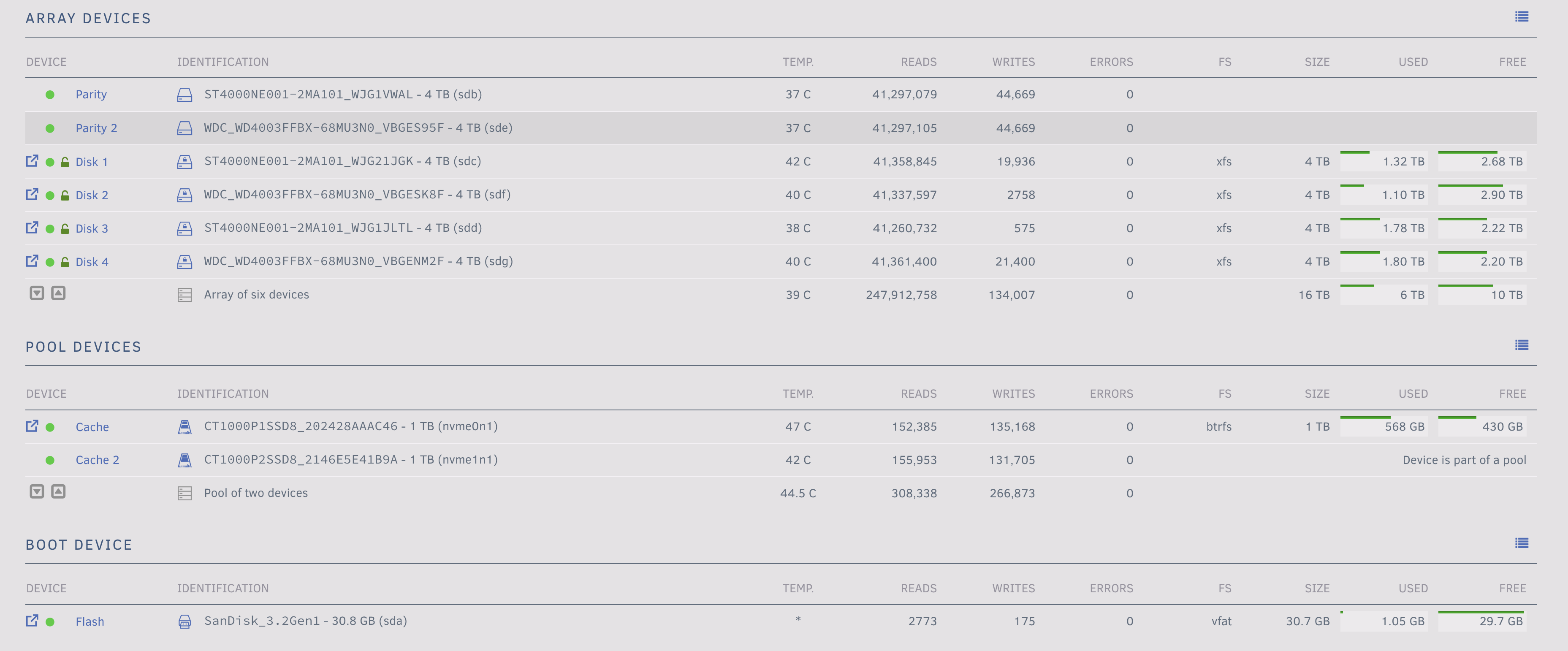

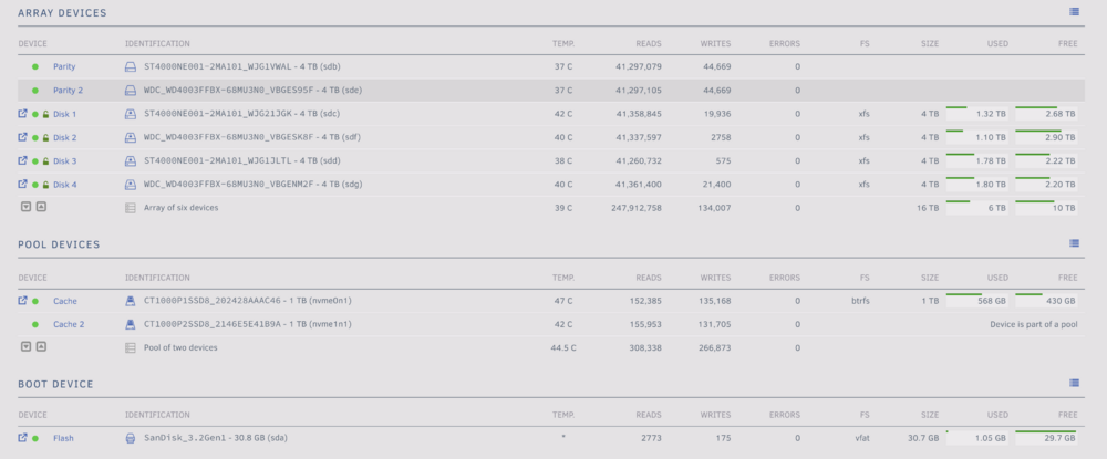

August 7, 20242 yr Please help!! Unraid is driving me crazy and it was working so well until a few months ago. It is running parity checks out of schedule and no matter what I do, it does not seem to stop doing it. At this rate, my drives will go bad before their time because of this. I have extended the shutdown timer, had clean reboots (no parity starting right after reboot), have completed parity checks successfully, and yet Unraid will start a parity check randomly. If I cancel it, it will just start it again in a few days. if I pause it, it will start it again in a few days. if I disable it, then i keep getting notifications that I do not have a parity check scheduled. This is not a scheduling issue, or should not be, since it is telling me when the next one is scheduled for, and yet it will start one before that in the middle of the day and all the services that I am running will become unresponsive. Where is the config file to see the schedule? What in the logs will tell me why it is starting a random parity check? I do randomly get a mcelog event, and I am trying to isolate if one of my RAM modules is bad but my understanding is if I shut it down and start it up cleanly, it should stick to schedule. is that not true? I did share my diagnostics a little while ago in a different post and the best i got was to check my RAM. I am on 6.12.10, and here is my drive config (attached). Thanks in advance.
